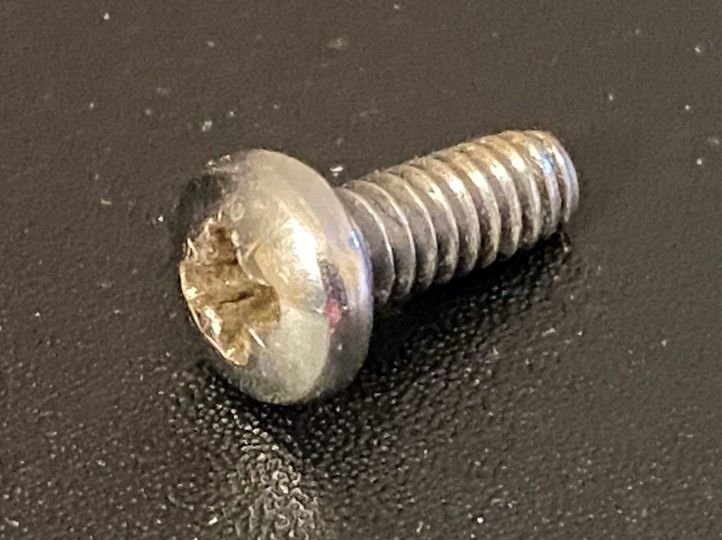

Finishing mucking with front seats again, cannot for the life of me find the screws (two with chrome heads?) which secure the seat rear chrome handles (as in picture) a single screw for each. Can anyone tell me the size, head type, thread and length I should be looking for? I have a million screws and cannot see the trees for the forest. broke phone camera so image is blah.

Smile Seat Handle attachment screw 10-24UNC X .5 Long
10-24UNC X.5 LONG, PAN HEAD, PHILLIPS DRIVE. Course thread being the important factor to note.

The screw in the photo is actually pozidrive, not phillps. The easy way to tell is the pozi has the little hash marks at 45 degrees to the slots, a phillips will not have those.
They do take different screwdrivers, a phillips is designed to slip out, a pozi is designed to grip.
You are correct! The screw thread and length is what I was really addressing to help him solve his issue. If you have a pozi drive screwdriver and screw handy, fair enough. The pozi drive was created to accept a phillips screwdriver also. Phillips are readily available at any hardware store in the US and fit in the counterbore shown as would a "sq drive", "hex drive" even slotted. Slippage may be a concern when tightening or loosening with the seat in the car but if it was out and I needed to get it done I find a phillips in me screw collection, put it in there and call it a day. Thanks for your input, it's truly appreciated.
