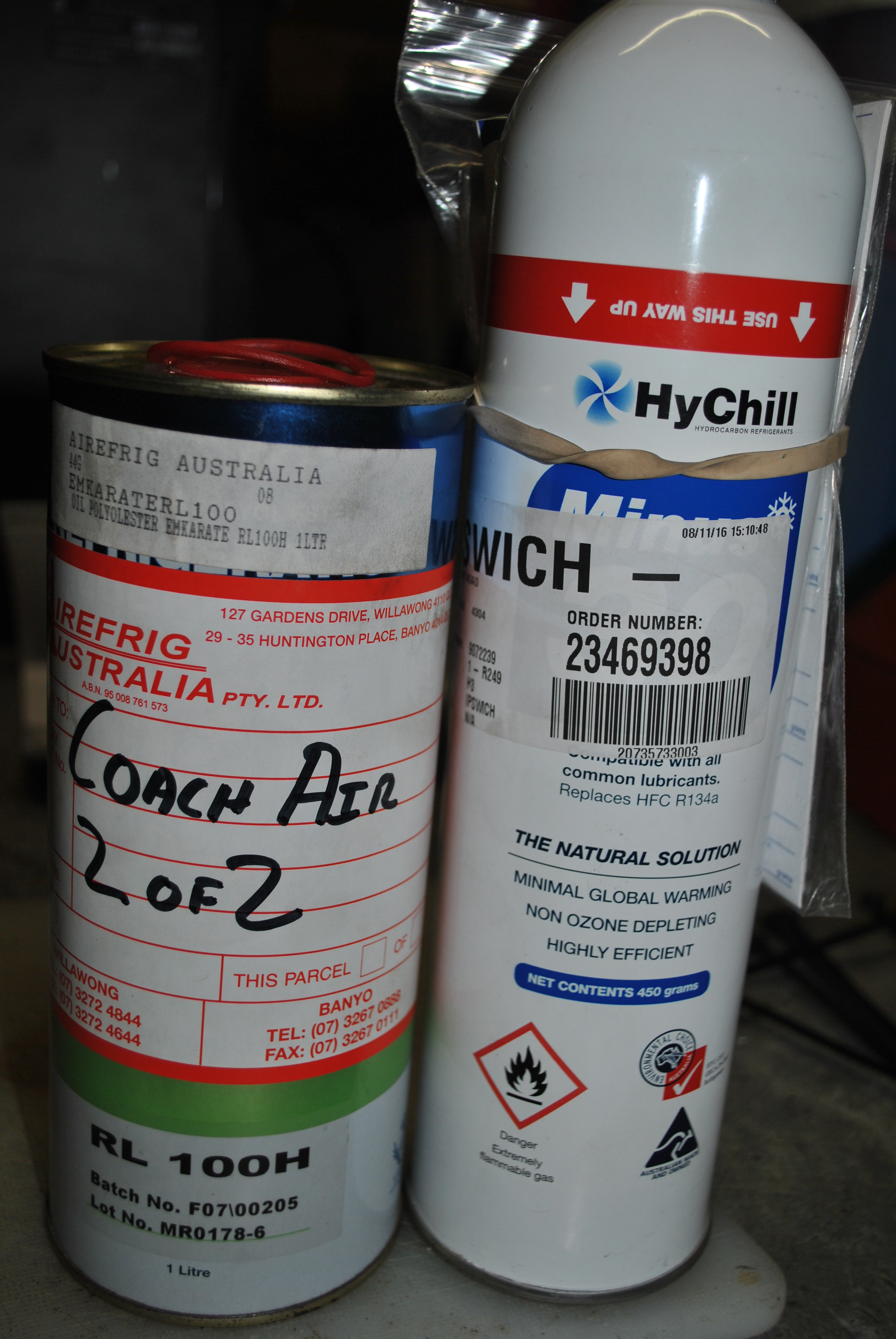

Picked up the Hichill gas and oil with die in it, o-rings and the gassing adapter yesterday. A can of gas (enough for one car) is less than $25.

Upon carefully reading one of the cans, Clarke, I see someone in Oz has come up with a better marketing strategy than the makers of RV refrigerants in Merca.
When the label plainly says, Hydrocarbon Refrigerant, that means PROPANE!! LOLOL

I have done a lot reading up on hydrocarbon refrigerants the last couple of weeks. They are mostly a 60/40 blend of propane/isobutane. From what I have read they are better suited to the R12 systems(which I have) than the R134a gas.
They are up to 50% more efficient and and put 20% less pressure/strain on your components, and use 30% less energy to cool the car. And it cools the cabin much faster.
For propane to ignite in an accident the conditions would have to be perfect to start a fire. The car carries 100 litres of petrol, I think that would be more of a problem than 200-250 grams of diluted propane venting the system.

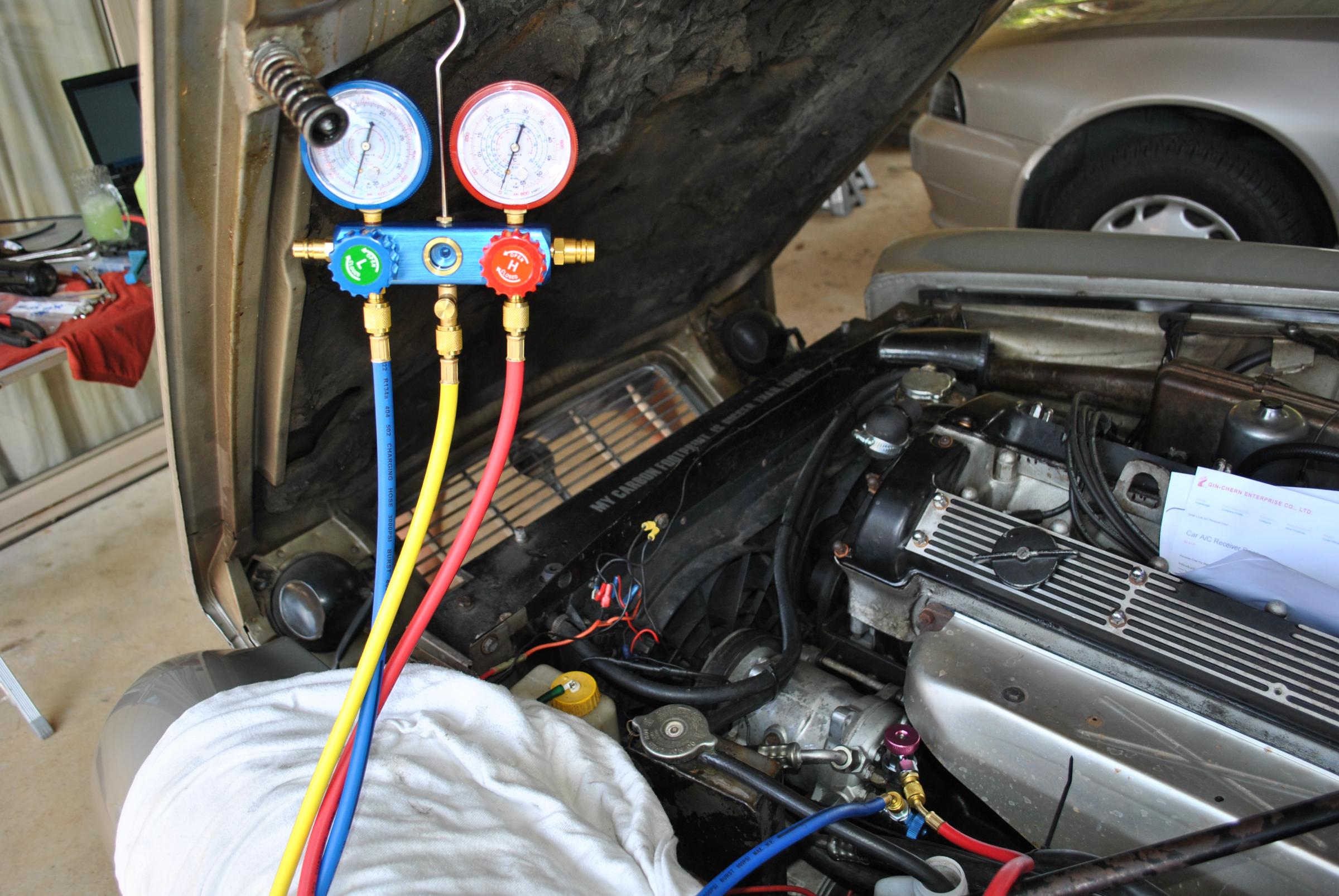

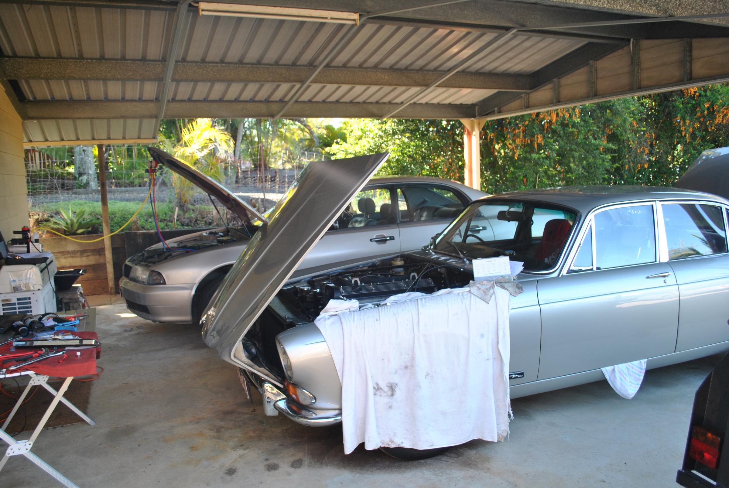

Assembled the system and re gassed today at 34by151's place. It took 300-350 grams of refrigerant.
Air con works a treat , I had to keep turning it down lower until I eventually turned it off on the 2 1/4 hour drive home through some awesome driving roads.
Huge thanks to Paul and James for the help.

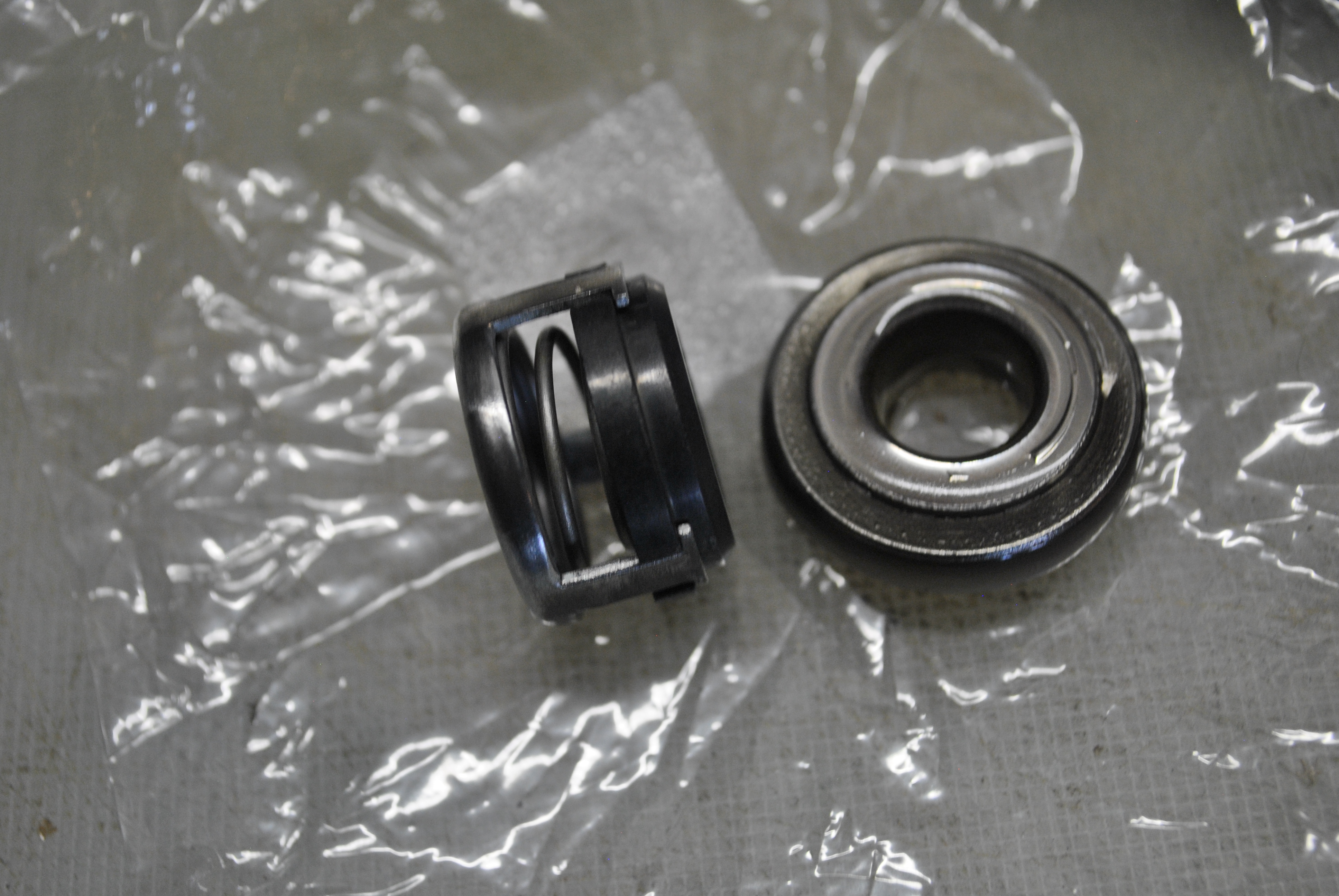

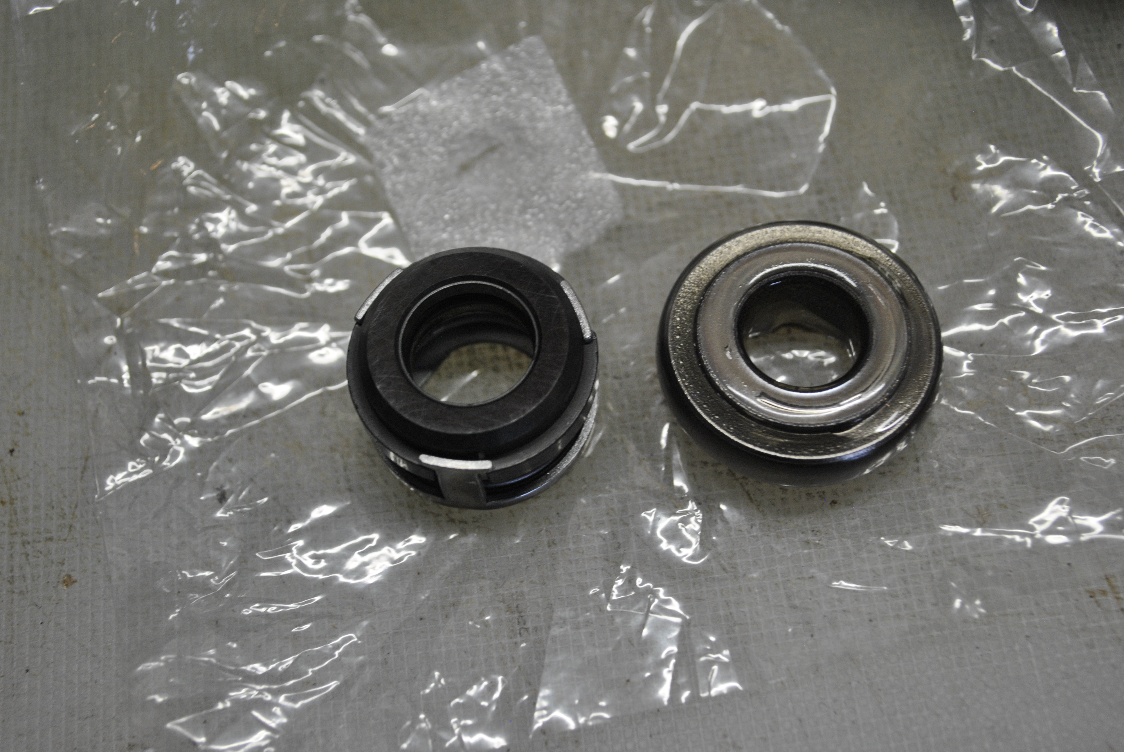

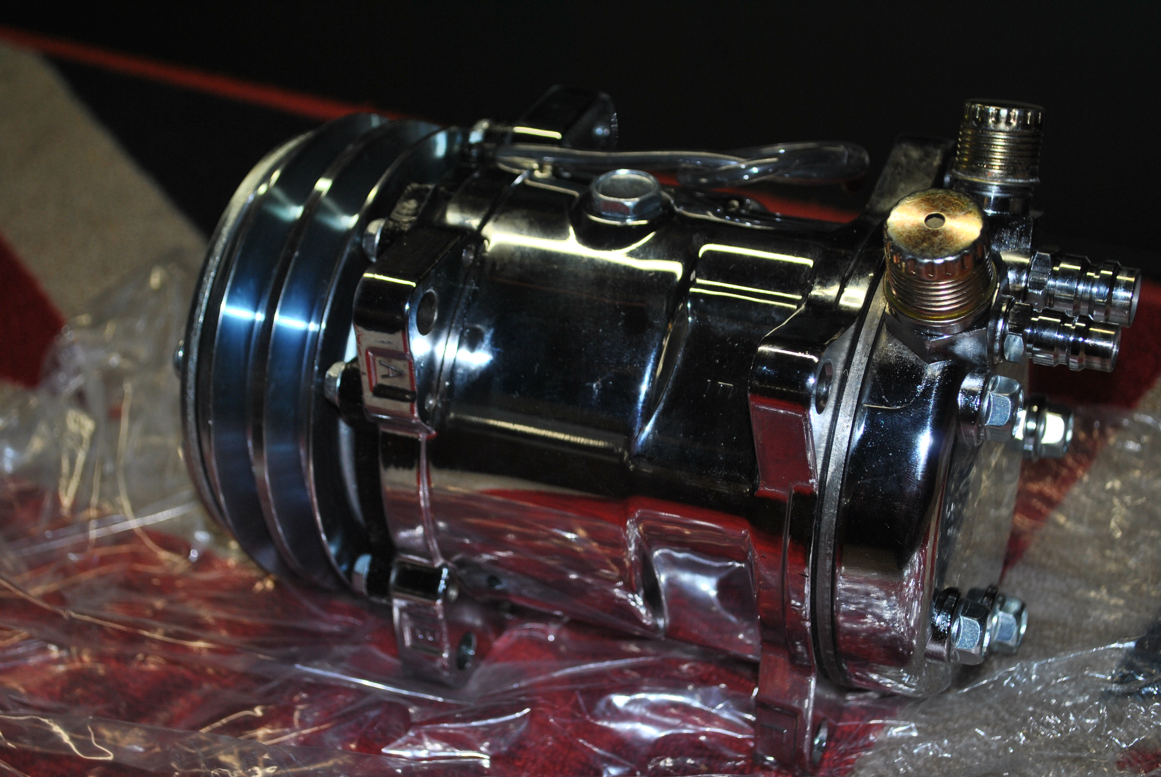

Last week my car was out on loan for a wedding when the aircon compessor failed while the Bride was being transported to the church on 36 degree day and humid as hell.
We decided to try and repair it, new o rings, had the mechanical seal reconditioned and replaced bearings and the oil. As soon as the system was pressurised with nitrogen to check for leaks it failed big time.
It was worth a try for under $100.
Series 1 Air con. Where to start. Or is best left to a professional? HOW TO-dsc_8663.jpgSeries 1 Air con. Where to start. Or is best left to a professional? HOW TO-dsc_8664.jpgSeries 1 Air con. Where to start. Or is best left to a professional? HOW TO-dsc_8665.jpgSeries 1 Air con. Where to start. Or is best left to a professional? HOW TO-dsc_8666.jpgSeries 1 Air con. Where to start. Or is best left to a professional? HOW TO-dsc_8667.jpgSeries 1 Air con. Where to start. Or is best left to a professional? HOW TO-dsc_8668.jpg
Ended up buying this one off ebay for $175, so still under $300 total is not bad for a compressor replacement. I will post some pics of it fitted when Dr Phill gets time in a couple of weeks.

Great price if its a decent compressor, less than half what I paid recently for a Sanden. Finally got something from this century installed :-) difference is fantastic, enjoy!

Delivered in 1 1/2 working days, ordered 2 pm Friday, arrived 8 am Tuesday. But has to sit on the bench for a couple of weeks while I get more pressing things sorted.
It was $179, not $175 as posted earlier = $204 delivered to the door.
