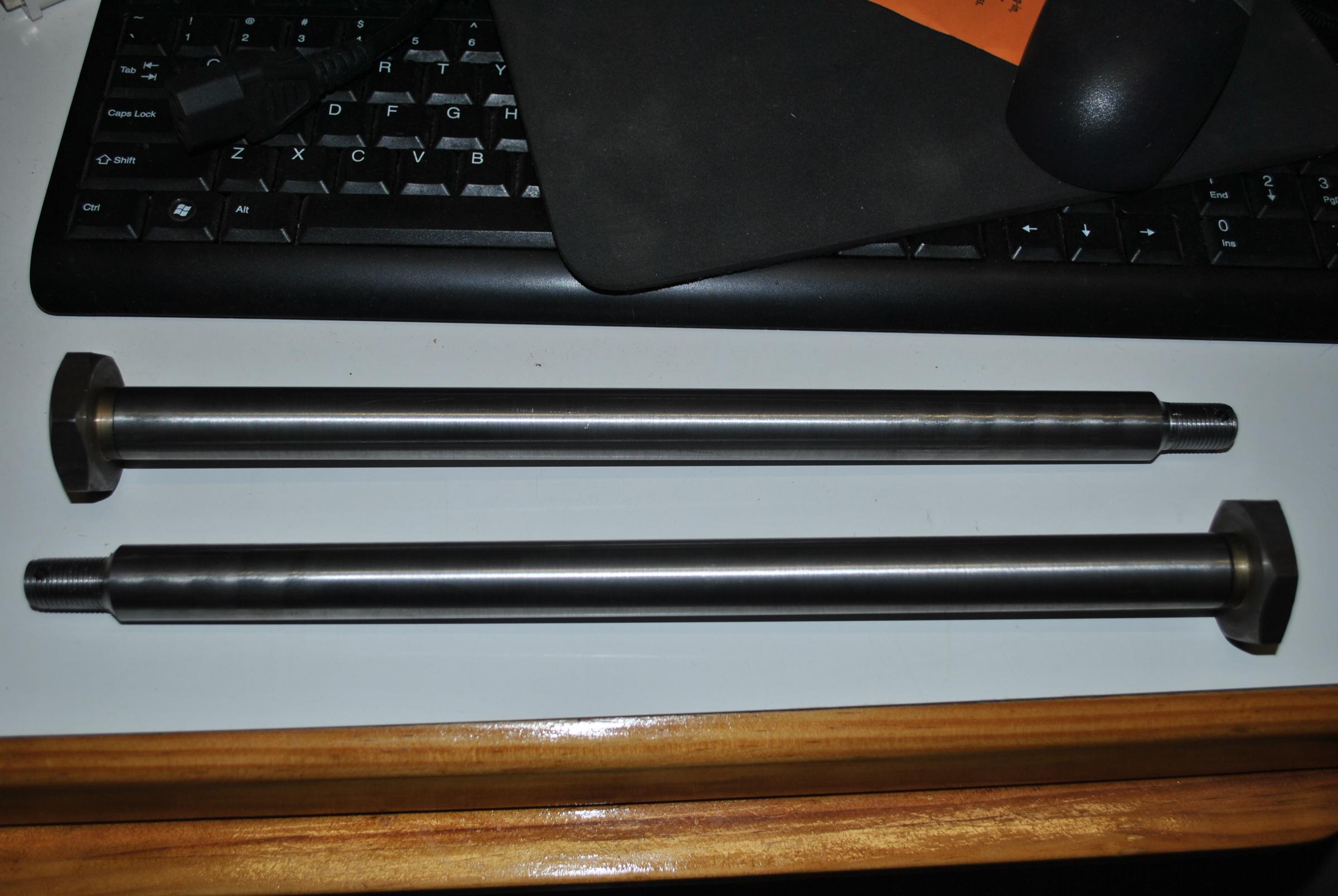

Originally Posted by o1xjr
The lower fulcrum shafts(wishbone pivot shaft) are still MIA
Wow, actually got my pivot shafts today. Nobody can shed light on where they were since they were despatched 20th January.
Have them now(this supplier is usually overnight every time).
They will have to wait for paint to be done before they go in now.
Series 1, front suspension rebuild.-dsc_1380.jpgSeries 1, front suspension rebuild.-dsc_1381.jpgSeries 1, front suspension rebuild.-dsc_1382.jpg

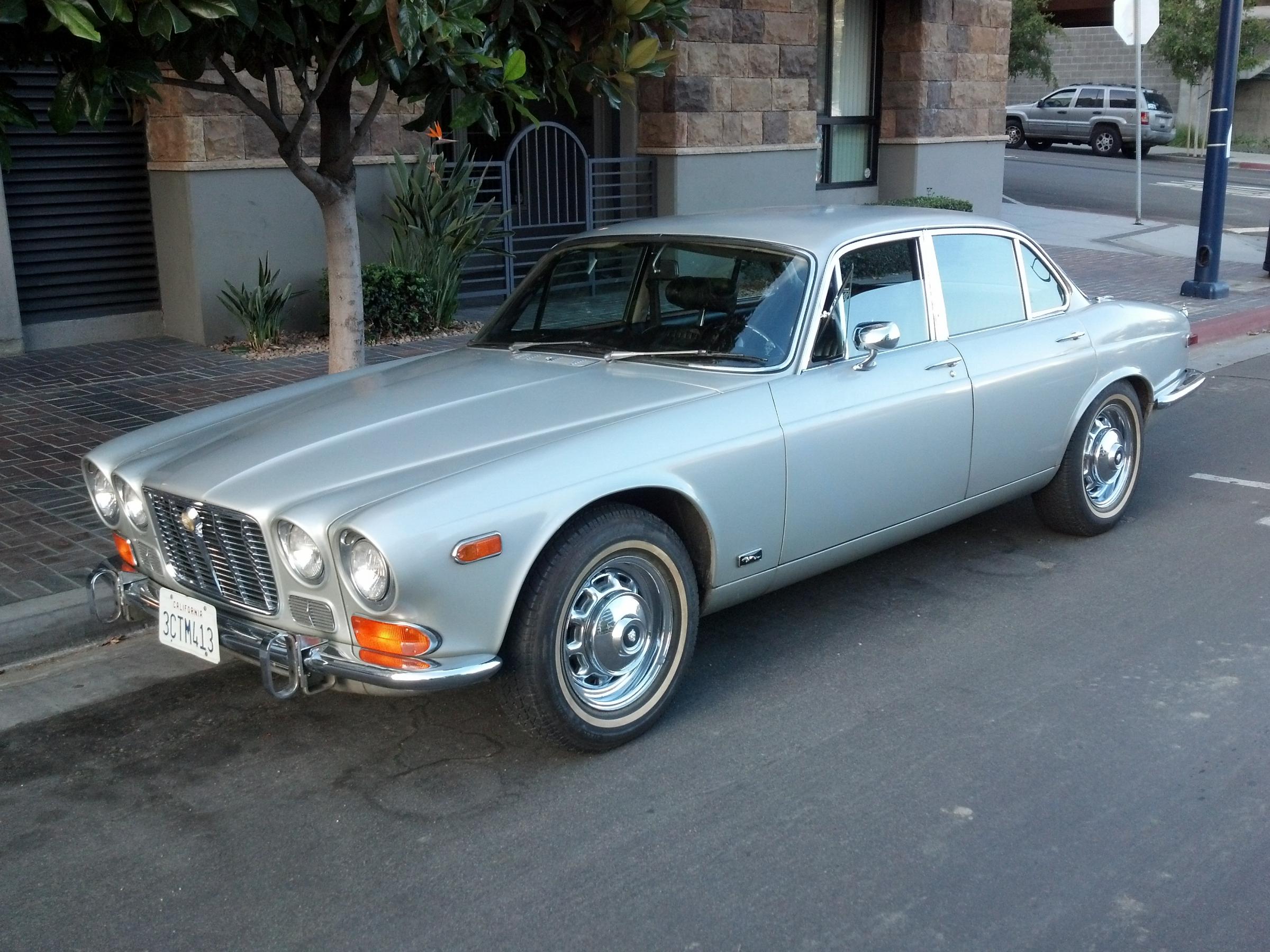

Since we have the same car I thought I would share a pic of my pops silver 1973 XJ6 S1 I was reading your posts and kept thinking "I can't believe he is not replacing the steering rack bushings!", but finally you said it was already done. I did a lot of refresh work under this car too.
Attached Thumbnails Series 1, front suspension rebuild.-img_20130727_182130_091.jpg
Nice pic of your pops car.

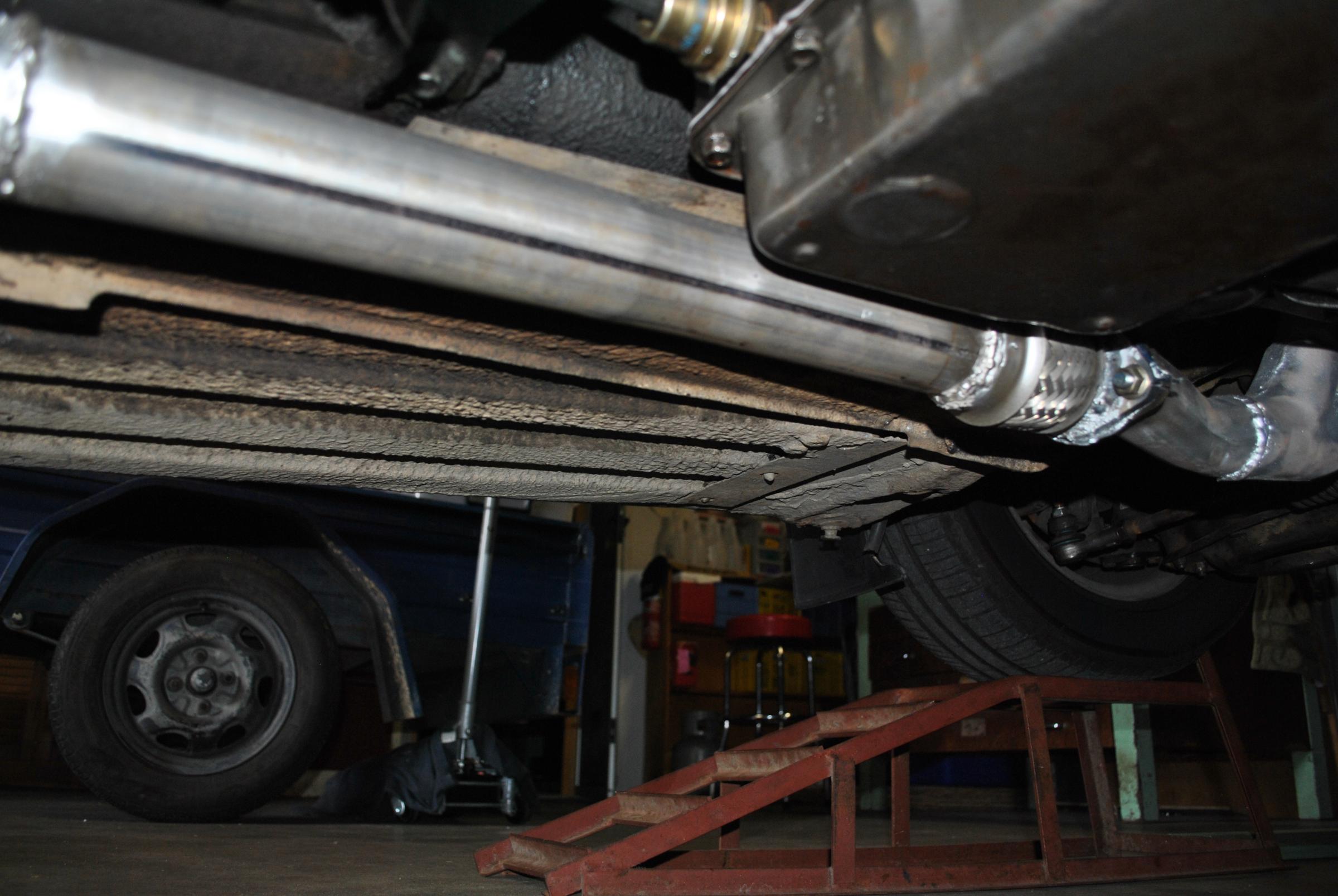

Got it sorted today, at the cost of a little labour and parting with some amber happy juice.
Cut and tucked the old exhaust system today and added some new bends. It now is 2 1/2 " rather than 2" and the 3 bolt Jaguar flange is gone and replaced with a 2 bolt Falcon flange and the pipe goes up from the bottom of the maniflold pipe so it now sits higher than the Transmission pan. Gives me about 15mm more clearance, along with the original size tyres fitted to the rear(another 14mm of sidewall height) I think I finally got to where I need to be.
I can exit the garage with no scrapes.
Series 1, front suspension rebuild.-dsc_9341.jpgSeries 1, front suspension rebuild.-dsc_1604.jpgSeries 1, front suspension rebuild.-dsc_1606.jpgSeries 1, front suspension rebuild.-dsc_1610.jpgSeries 1, front suspension rebuild.-fg-cr09573.png

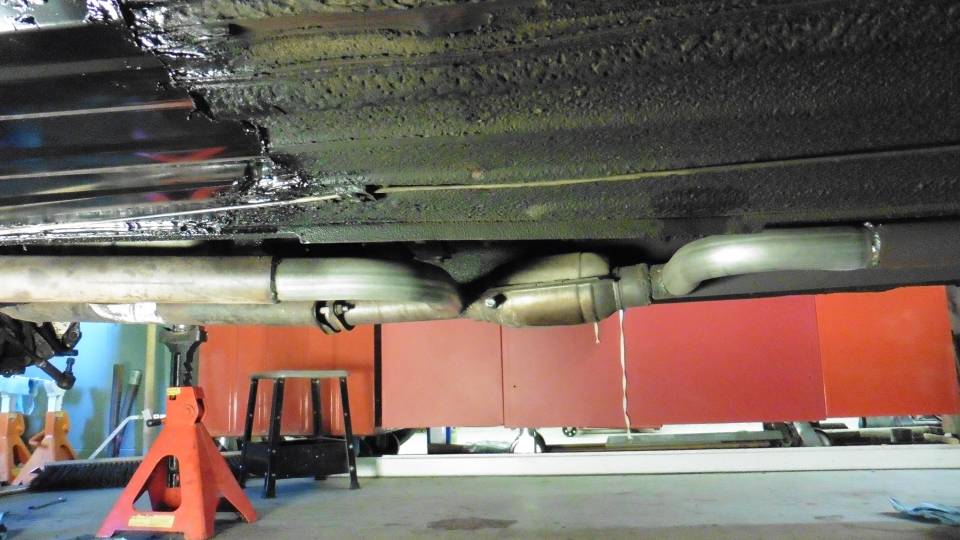

When I got my car, the PO frankly warned me not to try going over speed bumps because the CAT was hanging so low, because of the rush exhaust job to get it past the visual emissions inspection so he could get our money.
Below is the result. Fixing this keeps getting shoved to the back of the line by other critically important matters that keep elbowing their way to the front of that line.

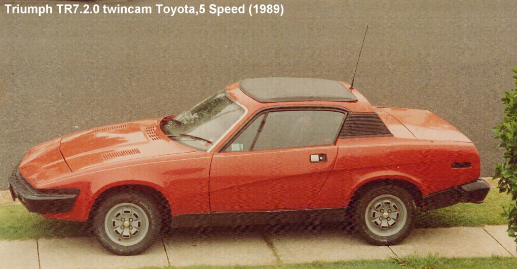

Considering entering the "Track Challenge" at next months JF meet at the Euro/British day at Lakeside International Raceway. Will be up against old and new exotic hardware(you know the ones they test on top gear). I know I will be slowest by a country mile, but I bet I will be the fastest S1 Jag, and second fastet Jag after 34by151's XJR unless one of the XKR or F-type guys make an apperance.
Hanging out to don a helmet at lakeside again after racing there 20 years ago.
Some pics of my old Lakeside days.
Series 1, front suspension rebuild.-tr7-1.jpgSeries 1, front suspension rebuild.-hardtop.jpgSeries 1, front suspension rebuild.-et-1990.jpgSeries 1, front suspension rebuild.-80cc-supercart-lakeside-1991.jpg
