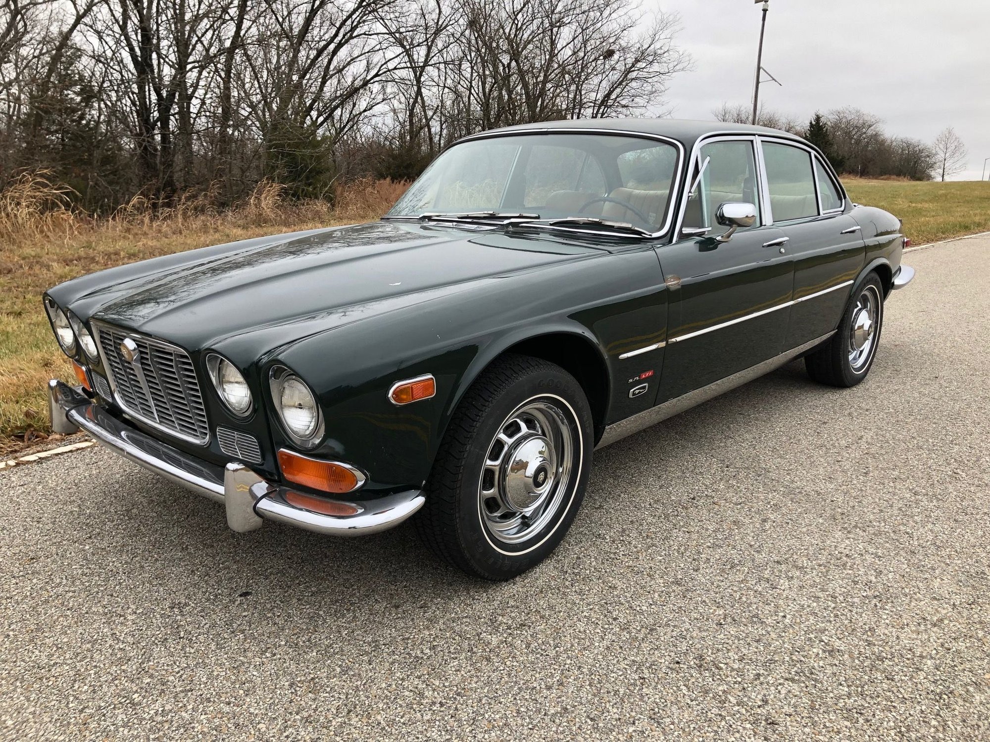

Old May 4, 2020 | 01:45 PM
bgs522's Avatar
Posts: 40
From: Kansas
Old May 4, 2020 | 02:07 PM
JagCad's Avatar
Posts: 6,796
Likes: 2,403
Very nice car and tidy, til the boot picture.
1. Measure the spare well. google fuel cells and find a vendor with pictures and dimensions.
2. Get a pair of original Jaguar side saddle tanks. New or used. depedant on budget, of course.
Try David Boger at everydayxj for good used or possibly NOS. Good guy. posts ere from time to time.
His necrophy of a car was very informative.
It is an L98, for ure. Nce installation.
T5 a definite possibility...
.Carl
