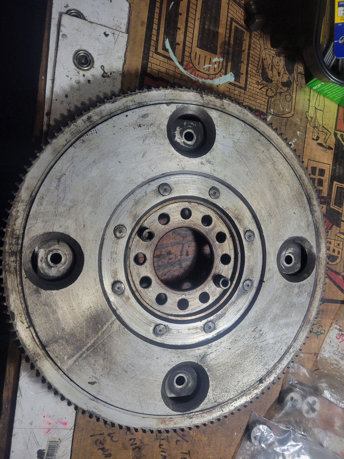

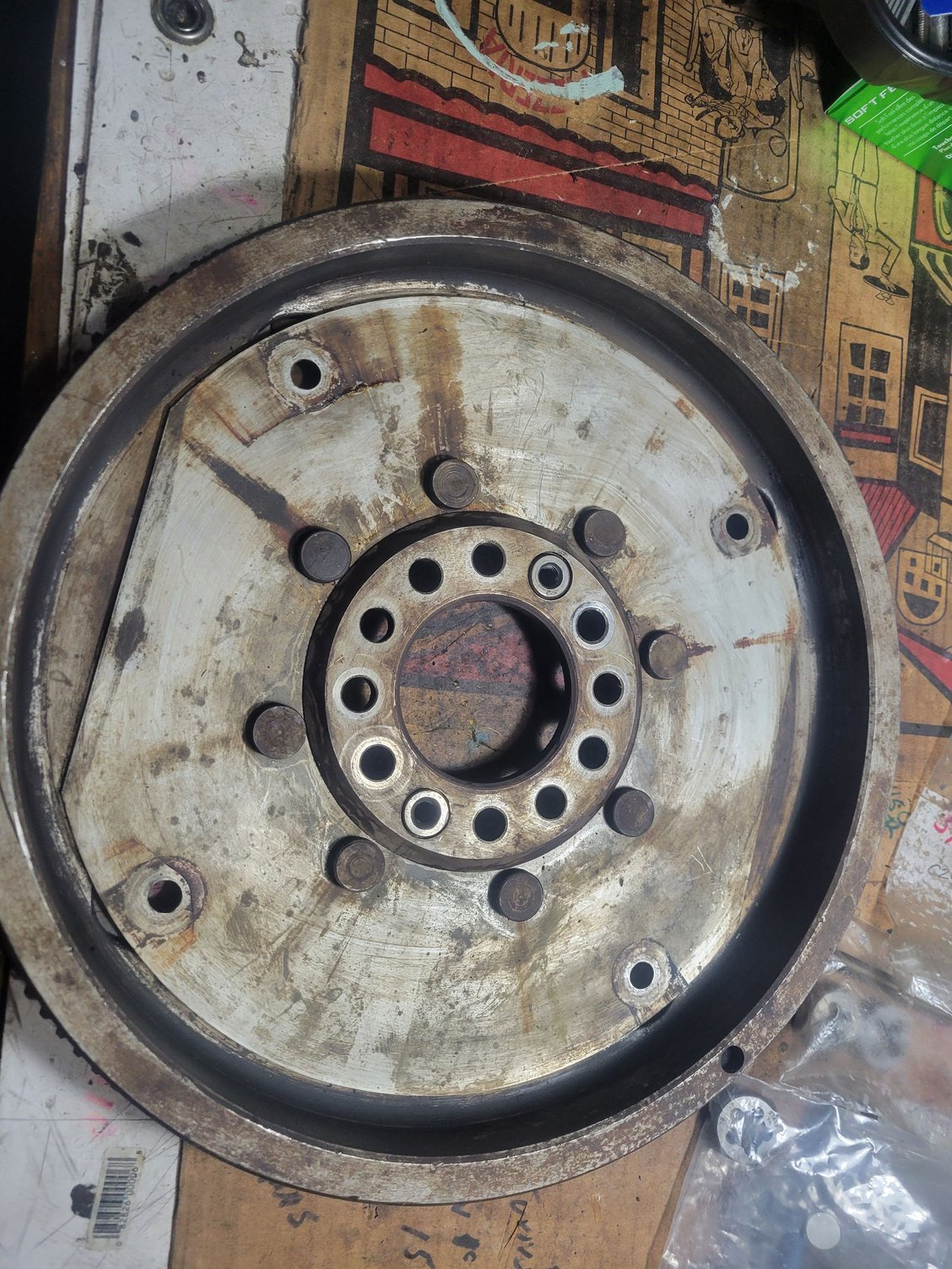

I see the differences between the two Drive Plates. The earlier one seems to be beefier and has the rivets holding the flex plate in place (that seem to loosen over time). The later "solid" one doesn't seem to have the rivets, nor the "flex plate". I also understand they are interchangeable. And as I am installing a rebuilt BW 66 back on my XJ6C with a rebuilt Torque Converter, I want to do what's best for the long term. In the absence of being able to acquire a solid Drive Plate, instead of trying to pean over the rivet backs, can I just drill them out and dispense with the "flex plate" part. Because it seems that's what has been done with the solid plate. Anyone done this?
Also, is the solid plate lighter than the earlier beefier one? And how might that affect my smoothness at idle if I was able to switch over?

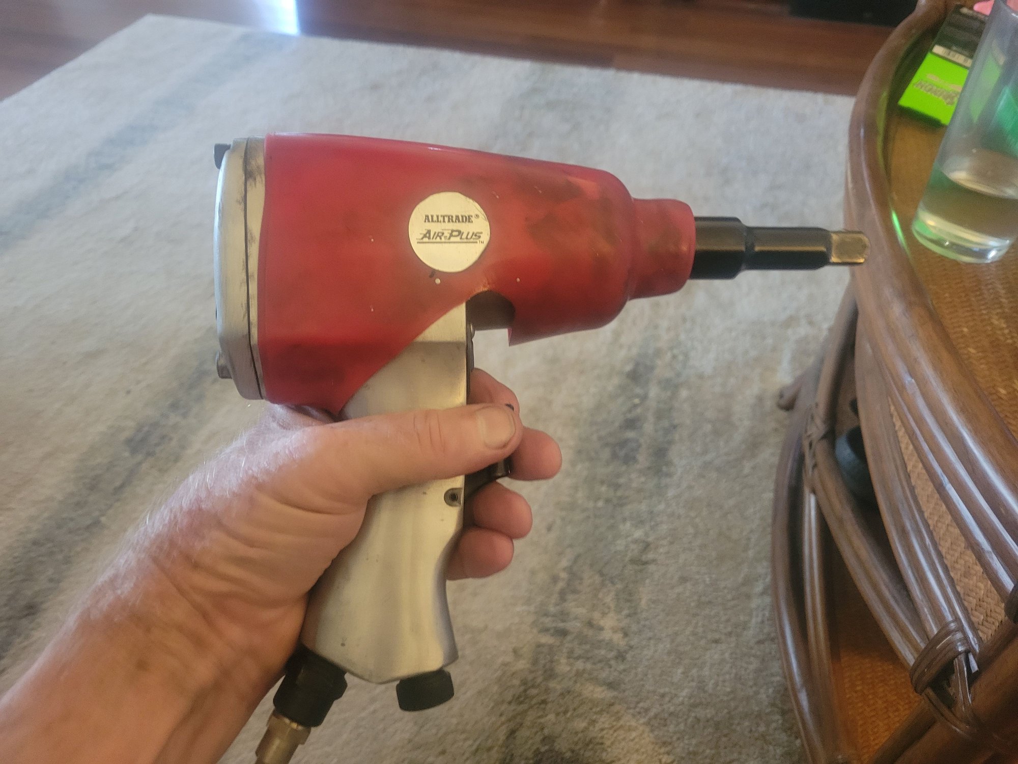

Well... my latest stumbling block is even with my Impact Wrench set on max and my compressor at max 125lbs, I can't get the ten 3/4" bolts holding the Drive Plate to the crankshaft. And I can't figure out how to hold the Drive Plate secure without turning, to try it with a big *** torque wrench or bar. MAJOR PROBLEM!

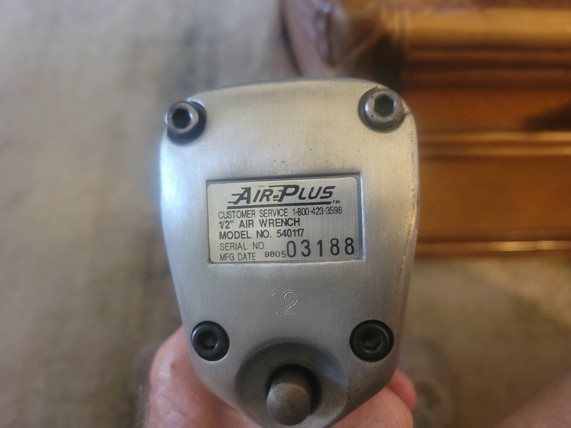

What impact wrenches are you using?

To your point, I'll bet my Impact Wrench is only 900lbs torque.

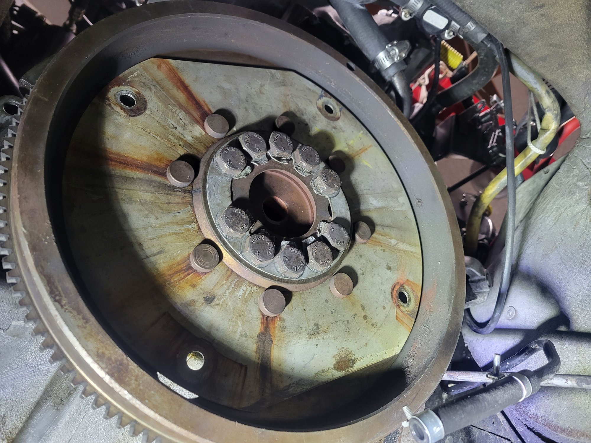

Disassembly has finally come to close. I was able to borrow an impact wrench that removed the 10 bolts off the drive plate, and removed the plate from the crankshaft. Did NOT find any of the rivets loose at all, so in a quandary as to the wisdom of changing over to a solid drive plate. It cleaned up just fine. See pics below.
