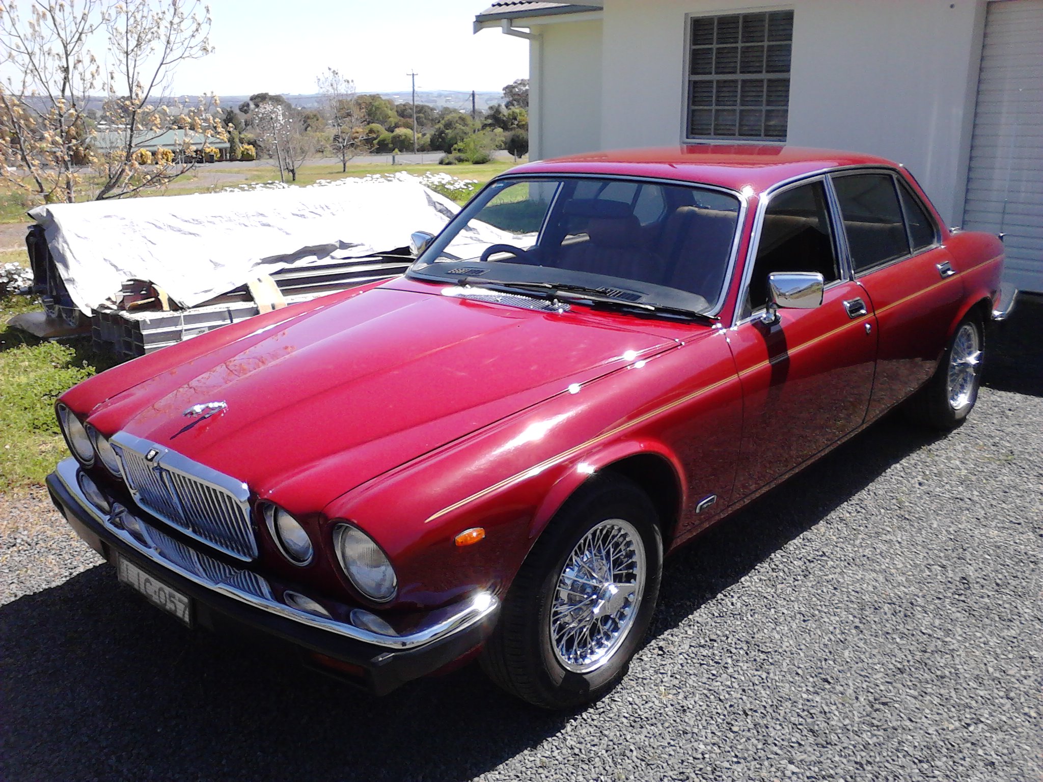

Nice work Brandon. Like you, I have a really nice SeriesIII . . . mine is red and a 4.2L MY79. Only an unreliable aircon and u/s power antenna yet to be attended to. More pics in my albums. Yell if I can assist but, compared to others here, the SeriesIII is still a learning exercise for me also. Plenty of good heads here with vast experience, so best wishes for your project.
Cheers,
Ken
