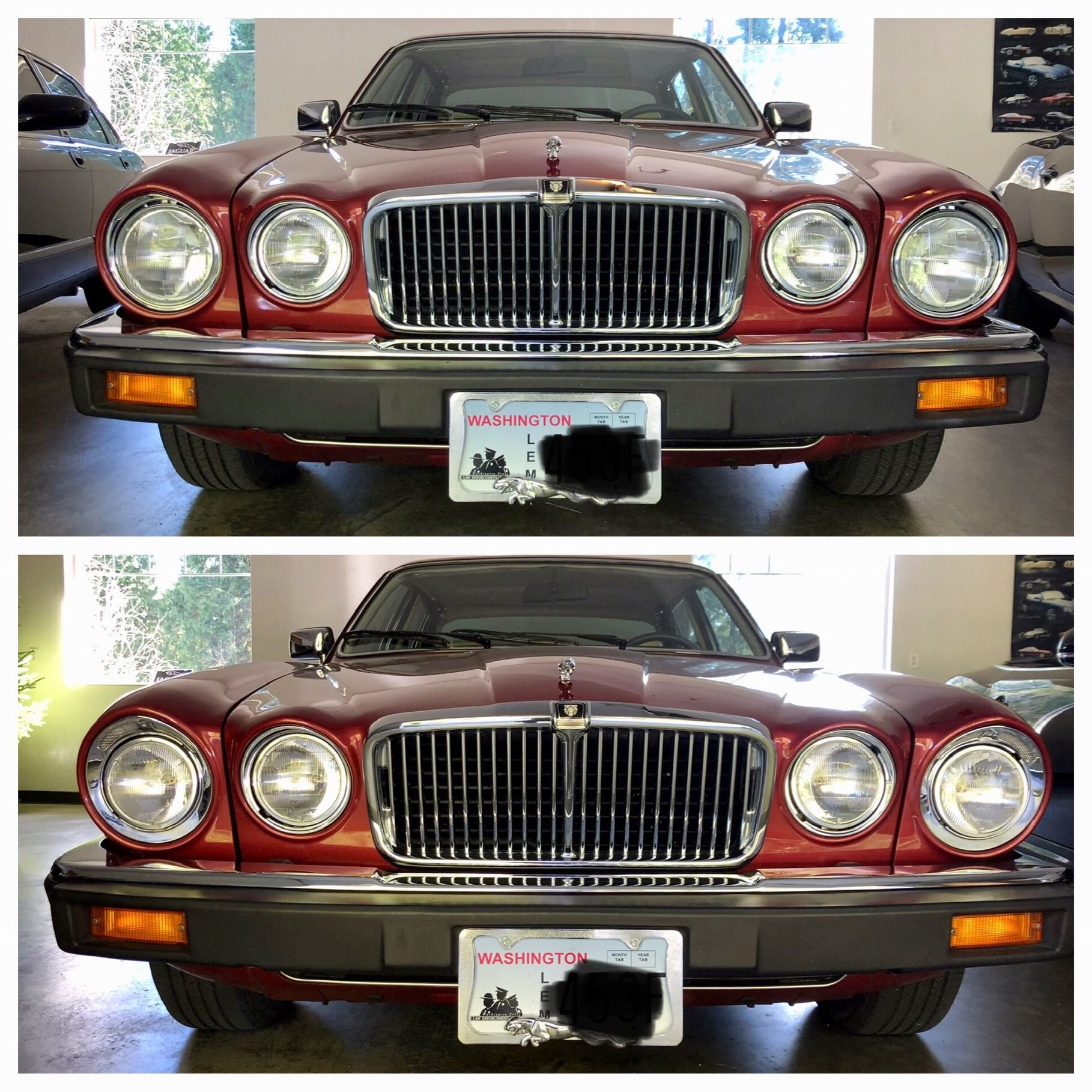

I put new halogen sealed beams in my ‘87 and it made a big difference. Then I upgraded my 5” halogen outer headlights to 7” halogen sealed beams and it made an even bigger difference! I think I have plenty of light now. Plus, I love the look of the 7” headlights vs. the 5”. The car now looks the way it was designed.
