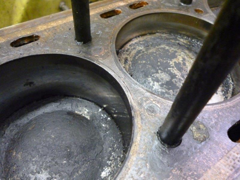

Here's a pic of the coolant passages revealed when the cylinder liners are removed. See if you can see the crack ! The bore to the right still has its liner in. I don't have a pic of the later vertical slotted block; does anybody ?
Wow - that looks like a bad idea! I can't quite see the crack but it's reaaallly easy to see the cracks in my block....
I assume the top hat liners' overbore protrudes down beyond those slots.
Can the cylinder bore be oversized to increase displacement beyond 4.2?

I should, of course, have mentioned that the later slotted blocks have a wider bridge between the bores as the two liner thicknesses are incorporated into the block, but the slot means there is still not much metal between bore and coolant passage. It is, however, a lot better for the head gasket which lasts a lot longer on these later blocks.
Addendum
Sorry, missed your last post ! The lipped liners are designed to just touch each other or at least be very close, thus covering the crack and giving the gasket fire ring some thing to bite on. I also forgot to say that once the crack appears the bridge strength of the metal between the bores is lost, so it usually sinks a bit thus taking the clamping pressure off the head gasket so failures will occur on a new one after a few thousand miles. How do I know ? Don't ask !!
