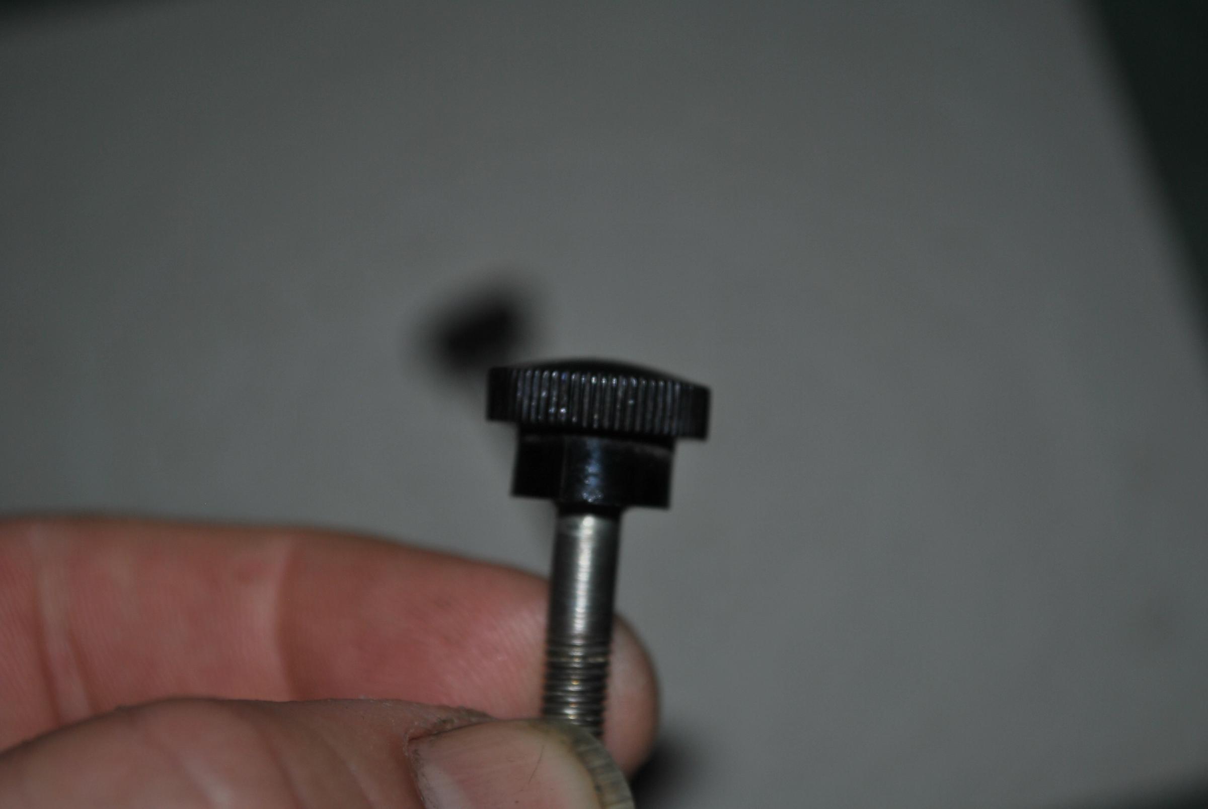

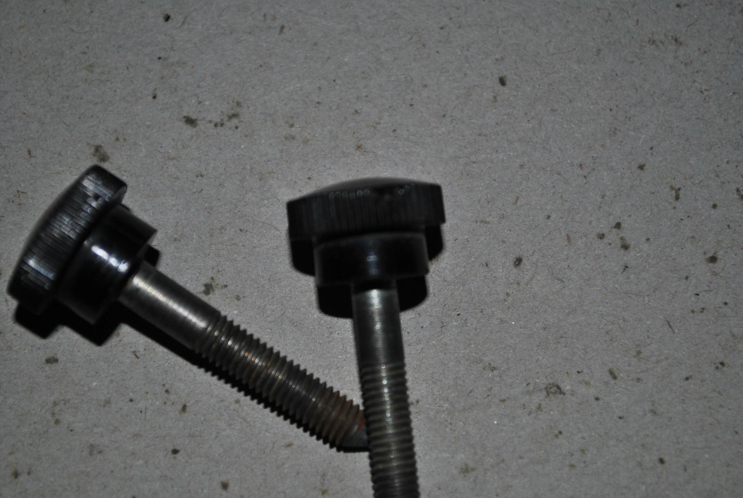

If you have a look at my picture in #2 of this thread you will see the two plastic knobs pointed to with red arrows. Those plastic knobs are molded onto the knurled part of the screws in your picture
Update, here is what they should look like. Try David at everyday XJ, he should be able to sort out a pair for you.(he is a member of the forums.)

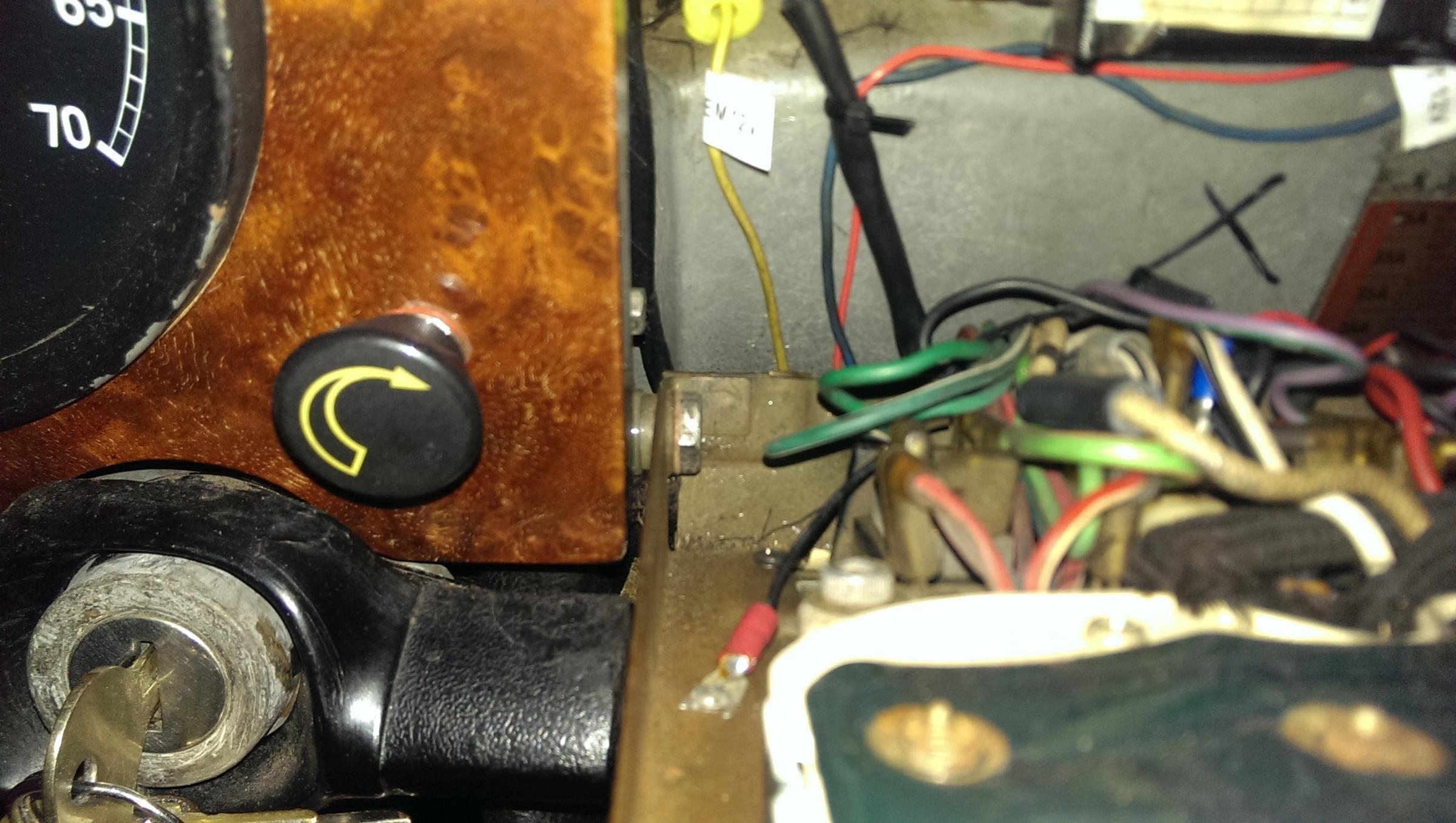

This is what the LH pivot point looks like...on the inside.
Knob above the ignition switch is the Hella intermittent wiper switch.

Roger, it looks like the key is on the wrong side. My 47' chev that was factory RHD still had the key and most of the controls on the left side of the dash. At least Jaguar put things on whichever side the driver is on.
Going by your pic I have all I need between my two switch panels to make everything work properly.
