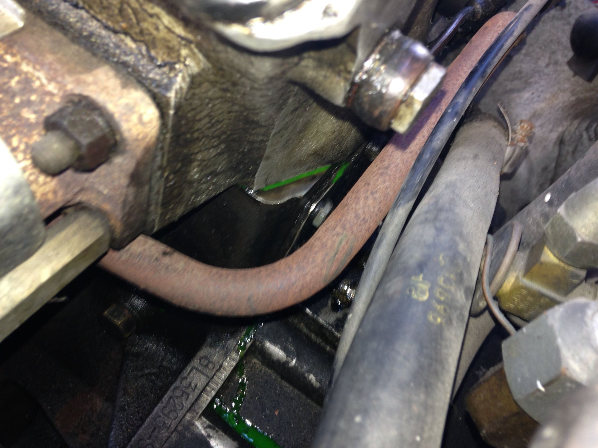

Old May 12, 2017 | 11:45 PM
Calvey's Avatar
Joined: Feb 2017
Posts: 24
From: Christchurch, New Zealand
So Ive had a better look today, when I started it the leak was clearly visible again but after a drive and when she was fully warm it appeared to have stopped. I took a photo.
Old May 13, 2017 | 03:25 AM
Posts: 28,811
Likes: 11,280
Looks head gasket related to me, bugga.
If its stopped (taken up) you may be lucky, but that is a rarity in the real world.
There are sealants out there claiming to stop that weeping. I have not used them, so no comment from me. Bars Leaks is a NO NO for sure.
We sell a lot of a product called Seal Up at work for head gasket coolant weeping, and the reports are it works. Copper based liquid stuff.

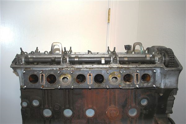

Originally Posted by new mexico
The first thing I recommend is to take it to a car wash and steam clean the
entire engine and let it dry, then check for any leaks.
Cover the distributor.
Walter
I agree with Walter. And if after it dries and you see some staining as shown in the photo of my long discarded block, could mean a new head gasket is in order..
