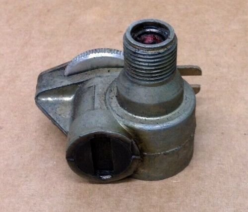

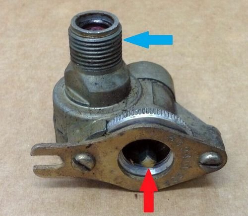

This is the Speedometer Drive for an XJ6 Series 1:
The square peg (arrowed in red) engages with the gearbox output. it locks in position with the fork and is tightened with the knurled wheel. A flexible cable goes from the threaded section arrowed in blue to the speedometer.
I don't have my XJ6 Parts Catalogue any longer but recall this angle drive was available in a number of different options to suit the final drive ratios. I only remember because I had one fail on my 1972 XJ6.
