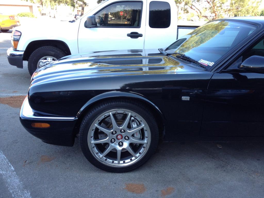

My most important thing as far as cosmetic goes is finding wheels that look good on it. I was thinking the wheels from a XJR would look very nice but I'd have to use some photoshopping before I pulled the trigger.

Offset is 33mm that we are looking for with a bolt pattern of 5 on 120mm which is right on for the Jag (5 on 4 3/4", or 120.6mm)
Try the fit before buying!

[QUOTE=Kyle206;722154]I'm sure this is a simple question but I saw XJR today with these BBS's and I'm wondering which model BBS's they are. Also will wheels that fit the XJR for my series III xj6?
See the rims here 1/2way down, I doubt they will fit the series 3 without spacers it's the front hub that is the issue
