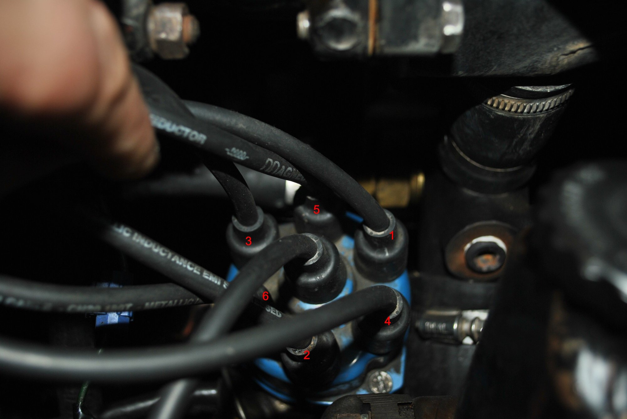

Originally Posted by frankcandor
Hi Everyone,
I am in Alberta Canada. I am trying to get my Mom's 78 xj6 Jag going.
It has a 4.2L inline six. I am having a hard time figuring out the firing order. in all the diagrams it says "front" but I am not sure. any advice would be helpful.
1-5-3-6-2-4.
Number 1 cylinder being at the rear of the engine, number six at the front nearest the radiator.
Pic below of series 3 engine(1983), numbers 1 & 4 facing radiator.
