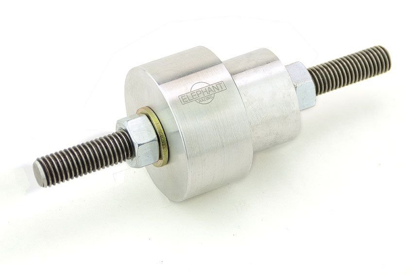

I used to do this repair a few decades ago with a special tool.
A 'cup&piston' type tool with a threaded rod to remove and replace the bushings.
Something like this.

Moss sells the tool but at $70 - ouch. I bought one a few years back when they were closer to $40 and still felt I over paid. Use a couple sockets and a piece of threaded rod.

You can also us a deep well socket with some all thread rode, washers and nuts to get the press in originals out I would recommend using the Urethane replacement bushings They do not have to be pressed in and should never wear out. My 2 cents worth.
