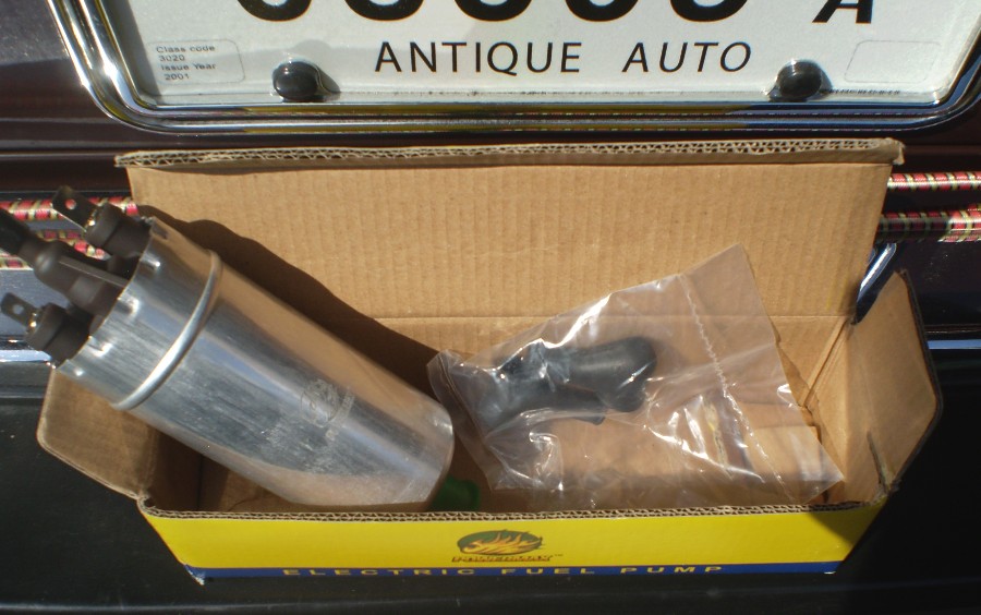

look what I got in the mail from UK today
replacement for Lucas 4FP fuel pump, the original was starting to sing the blues, the whinning became annoying. Why do they start whinning and humming?
looks identical to the old Lucas pump, first time I have to replace it since I bought the car, can't complain, I'll let you know if it works.

well darn it, I just installed the new pump, started the engine and it is making a horrible and intermittent noise, as if the insides were rubbing against something.
what could it be?
