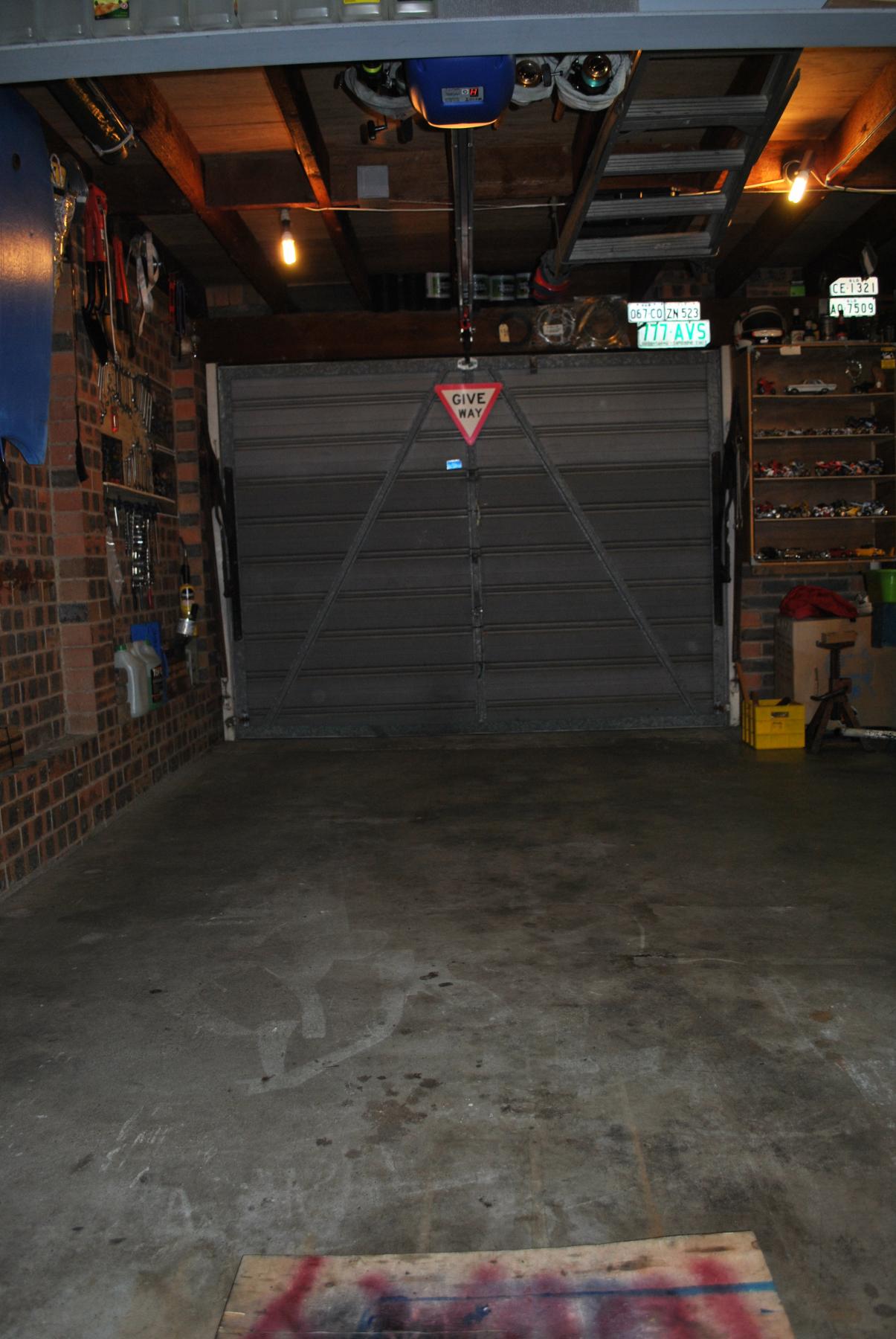

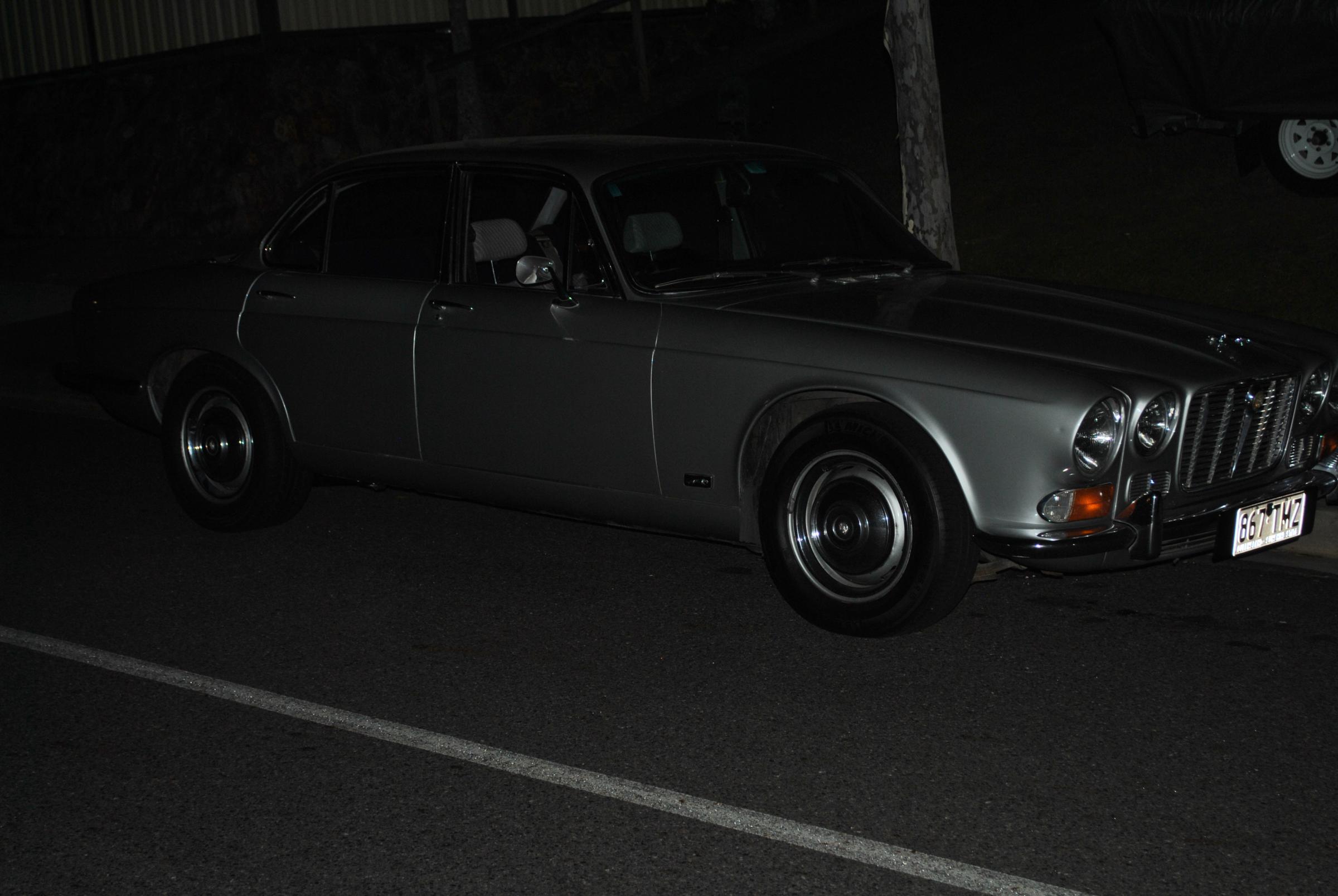

8pm, just fitted handbrake calipers and drove around the block.
Off to get the work checked over by mechanic tomorrow morning,and mufflers and tail pipes fitted up. Maybe I can do the easter road trip we planned now.
One month almost to the day(29 days), spent 138 hours on it. Lucky I only work a 3 day week.
Attached Thumbnails Sunday drive ends with 000, I'm on fire.-dsc_9311.jpg   Sunday drive ends with 000, I'm on fire.-dsc_9309.jpg

Done.

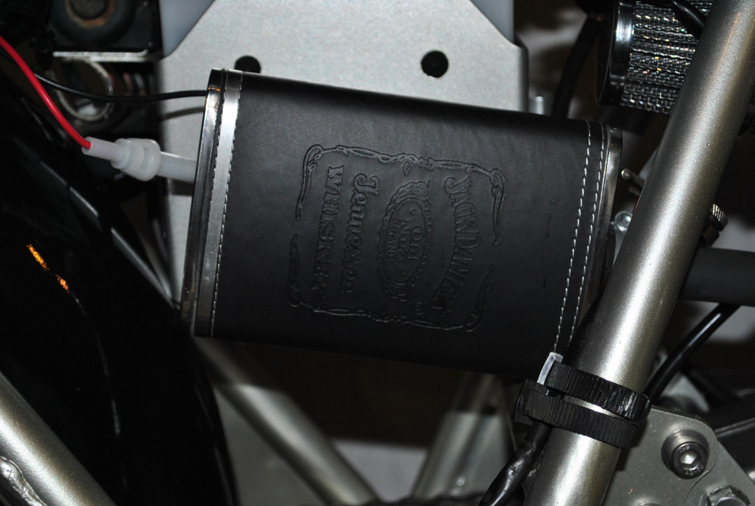

Thanks Grant, sitting back having a celebratory JD right now. Once I start a job I can't leave any part untouched,Every nut and bolt came off. Now I have done the IRS the rest of the car is lacking something. Never rebuilt a diff before, that was interesting on a garage floor with the wrong tools.
The only part that left my garage was taking diff parts across the road to my retired mechanic nieghbours press to remove bearings.
You will appreciate the JD hipflask in the attached pic(used as oil breather catch tank)
I only registered this car for 6 months when I got it in December,not knowing if we were going to keep it or if it was a whim attack,it has slithered its way into fleet long term now. I even had to let one of the bikes go to accomodate the budget.
Guess I knew all along since I have wanted a series 1 since I was in primary school.
Attached Thumbnails Sunday drive ends with 000, I'm on fire.-dsc_6281.jpg   Sunday drive ends with 000, I'm on fire.-dsc_6277.jpg

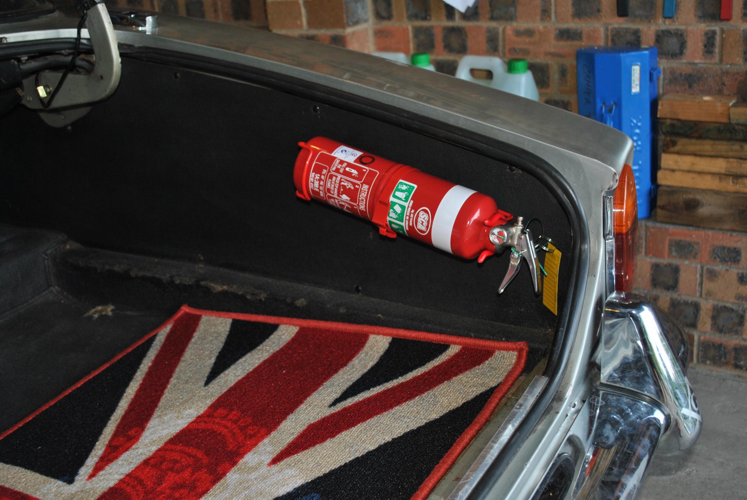

Covered about 150 miles today and all went well,still that uncertainty in the back of your mind that it might ignite again. Put it up on stands again when I got home to have a quick look, all good and nothing burned.
So I finally got to put on the fuel shut off tap I was going to fit a month ago,so I can reverse park on my drive without the fuel gravity feeding down to the carbs and running out onto the drive,if only I had a handbrake cable!
Attached Thumbnails Sunday drive ends with 000, I'm on fire.-dsc_9314.jpg   Sunday drive ends with 000, I'm on fire.-dsc_9317.jpg   Sunday drive ends with 000, I'm on fire.-dsc_9318.jpg   Sunday drive ends with 000, I'm on fire.-dsc_9319.jpg
