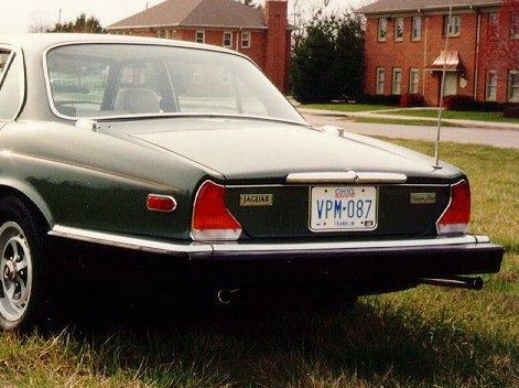

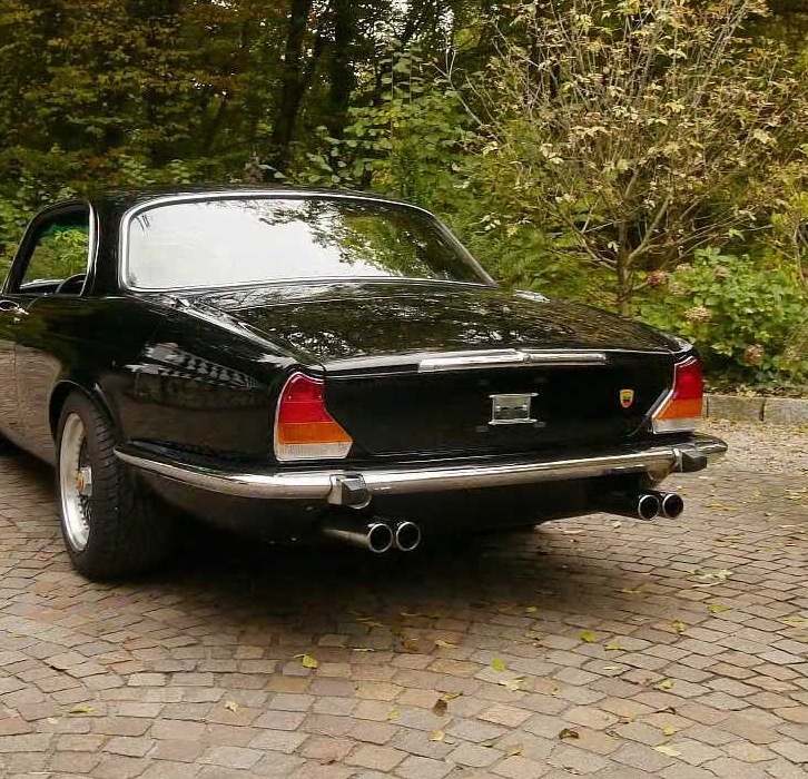

+3 here
Attached Thumbnails Taillights for XJ6.-img_2807.jpg   Taillights for XJ6.-img_2806.jpg

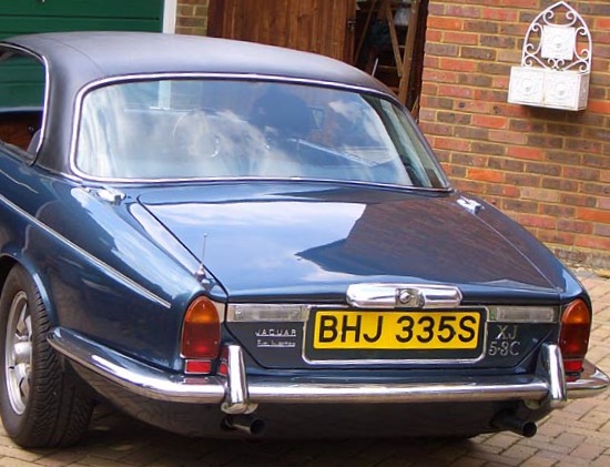

Something like this....
Old Jun 26, 2017 | 07:51 PM
Robert Wilkinson's Avatar
Joined: Feb 2016
Posts: 70
Likes: 36
From: Saint Louis, MO
Yes, although I think without the black rubber. Looks like that coupe' also has the S3 boot lid plinth, which is not easy to fit on earlier cars. Know any more about the overriders?
Old Jun 26, 2017 | 07:59 PM
Daf11e's Avatar
Posts: 46,008
Likes: 4,715
Unfortunately not Robert I just found the pic on the net with no other info available......does look good though.
Old Jun 26, 2017 | 08:12 PM
jagent's Avatar
Joined: Nov 2011
Posts: 1,535
Likes: 438
From: Melbourne, Australia
Those "bullet" style overriders look like the standard overriders fitted to the Euro/ROW front bumper on Series 2. I'd say that's what they are.
