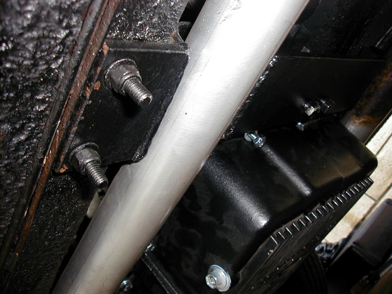

Attached Thumbnails To those who have done a chevy conversion.-side-covers-redirect-air.jpg   To those who have done a chevy conversion.-camara-firebird-radiator-setup-gm-rubber-isolators-bottom.jpg   To those who have done a chevy conversion.-ac-condenser-drier-trans-cooler-before-hood-.jpg

1. The motor mounts are pure DIY. A somewhat clever method of joining the Jaguar and the GM units. Just might be a tad tall, and hence the restriction between the carb and bonnet. What was the sump/engine pan to front cross member clearance? that is where the "rub" comes in. But, it's done so, play the mount cards you are dealt.

Having had four types of engine mounts in Jags, Suncoast is the best made and located... my '71 handles real well with the lower engine position and rearward CQ. Old mounts were by Mundorf and they had the engine too far forward and upward. Moved it back 1 1/4 inches and that made a tremendous difference. I do like the JTR trans mount that gives room around the trans end and eliminates the big Jag mount entirely. Note in the photo all the room and even the large extra large trans pan for cooling in my old '74 383/700R car... my neighbor and I added the "U" shaped hoops to the mount for exhaust pipe clearance. All that undercoating was hiding the floor pans with large holes and tin covers under the carpets... buyers beware!

Also, I'm replacing the sub frame mounts and I've run into an issue. The mounts have that center insert and it's rusted to the old mounts. Getting it out isn't my issue, I already did, just cut them out, but, how do I keep them from rusting again? Some rustolium maybe? Or some kind of grease coating?
Attached Thumbnails To those who have done a chevy conversion.-img_20150127_181706.jpg
