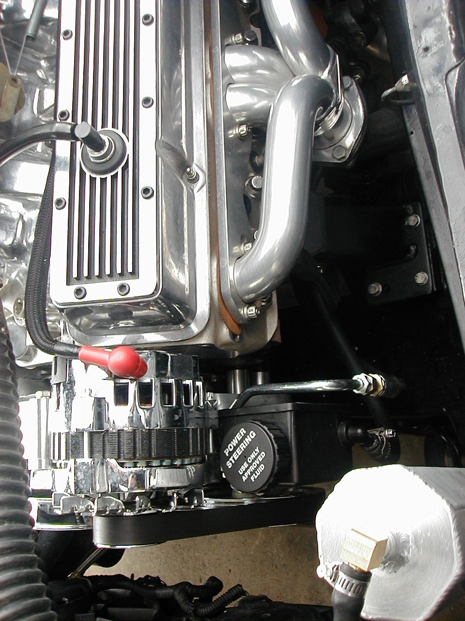

Default I lowered my PS pump pressure
I used a restrictor from DSE for my late model GM PS pump... works well with the S1 Jag stuff... never could find out the pressure outputs and desired pressure of the Jag racks so lowering it seemed logical and it works.

Man Roger, that looks clean! I will look into that then. We ordered a "new" rack from Andrew and I would prefer not to blow it! I'm assuming it's whats attached to the chrome line coming off of your pump?
