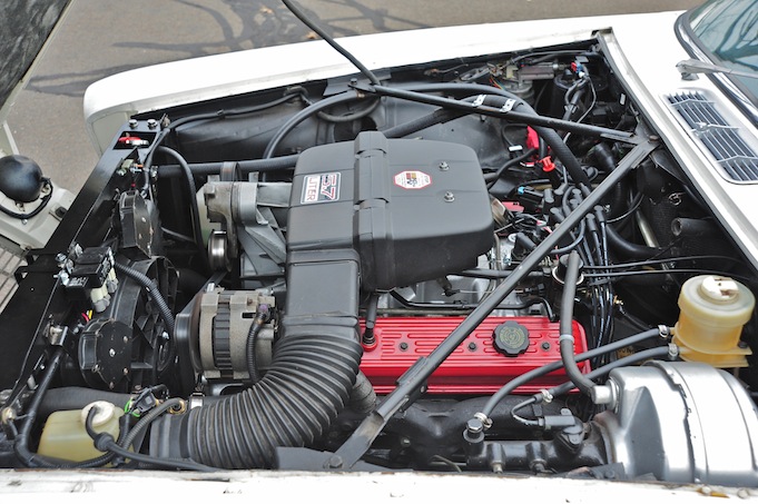

I finished my chevy conversion over tne summer, it was a car that was siezed up and put in a barn 15years ago. For the wiring, i would sve your self a lot of headach and go with a new wire harness, painless makes good systems, i bought a 1993 buick roadmaster wagon, stripped its engine and trans and all electrical to rewire the jag from head light to tailight. All connections were soldered and i used marine shrink wrap so no moisture would get in. Plus usingyour own wireharness lets you put in other things if you want, i have an auto dimming rear view mirror with map lights hooked into door lights, cruise control, and push button start.
One thing i would recomend is keeping a list of parts/part numbers and what car model you can find them on. Laminate it and keep it in the car so when you are on the road and your upper rad hose blowes out, it is easy for the parts people to look up.
I second the motion on a series 3 steering rack. After having both, the 3 performs much better, its cheaper and easier to get downthe road.
For rad and fan, i put in a 4 core hd camaro fan, and a ford taurus 2 speed electric fan. On high it pulls about 4200cfm. I have had my car out onthe hottest northeast summer days, stuck in traffic and my fan has never hit high speed.

My '72 LT1.700R also has a Painless harness with the ECU/PCM under the hood and on the passenger fender well. It has the dual Camaro/Firebird radiator, AC condenser and dual stock fans controlled by the computer.
My '71 383/200R has the Taurus fan setup but with an adjustable control for the "turn on" temperature (no computer) and the Camaro/Firebird radiator. It was installed before I knew about the dual Camaro fans and how well they worked.
Both have kept the cars cool in our hot So Cal temps and I use the AC about 300+ days per year - due to the BRG color and black interior.
