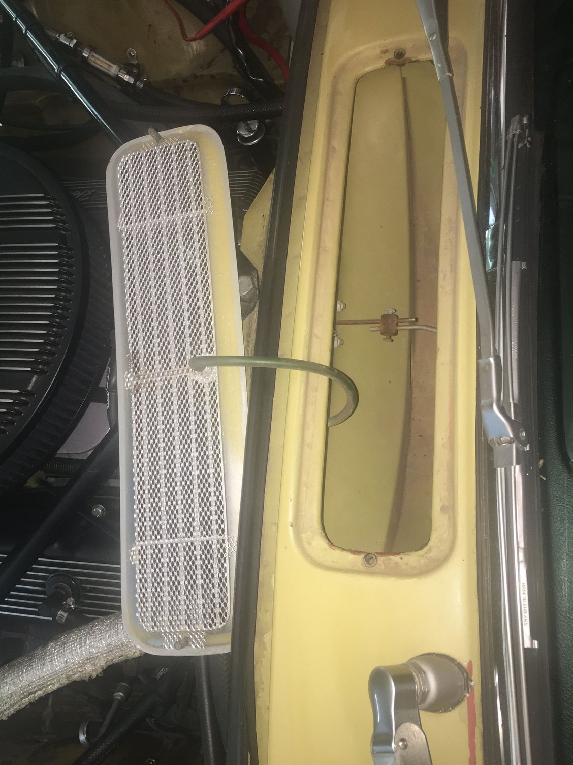

Considering a mod to increase under hood ventilation / decrease temperatures on my lumped Series 1, specifically when stopped or after car has been parked. Seems that when the ambient temps are above 85F the fuel boils off and creates a situation where the car starts but then starves for fuel and usually dies. Sometimes if idling to long it will hesitate on hard acceleration (fuel starvation). I've already added carb thermal separation spacers and some fuel line insulation, but problem persists.
I've been pondering creating a powered vent out of my Fresh air intake plenum. I thought that I could add a 12V crossflow type blower inside the fresh air plenum https://www.alliedelec.com/product/e...8-12/70371759/
I could regulate it with a thermostat to turn on and off as needed.
I have an optima deep cell battery so it may be sufficient to run for some time after engine is off. If not I could add a solar charger that sat on my dash board to either run the fan or keep the battery charged, or both.
Since I never use my Fresh air intake anyways it would be disabled via removing vacuum line.
Has anyone tried this? Would this not help my situation? I've always worried about under hood heat soak destroying other electronic components under the hood, i.e.. battery, HEI distributer.

If it wasn't implied I'd be cutting holes in the forward facing housing of the fresh air plenum to vent the engine bay.

Yes, I've installed an aluminum radiator and electric fan. It's controlled with a thermostat and runs after ignition is off until thermostat is satisfied. I don't have a problem with engine cooling while running. The temp gauge stays in the middle. However, my thermostat is not optimally located. It's currently in the upper radiator hose and the fan will usually run for less than thirty seconds after shutdown.
To improve on engine bay cooling after shutdown is why I wanted another active vent, but I'm not interested in cutting my hood or wheel wells. Perhaps just getting my radiator fan to run longer after shutdown would suffice?
Currently I just pop the hood when i return home, but that's not always feasible when out and about.
To improve on my issue of acceleration loss, I can try insulating the fuel lines better. They run in fairly close proximity to exhaust manifold. This may also be the source of the problem of starting and then stalling due to fuel loss caused by an air bubble (vapor lock).
I think I would still benefit from evacuating hot air from engine bay after shutdown though.
