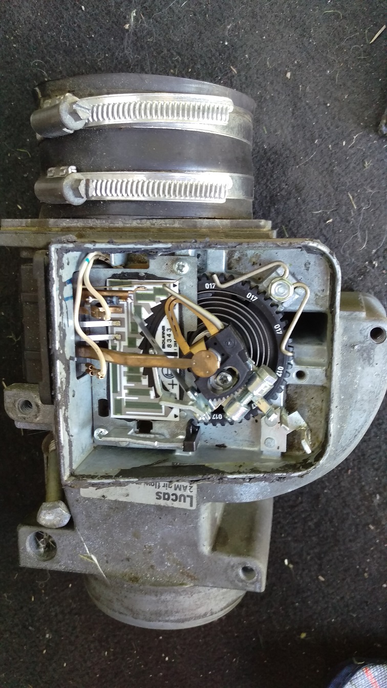

I scavenged an airflow meter from an '86 Sovereign from a nearby self-service yard on Friday, but it had had the seal broken and top removed ..
I was wondering if anyone who has worked with these can detect any missing parts from the photos? I am not sure if the person who hacked it was just looking for modules or whatever or if they actually removed a part. any help would be greatly appreciated. Looking at photos online I am concerned there is meant to be something at the bottom right of the first picture...

yes it's missing a part. little spring in corner on those two posts.
Look at my picture attached.

Thankyou. And also, dammit. I hope that piece is on my spares car ..

If you want this one. I will give it to you for free. You'll just have to pay the postage. I hope your parts car has what you need. I would suggest checking the flapper inside of it. This one rubs just so slightly and it causes problems, but it still works better than nothing. I can't seem to throw it away.

Thanks, that is very kind. I will check the new car tomorrow when I go to arrange delivery to see if the spring is there and if I need yours. someone opened up that one too in the hopes of pinching something !

parts car has the spring! So I'm all sorted in that I have a complete AFM should I need one.
