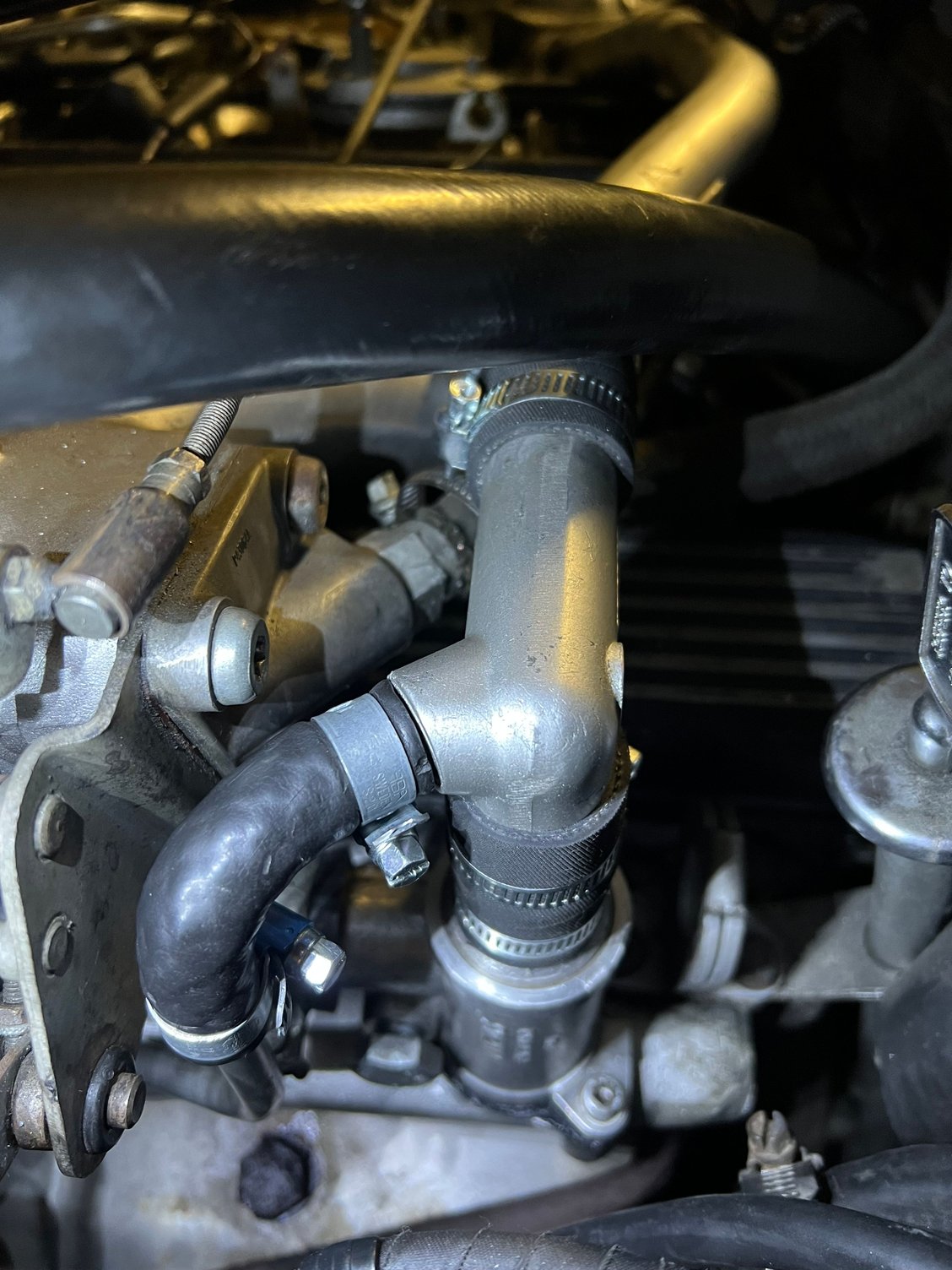

My Jaguar XJ5.3C 1975 has an idle ever too high.
I already change the auxiliary air valve with the stainless steel upgrade but the idle is even at 900 rpm when the engine is hot and if accelerate in neutral, the idle come back to 1.100 rpm!
After accurate tightening of the hoses I find the vacuum leak: on the Air Box of the B bank, the hole connected to the idle valve suck air.
The car doesn’t have a PCV valve on the airbox of the B bank and the breather cap is connected through an hose, directly to the idle valve and not to the airbox.
The question is: very early fuel injected V12 doesn’t have a PCV valve but only the breather cap?
if I put my finger on the hole, the idle goes at 700 (with idle screw completely closed).
I think the hole in the B bank airbox is useful for overpressure from the crankcase, through the breather cap, so the air should be enter in the airbox instead of exit from it.
Thank you in advance for your support!
Enrico

Good morning Greg and Thant you for reply,
your picture perfectly explain my doubts: the pre HE has a different path for the hoses, with the cap breather and without the PCV VALVE and n. 4 connection at the Idle valve:
