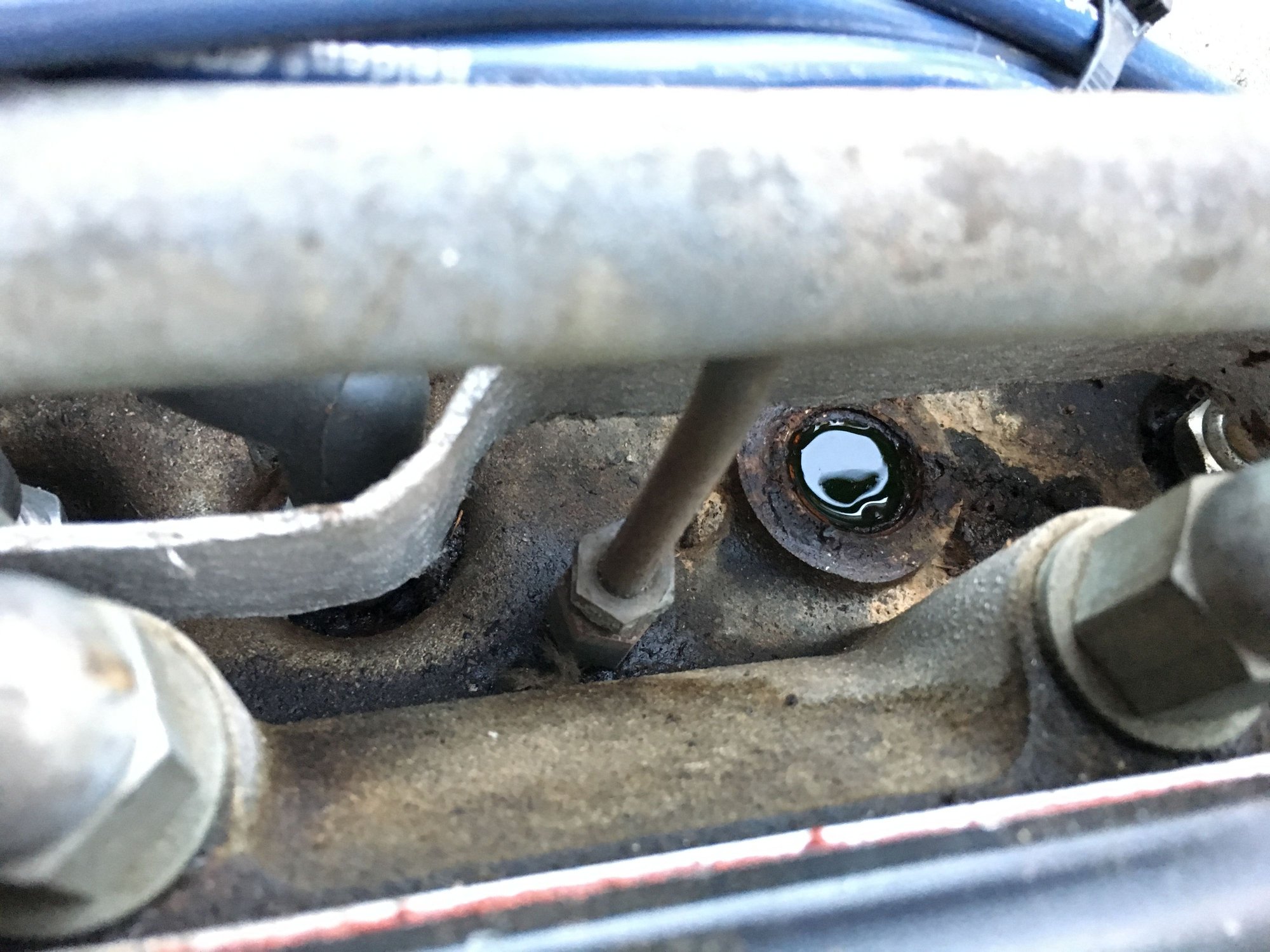

Hello today I saw this little spot of something similar to water.
I cleaned it up and it was like mold. Here is the picture before and after cleaning. Engine was warm when I saw this,
What could it be ?
thank you.

Guess: That core plug might have a minuscule leak. Clean it up a bit better; keep an eye on it.

is it something difficult to fix if this continues ?
so basically is it coolant fluid ?

If the plug is leaking you simply punch out the old one and tap in a new one. A bit of technique is involved. Cross that bridge if we get there. 'Tis no big deal
My guess is 'yes'
With the plug clean and shiny you might actually see a tiny perforation. But, if nothing else, if it fills up again and the liquid is the the same color as your coolant (green, most likely) then you'll know what it is

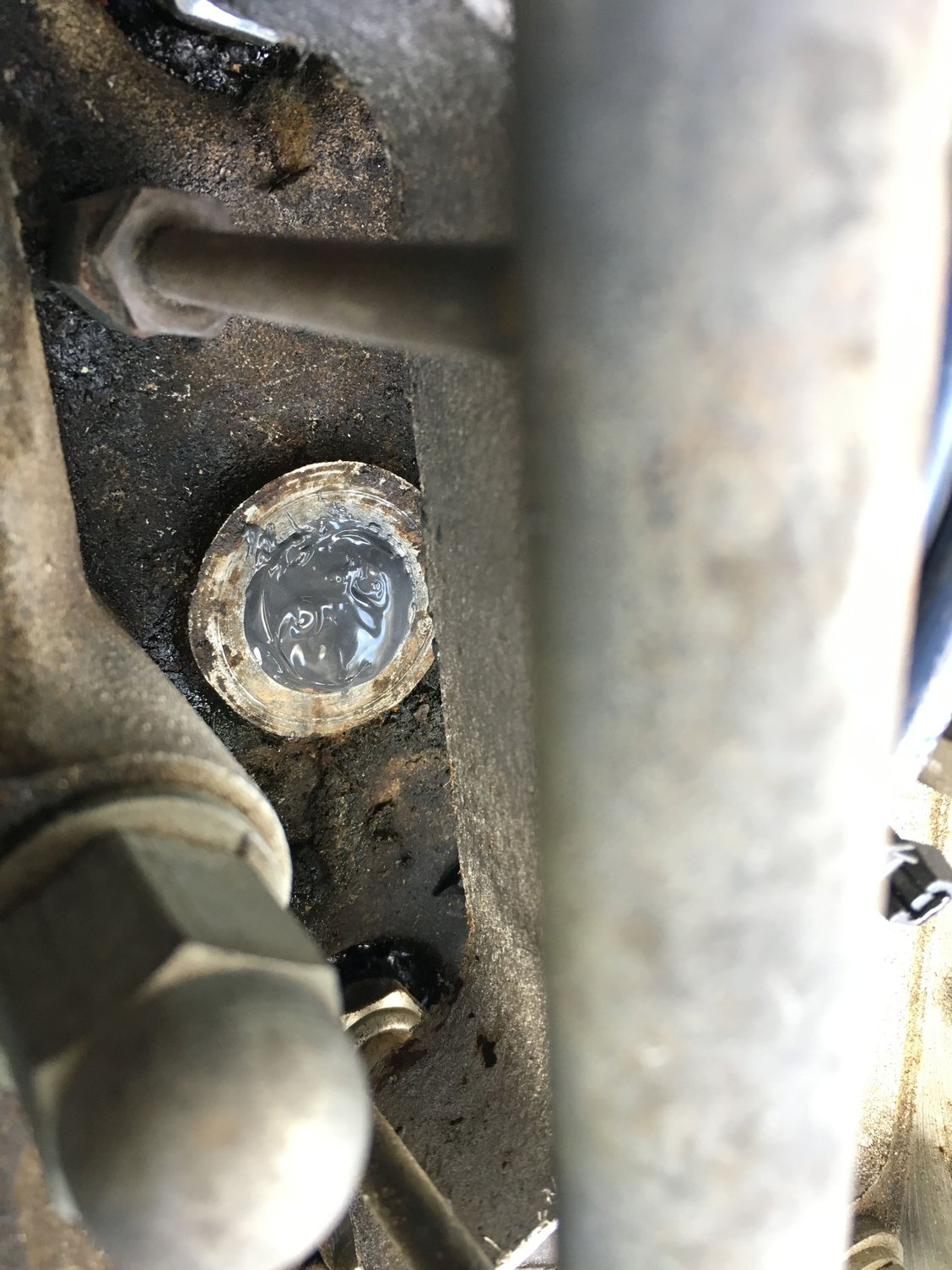

looks tricky to clean. there is some rust. Seems like I have to remove the cable management thing which is over there. I will use some thin sand paper to clean it better.

if I use JB Weld on the edges of the seal (it's leaking from there) will this be a problem if later on I Decide to replace the core plug ?

No. It can be broken when hardened. And, if you or your "mechanic" knocks out the seal to reseat a new one, force will be used.

Not in my view. force needed to remove the plug will fracture the JB just fine

so I cleaned up as much as I could and then I put pretty amount of JB Weld to cover the edge and the top of the surface of the core plug.
Hope it will work. I won't touch the car for 2 days. on Monday I'll try to run for 100mi
and see the effects.
Has anyone tried to place a core plug ? $400 seems overpriced to it as well as 3 hours labor.

A couple of thoughts.
Your mechanic does not want the job. So, a high quote and an "easy" answer.
At times those bad core plugs come out nicely and the new seats right in. At times, a big fight.
In this case access is limited by the air rail. removing it can be dicey. It may break!
But, a slide hammer should make short work of the extraction of that little one.
The JB is the way to go!!!
Carl

looks like it did not fully work. I Still have leak even if minor. And given that the core plug is now full of JB Weld, the leak will move to the cavity of nearby spark plugs... not good...
