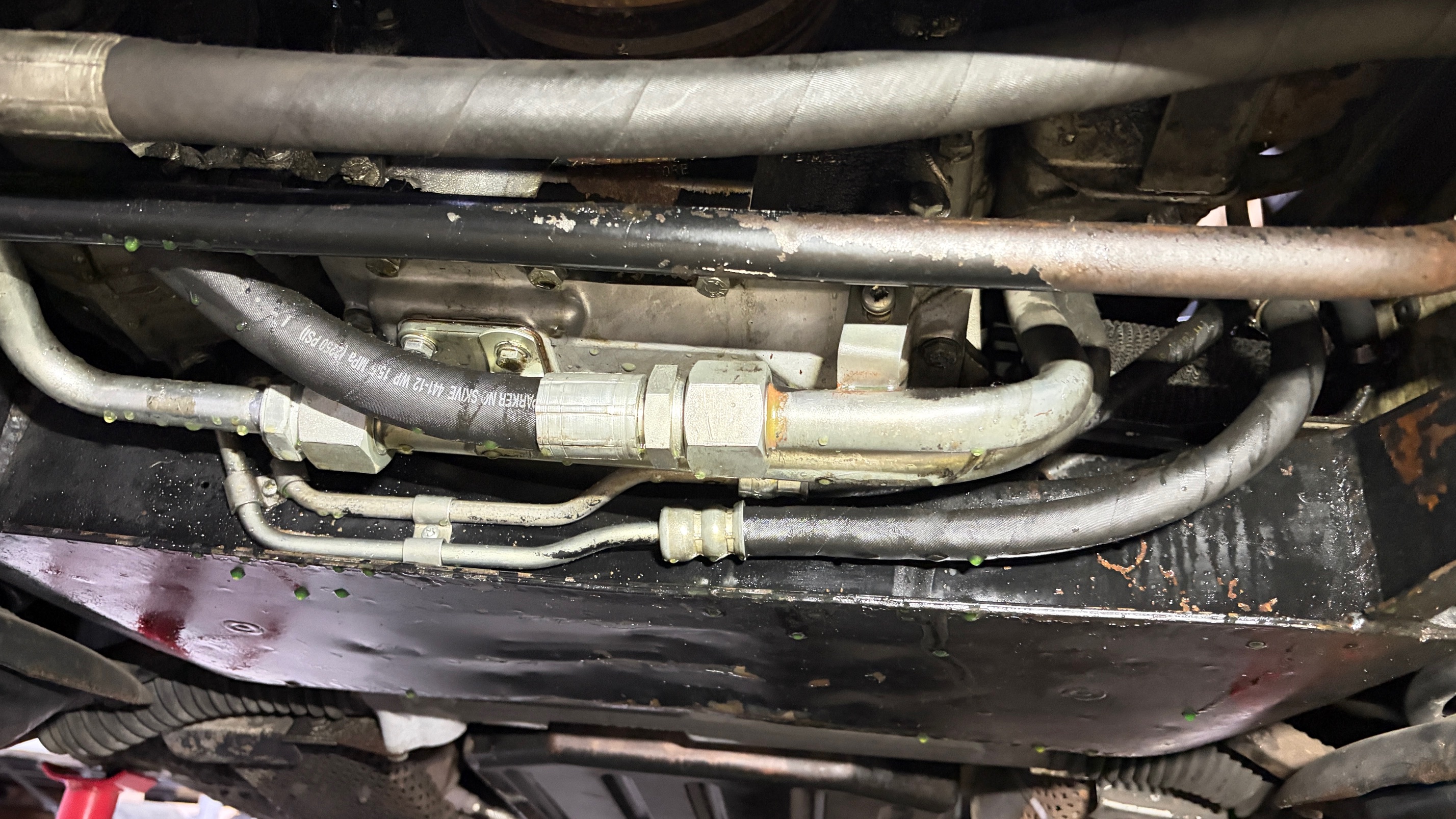

Attached photo are currently installed hoses. Only the high-pressure hose is leaking badly, but I want to replace all hoses this time. Does anyone have any suggestions which part number hose I should get after looking at these photographs?

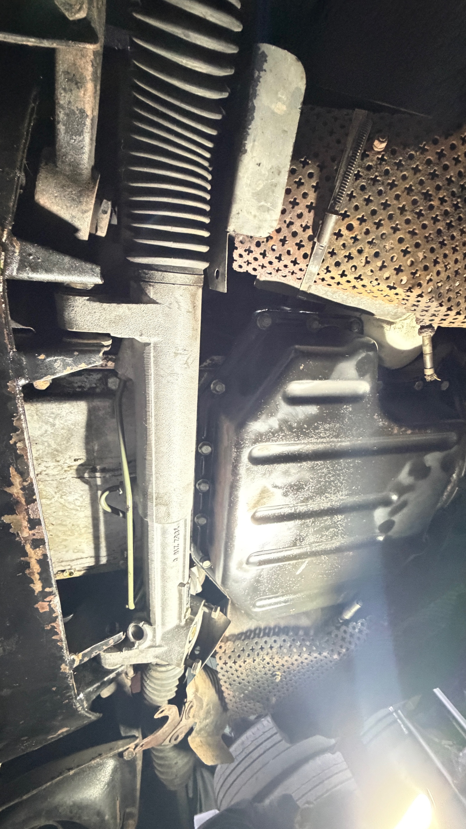

The JCP site for the later XJS models is confusing; but these cars used the ZF rack and the hoses are different (see link below). The hose part numbers you mention are the same as for the AdWest rack on the earlier XJSs. If your car has had a ZF rack fitted (either by a previous owner, or at the factory) then your hoses will be the ones for the later XJS models, as shown here:
Site link: https://parts.jaguarlandroverclassic.../brand/jaguar/
I suggest that you post a photo of your rack so what make it is can be positively identified. Once known, then it would be worth contacting Jack Weston at David Manners to ask him if he has the correct hoses for that make on a RHD V12.
Jack.Weston@davidmanners.co.uk
Otherwise:
The very best option is to remove your leaking hose and take it to an hydraulic hose repairer and ask them to fit new flexibles to your old steel parts.

Hi Greg and Jeff,
Thank you very much for useful suggestions.
I jacked up the car and checked the part number on the power steering rack. A metal plate clearly printed with the ZF logo and part number MHD3890AA was attached to the rack. Clearly, a ZF-manufactured rack is installed on my car. That means the high-pressure hose should be CBC9148 and the low-pressure hose CBC9404. Indeed, the high-pressure hose does resemble the shape of CBC9148. I haven't been able to remove the low-pressure hose yet, so I'll compare the shapes once I do. I recently got some help from Jack at David Manners Group. He was very kind and gave me useful suggestions. I'll try contacting him again.
