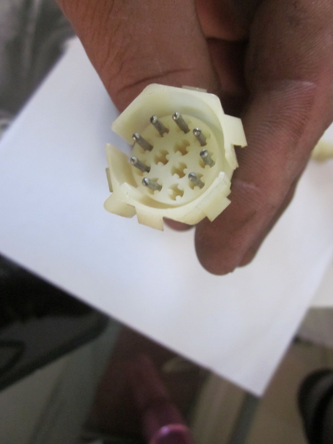

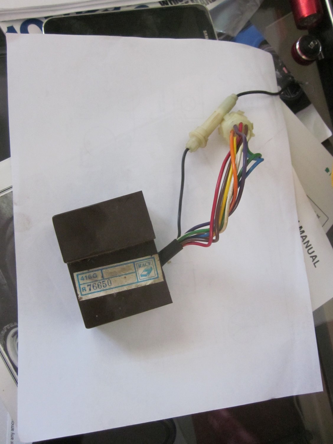

Ladies and Gents,
I was doing some electrical troubleshooting on my 76 S2 XJ12 and came across this module. I have no idea what it is and have not been able to find any info on it. There seems to be another one mounted under the AC box in the dash but that one was unplugged. does anyone have an idea?

That is the climate control unit to operate the servo and vacuum components.

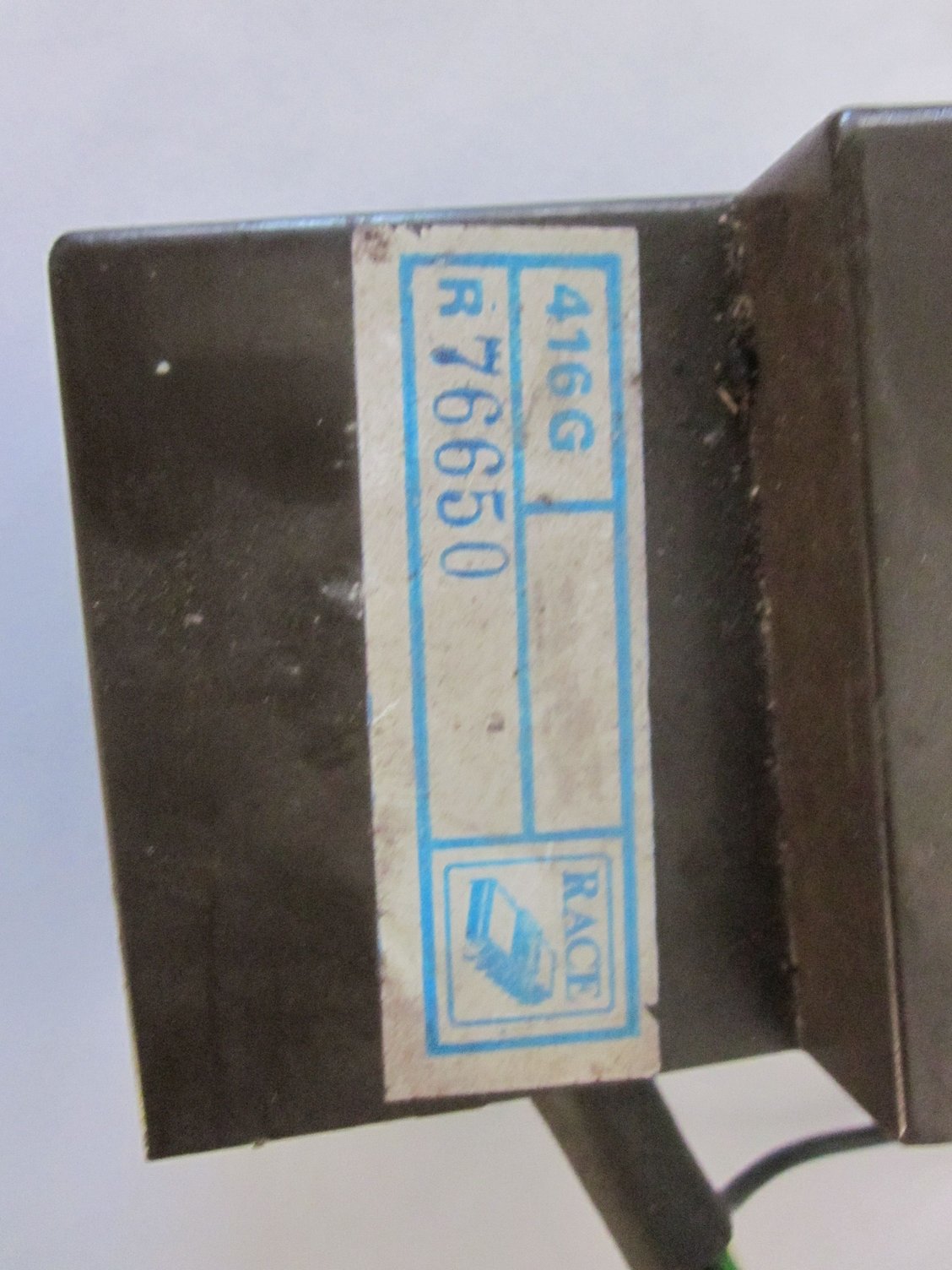

Any idea why there is 2 of them and any reason that this thing says "RACE" on it? I'm trying to sort out wiring and tagging everything as I go

Race! ... Wow...you've got the rare experimental race box that adds 150HP. Congrats! No...Seriously...they all say that, perhaps its the brand. These typically fail and were difficult to remove so its most likely that the old one was simply left behind. If your climate control works consider your self fortunate. These boxes often fail and replacements are difficult to find.

Yeah, I suspect "RACE" was the manufacturer.
Gary from this outfit will know....
https://www.jag-aire.com/

that is the A/C Amplifier.
they left the old one under the a/c in place because it is a pain to remove it, so you just disconnect the old one and connect the new one.
