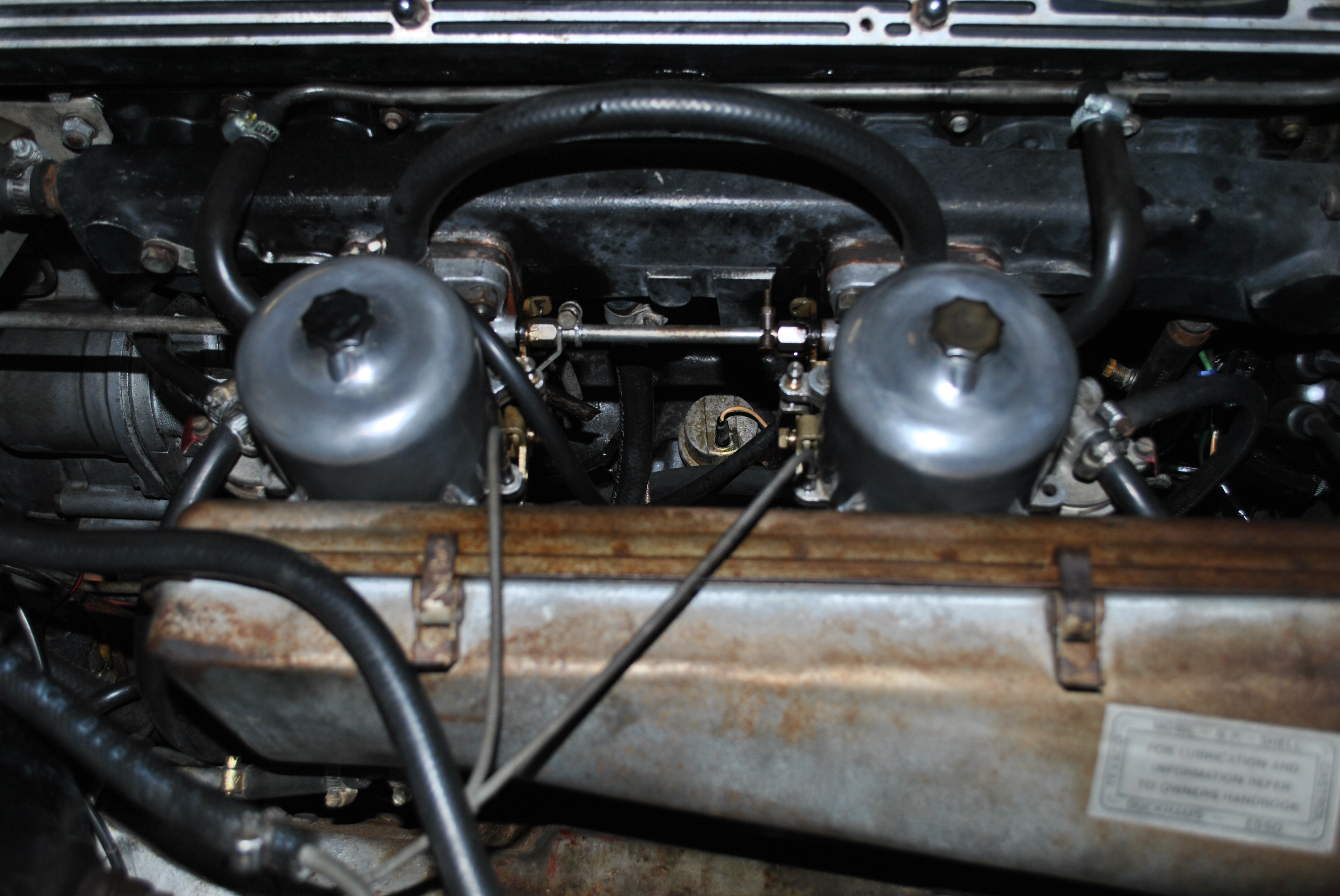

Doe's your car have carby's or fuel injection. Carby's look like the pic below,they are on the right side of the engine.
