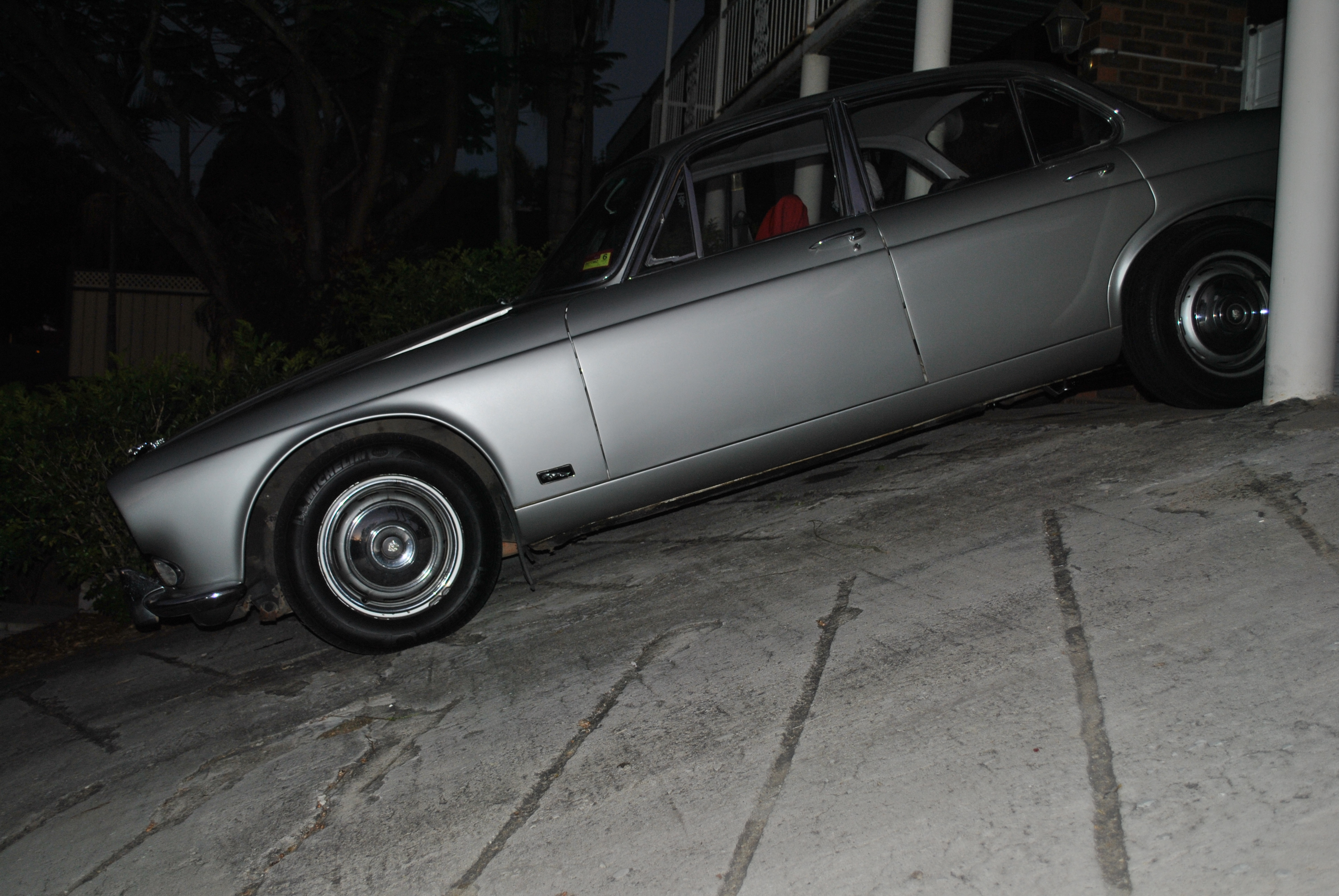

5. Handbrake pretty useless on a decent slope, even though it passed roadworthy test (common?)

handbrake is usually not very effective, but if parking on a slope, apply handbrake first tightly, and last place transmission in Park. Helps to turn the front tires against the curve.

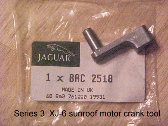

sunroof can be opened and closed manually if you have the little crank tool that came with the car but which the previous owner didn't know what it was for.

My experience with Series IIIs and XJSs is that the parking brake will grip fiercely if everything is lubed, adjusted, exercised, and the pads are properly bedded. Mine would hold the car against 2500 rpm.
That's as a *parking brake*.
Don't expect much if used as an *emergency brake*

The parking brake I rarely ever use. in actuality the "park" position is a metal bar that goes ito gears and actually Jams it so it CANT move. if it does move in "park" then you have transmission issues. In all the case I've heard of cars rolling away when they were parked it was because the owner didn't actuallly put it in park.

I have found the handbrake just average, but havent given it any extra love, so I imagine that Dougs comment (apart from the fact that Doug said it so its probably right) is on the money.

Jose, I forgot to mention - I do have the small crank handle for the sunroof. In fact it is placed in the factory tool kit which is strapped in the boot and has never been used. It even still contains the stick tyre gauge!
