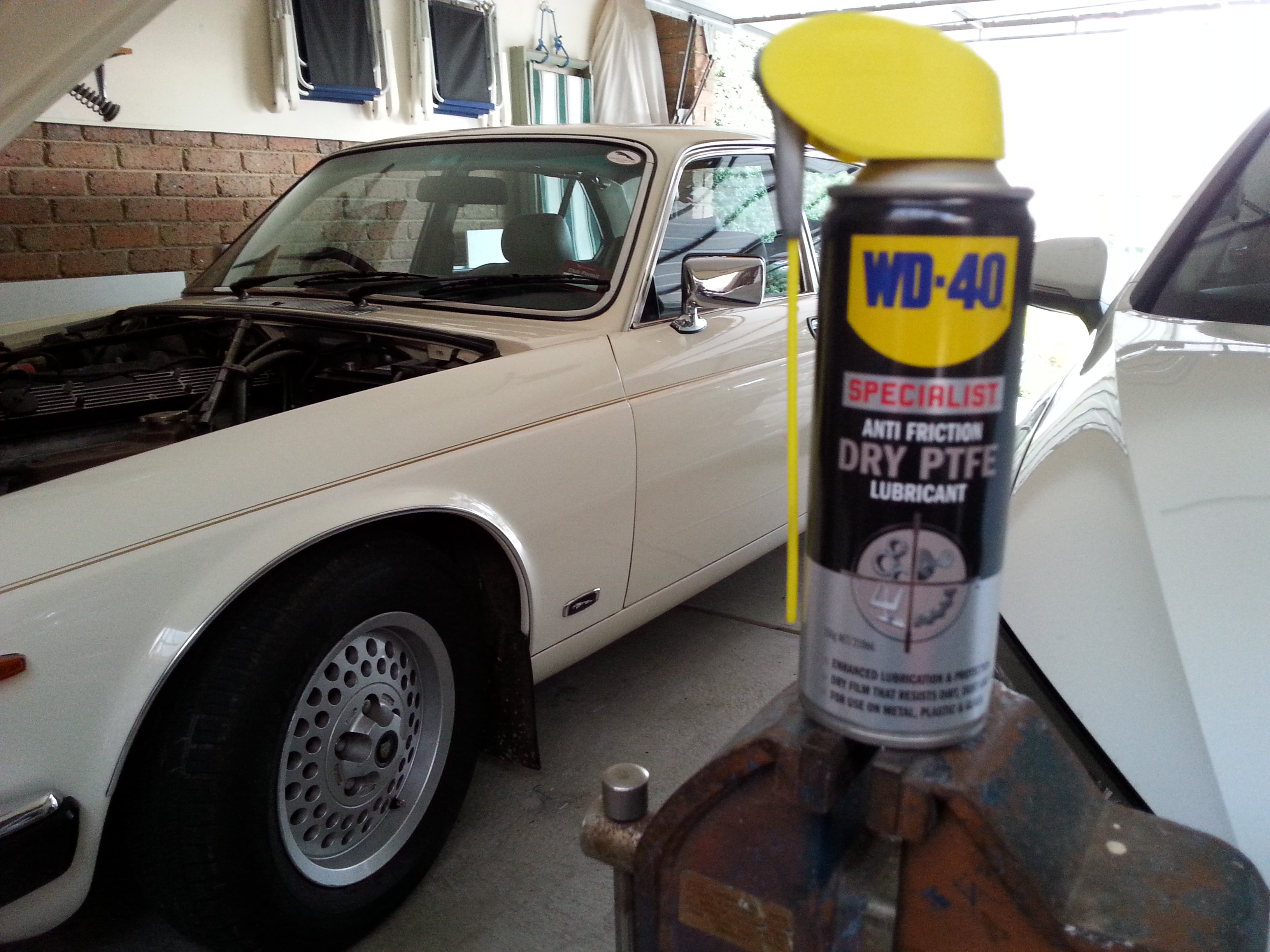

Finally got around to taking a few shots today, perfect weather so "The Duchess" (her new moniker) was allowed out for a run.
Only a couple of items on the fix list done so far:
1. Windows now raise faster than a speeding bullet thanks to WD40 Dry PTFE lube (pictured) sprayed in the channels then about a dozen or so ups & downs to get it all nicely distributed. If anyone is suffering lazy or dormant windows, this stuff works wonders. And it's designed to repel rather than attract dirt.

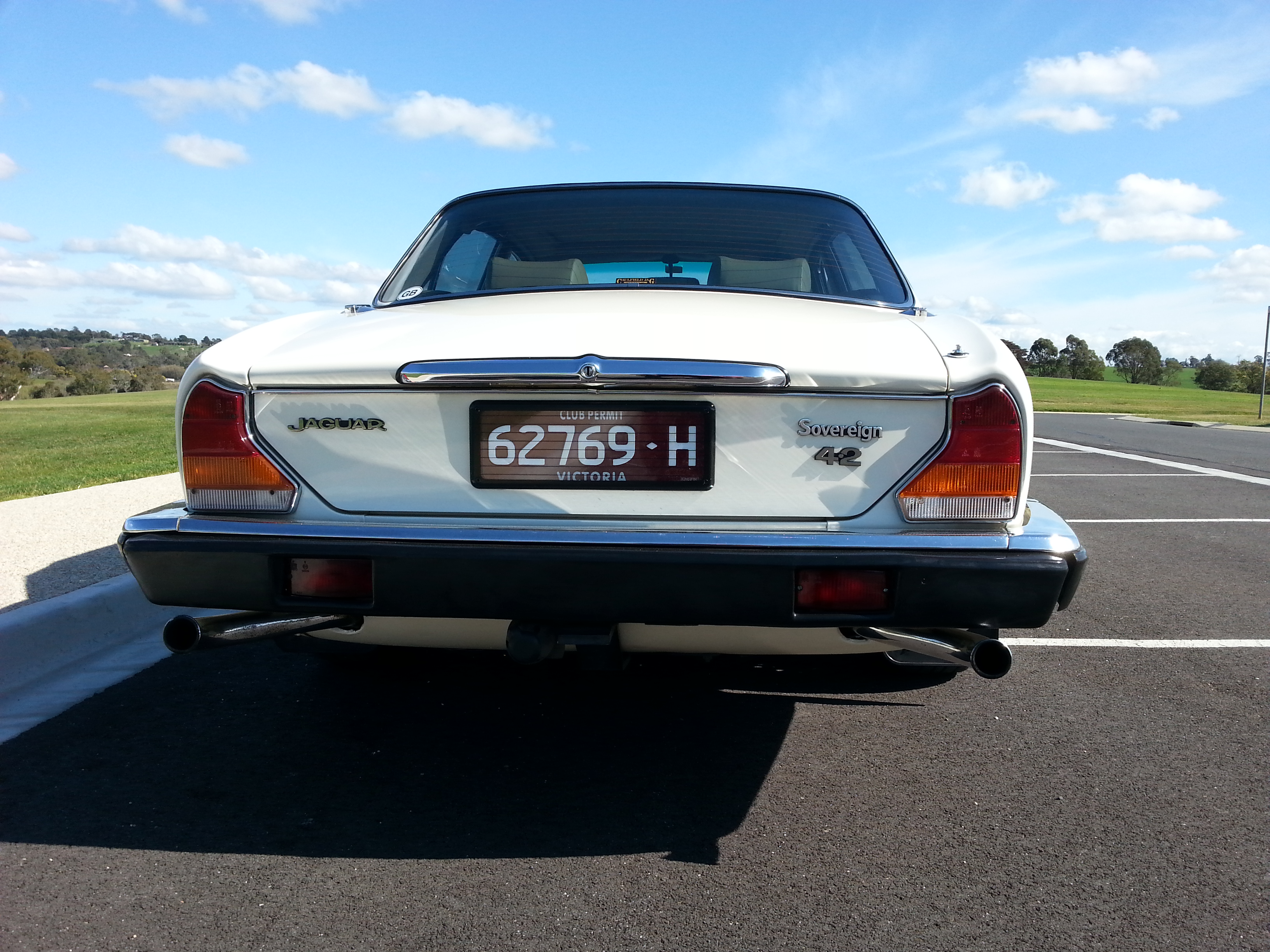

2. Rear bumper fixed. The beam wasn't dented after all, but the rubber had somehow become distorted. Manipulated it slightly and replaced the lower clips with larger/stronger ones to hold the shape - job done, looks much better.

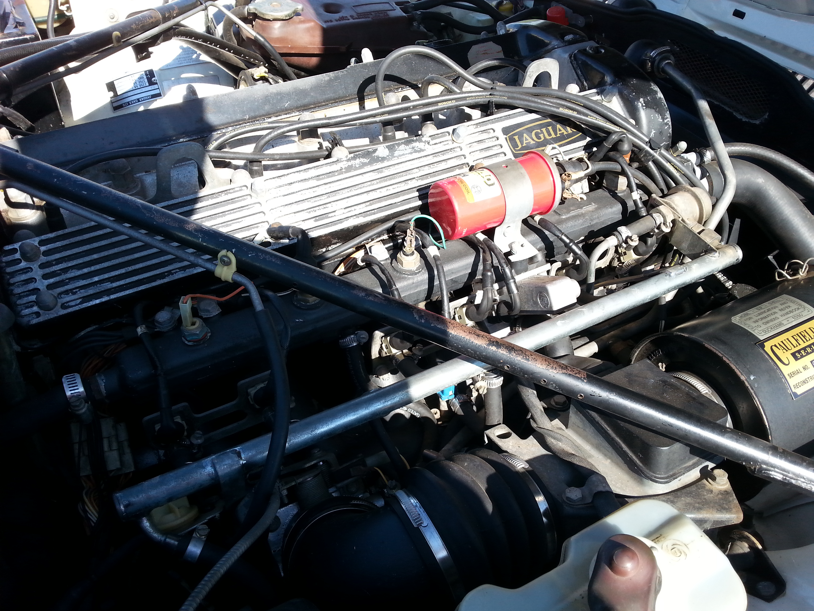

The engine bay shows that detailing work is required, duly added to the list.

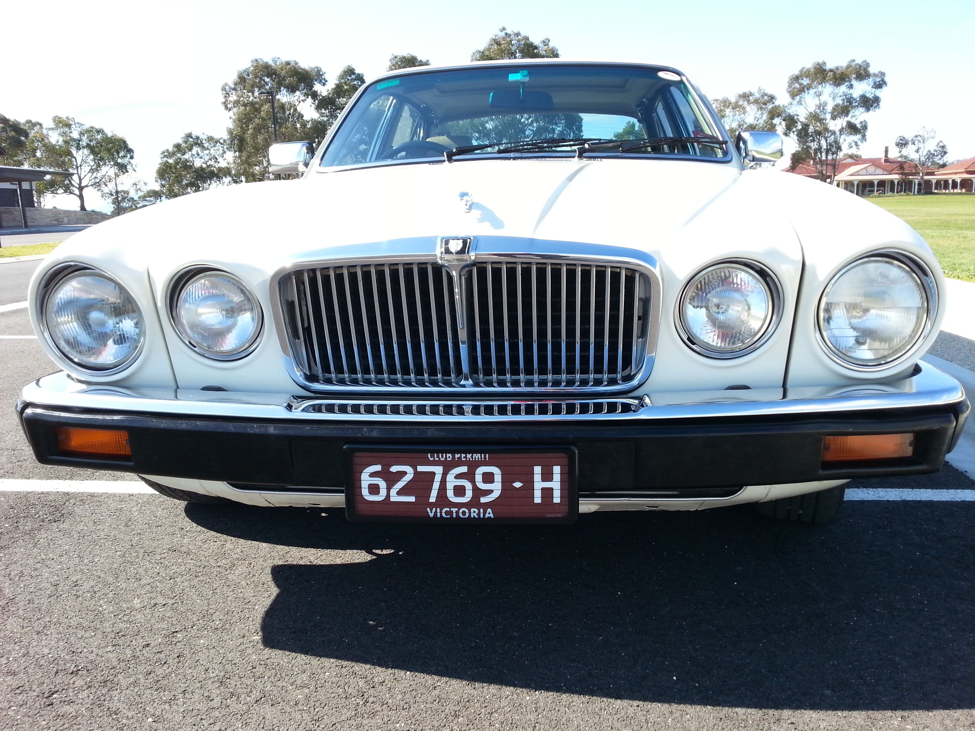

I decided to re-register her on Club Permit / Historic Vehicle plates. A very cheap option compared to full reg. She won't be a daily driver so this suits me fine.

very nice.

right purty automobile
Theres a lot of engine isnt there? when your LUMP conditioned you tend to forget the engine bay is normally quite full

haven't seen that WD40-dry spray over here in the USA. I'm ready to try it.

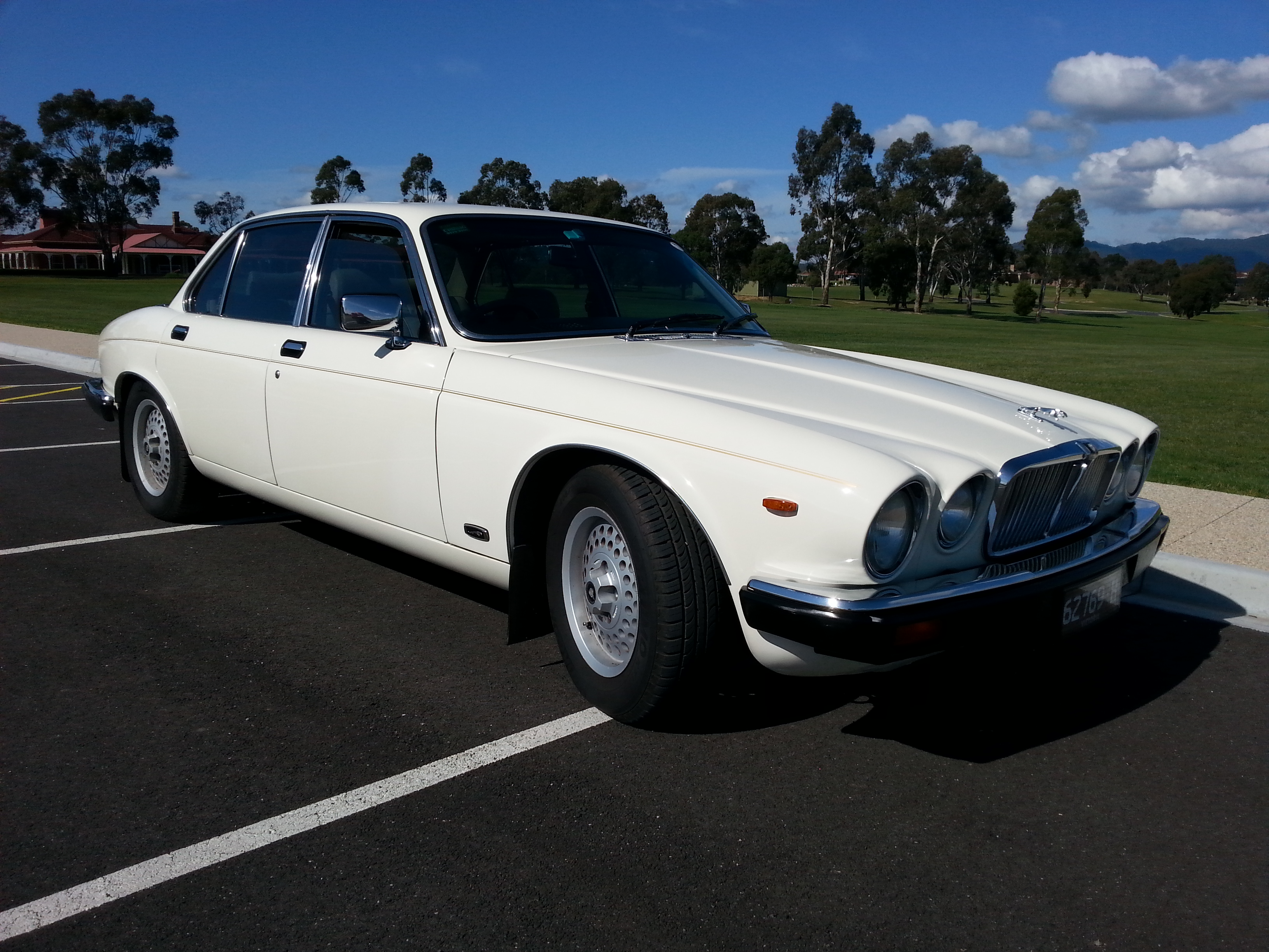

that car looks excellent. What is the edging that can be seen on the front wing ? Never seen that thin edging before. Can you take a picture that shows how it is attached ?? Looks very good.
I believe that is the pinstripes.
Old Aug 22, 2015 | 08:10 AM
  #39
Jose's Avatar
Posts: 9,139
Likes: 2,662
I was referring to the wheel openings, seems like a chrome ediging ?
Old Aug 22, 2015 | 08:57 AM
  #40
amaezing's Avatar
Joined: Sep 2014
Posts: 547
Likes: 71
From: Colorado
I didn't even notice them. Those would look way bad a@# on my black jag. Gotta find some for me now. I'm sure they simply fasten by screws underneath.
