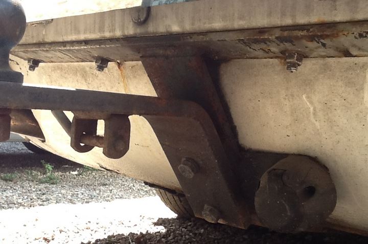

I got a picture of the towbar. As you can see, this one is different as the one shown in the thread mentioned above. This one has someting going under the car, connected to the chassis...

That is certainly more substantial than the one I got hold of then. The one I had only had the four bolts you can see in the pic and one further down in the lower panel but not bolted to the chasis.
If I could find one to bolt to the chasis I would use it.
