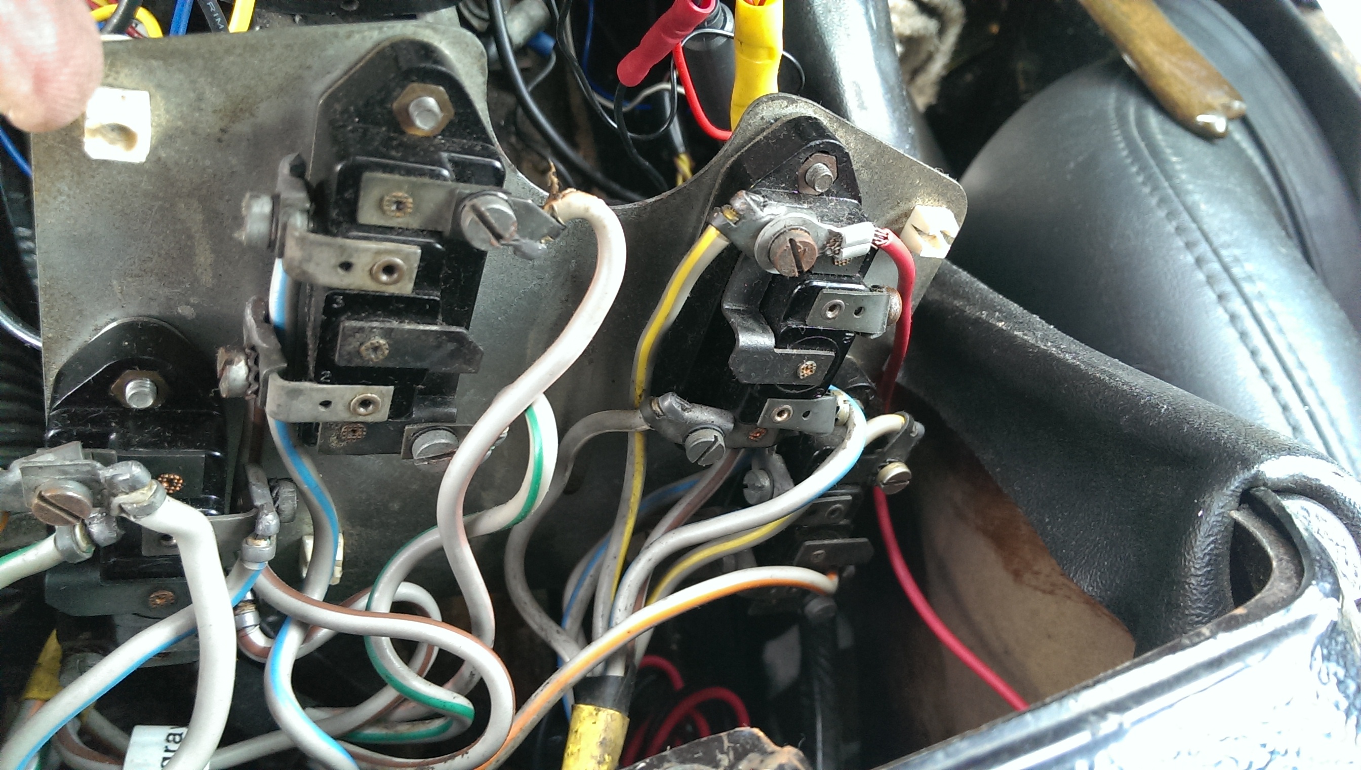

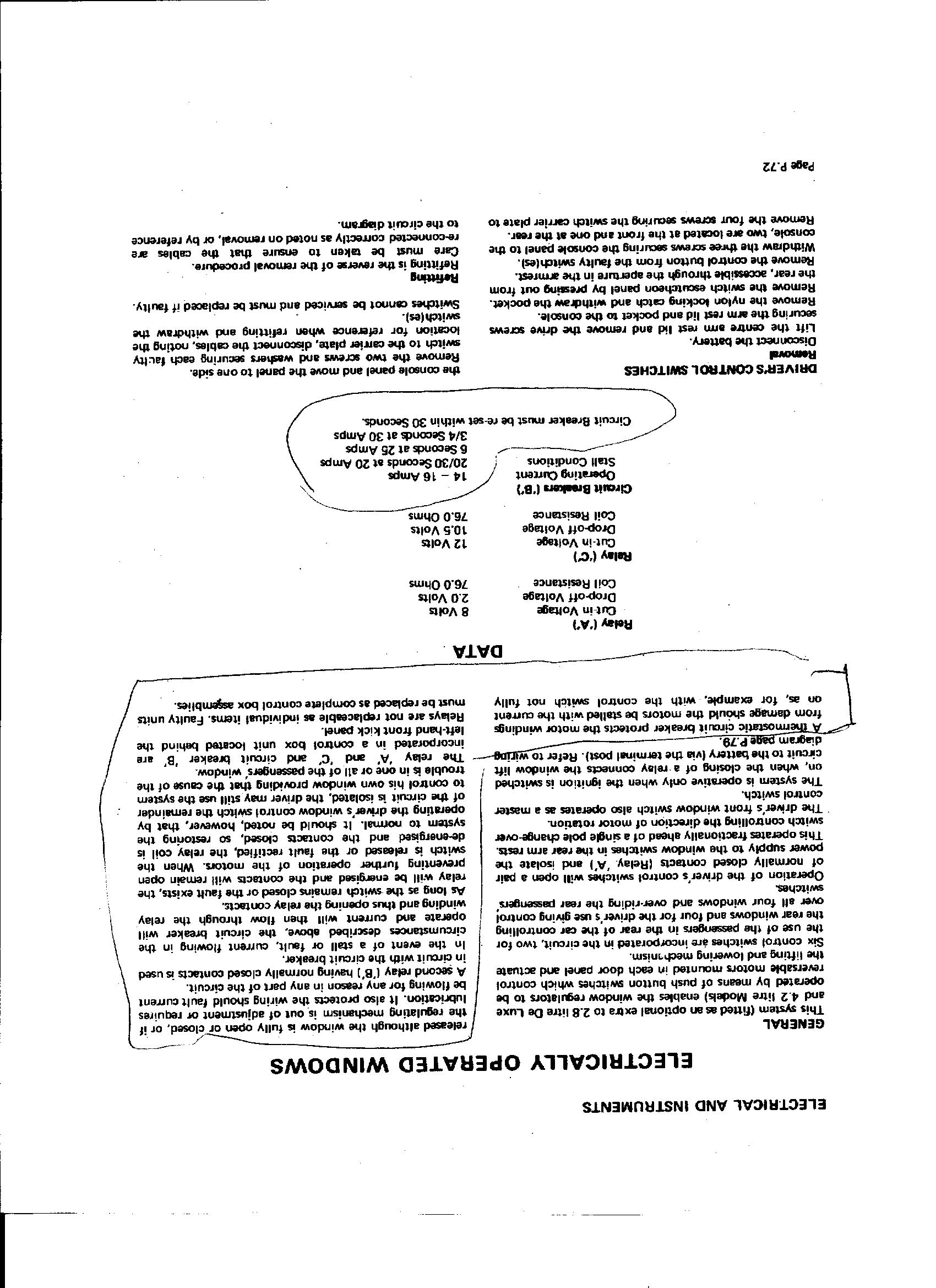

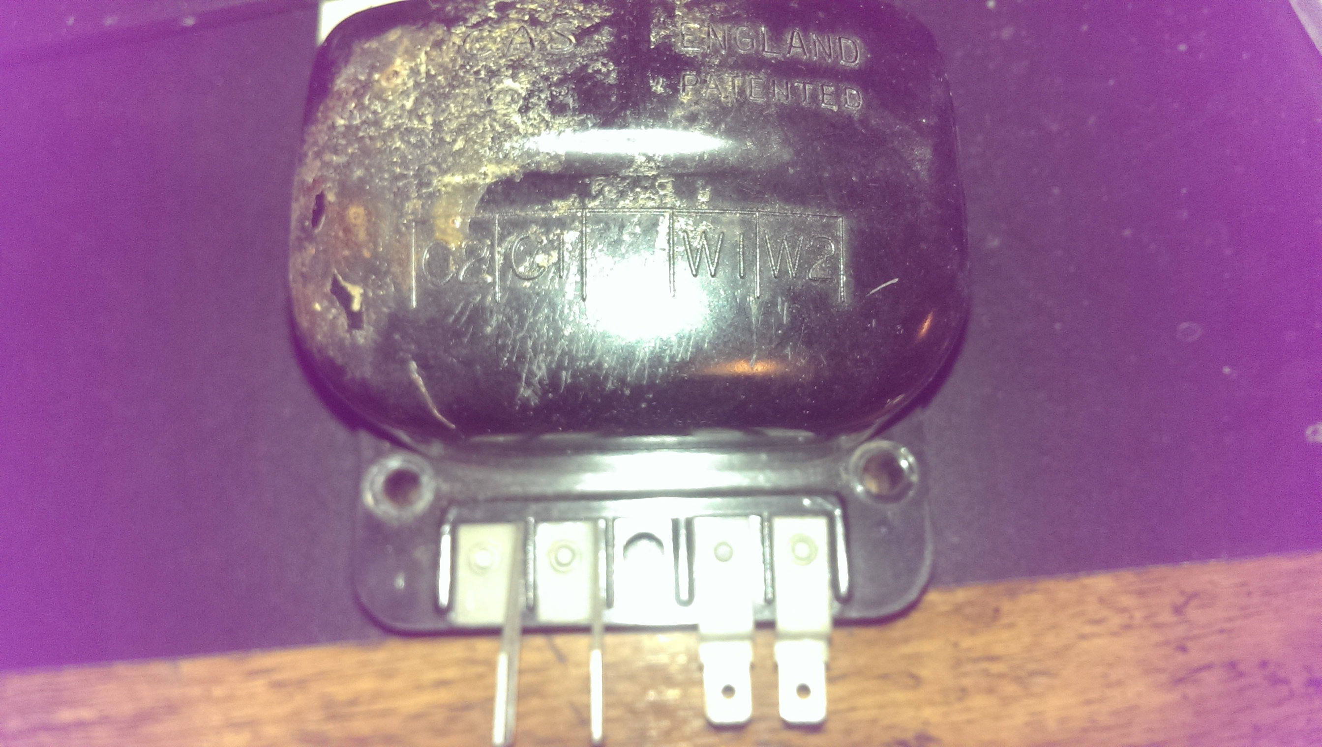

Default S1 window wiring
Hopefully this will help with your window wiring... the last photo is the control box located in the drivers side kick panel on the outside of the car.
Attached Thumbnails Window motor/regulator-drivers-switch-wiring.jpg   Window motor/regulator-schematic.jpeg   Window motor/regulator-window-control-box.jpeg   Window motor/regulator-imag2122.jpg

Motors just have the one connector on the bottoms and the Black ground wire... colors of the wires for all the window switches are on the schematic I attached on the post above.

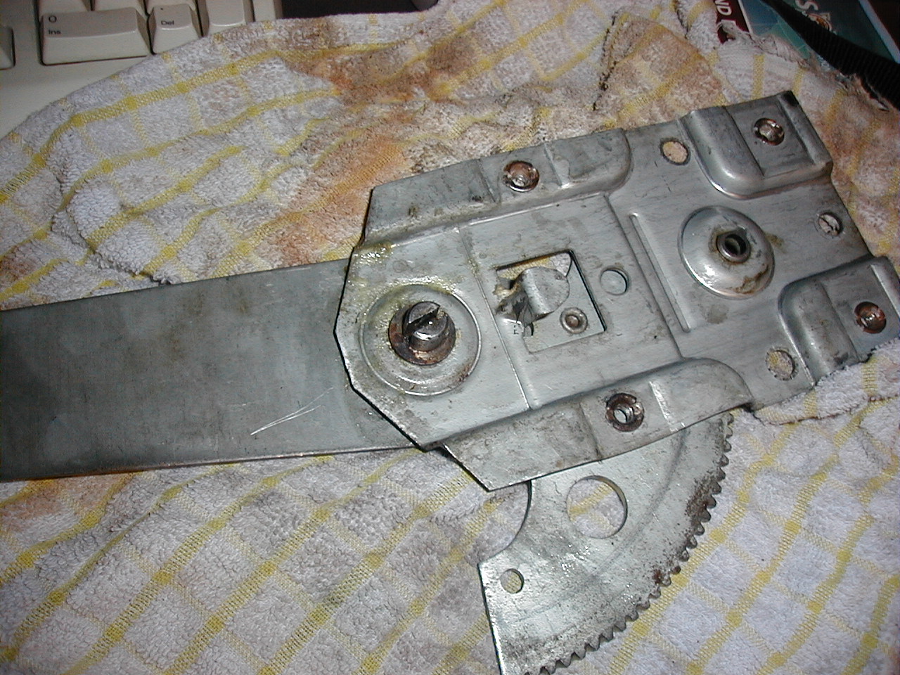

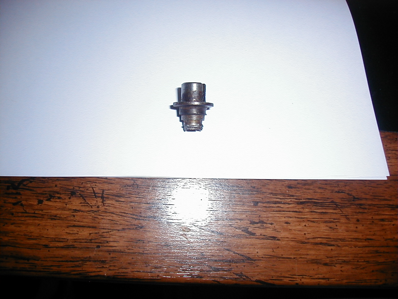

I never took any photos of the motor wiring inside the door... do have a photo of the regulator when I put on a new bearing to fix a worn out regulator. Finding parts for these very old cars is becoming a huge problem.
Attached Thumbnails Window motor/regulator-drivers-window-regulator-arm-bearing.jpg   Window motor/regulator-drivers-window-regulator-arm-bearing-002.jpg
