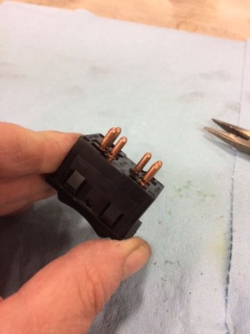

The switch is disassembled by applying pressure to the little pivot pins in the side of the case. I use a small screwdriver as seen. A little force is needed to pry the rocker portion of the switch away from the case. No worries--it's pretty rugged; you won't break it. Reassembly takes a bit of pressure as well, to pry the case open enough for the rocker to drop in. You'll get the hang of it.

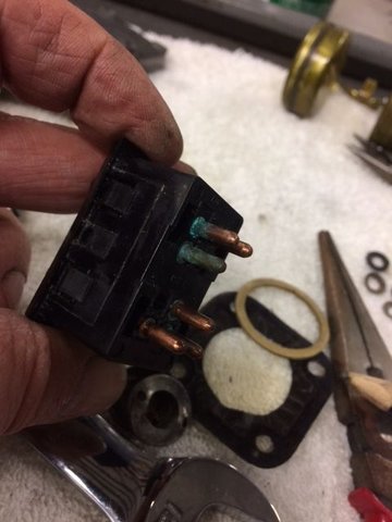

These are the spring loaded pegs that actually press against the internal contacts to make/break the circuit. They're greased up so they probably won't fall out. One trick is to disassemble the switch inside a clear plastic bag...which will contain any tiny pieces that fall apart

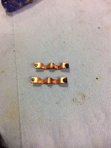

Pic 3

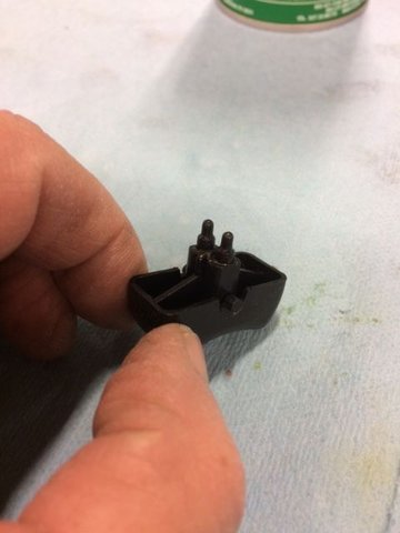

These are the movable contacts. They fall right out or can be plucked out with needle nose pliers. Note how a couple of them are black with oxidation. Gently clean them with fine sandpaper....just enough to make 'em shiny. You're not trying to remove material here !

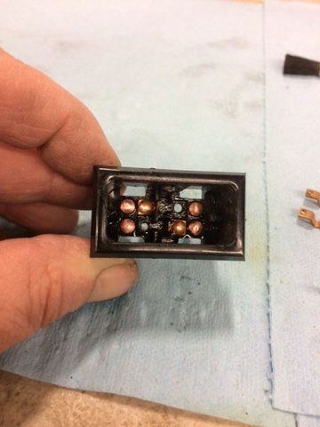

These are the fixed contacts, badly corroded. More often they'll simply be black with oxidation. I clean them with a bit of sandpaper held with needle nose pliers. Again, just make 'em bright and shiny. Don't go hog wild.

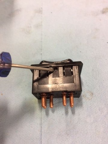

Cleaned contacts

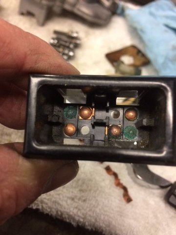

Dirty, corroded contact pins. Sandpaper 'em till bright

Dielectric grease is used over the contacts and friction points. Sold in "ketchup" packs at auto parts stores.
I've also used Petroleum Jelly, aka Vaseline, no issues so far. It does not harden like dielectric grease. It is a lubricant.

I use a little wad of steel wool to clean the contacts and use the eraser end of a pencil to wipe it around down in there.
