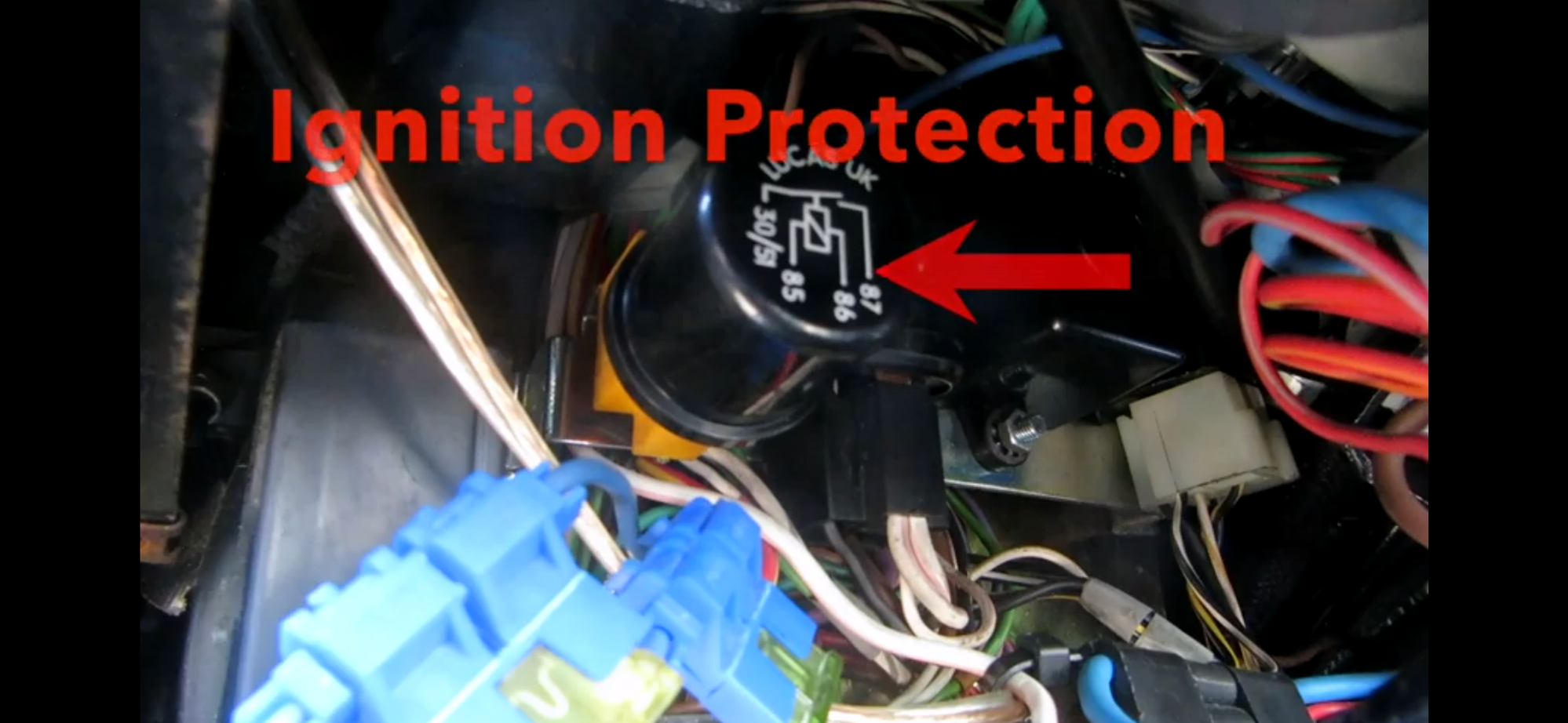

I just had the exact same issue. There is a ingition protection relay under dash that the wiper motor juice flows through. I had a spare and fixed problem. But I also took old one apartand cleaned and it works now too
Let me get more details as to location. Cant recall..
On left side under dash. Can get via access panel or take under dash piece off for mor room
Randy
Crude but you see this protection relay is before fuse 6 so everythung downstream loses power when this does not do its thing
