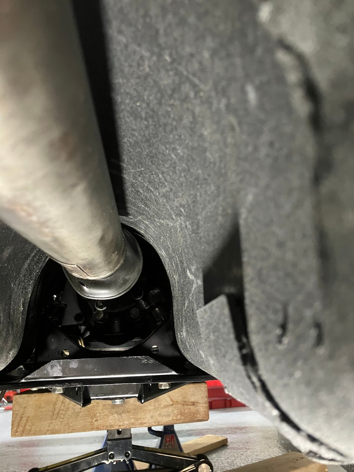

I am getting the gear box mounting back into the car. New rubber bushings.
When assembling with both end rubber washers (in the picture) + the middle bushing I think the gear box ends up too high ->
The prop shaft rubber part almost touches the drive shaft tunnel. I will try to make a picture...
Any tip on this?
How much is it supposed to "bounce" once put back together? With only the spring it gets really bouncy... Just did that for test.

Ok, thanks. i will have to take it apart again and figure out whats going on. Definately not correct like this...

I got it a bit better but still doesnt seem ok... hmm
It would be a great help if anybody could take a picture how the gearbox mounting should look from underneath (V12 + borg warner). I guess a straight 6 with borg warner would look the same?
I know all the heat shields and stuff will be in the way but maybe something is visible still.
