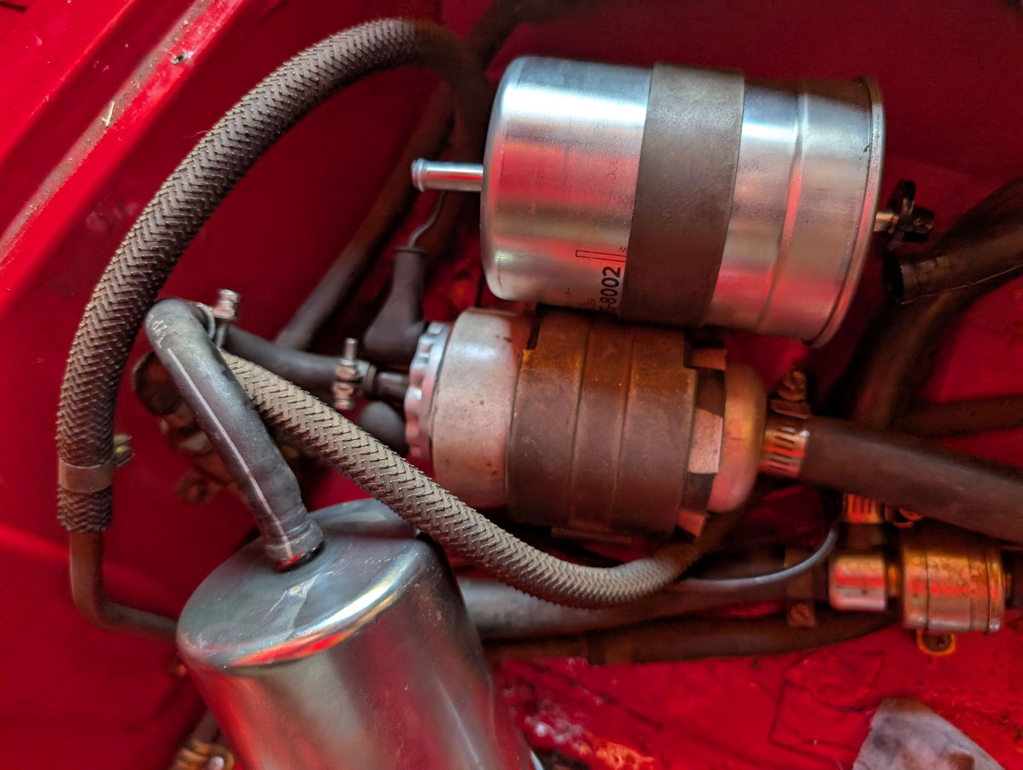

Well it seems that I do have water in the left tank. Car runs for about 10km and then stops or runs rough.
So time to drain the tank, refill with fresh fuel and put in a little dewatering fluid to take up any drops left. Drained the tank and got a bit of water and not much crud. Next to replace the fuel filter.
Well who was the idiot who designed the mounting system for the fuel filter and fuel pump. Is a combined bracket with the mounting bolts under the lot where you cannot get at them. It is little wonder mechanics are loathe to do this job which should be straight forward.
It seems there are no tools to reduce the size after upload.
The old filter is the one at the top, still attached to the fuel pump and bracket. Having rest before going back out to try and remove it. Really some engineers really need to be made to service items they design. Three bolts that mount the assembly to the floor and only one has reasonable access.
My issue also highlights how mounting the fuel fillers in a flat horizontal surface means that the seals for the fillers need to be perfect or water will enter the tanks even if the drain is clear when there is a high volume of water falling on the car.
