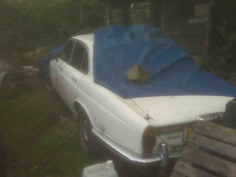

Old Mar 22, 2012 | 01:57 PM
Left hand drive would certainly work, so would right hand drive I don't mind and drive both on a daily basis.
However, I am not looking for a Series 1, I have already found one in the back of a garage.
It is an original rust free 2.8 Manual with Overdrive unrestored example.
I am just waiting for the owner to give up on it, at the right price. Currently asking $2400. When I can get him down to $1000 I'll be in there.
I don't know what condition the engine is in, it drove to where it now is, and was then just switched off and left.
I do have a spare XJ40 4.0 unit, but have nightmares when I think of the electronics work that would be required to fit it.
The owner is a friend of mine, so no problem waiting things out.
Teaser shot,
