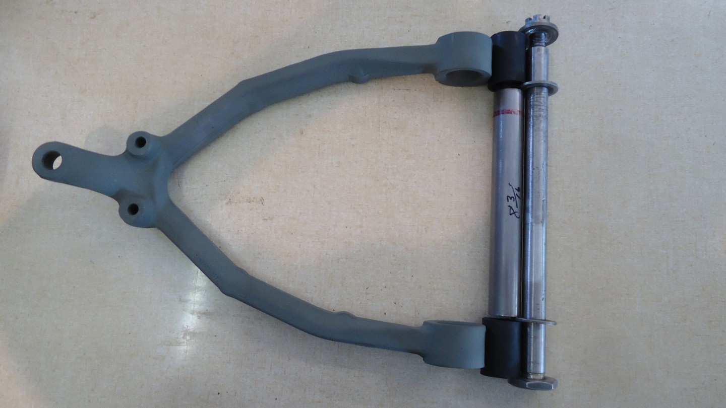

Bought some new bushing for an 86 XJ6.
How are the LCA & bushings assembled?
In other words, when the bushings are slid into the "rings" of the LCA, what gets them "registered"? They can slide fore or aft until the castle nut is tightened up, only then do they become fixed. Depending on where they are at to begin with, it will affect the caster does it not?

The couple times I've been thru this I found that the bushings did not "slide" into the LCAs at all.
They had to be *pressed* in.
I recall centering them....and equal amount of the bushing exposed on either side of the "ring" of the LCA.

OK, thanks for the info Doug. I was able to get the new bushings into the LCA without much trouble at all. Used a 3/8 bolt, some washers and a "cup" to pull them in until they looked to be centered.
What really made it easy was using some silicone spray.
