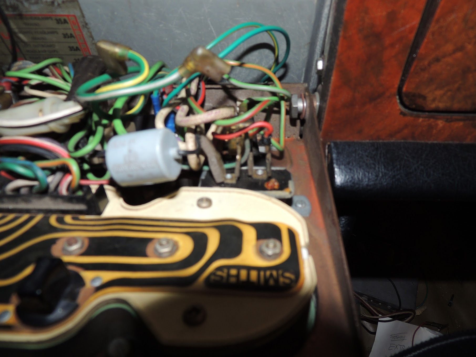

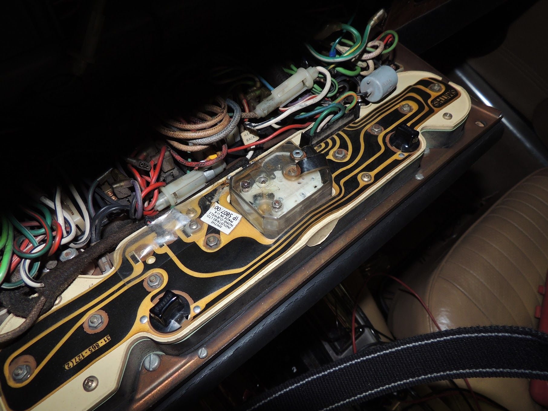

Here's a picture from my long-gone 1972 S1. Remove the two thumbscrews on the top corners to let the center section pivot down.
These aren't the best but they're the only pictures I have of the center section folded down.
