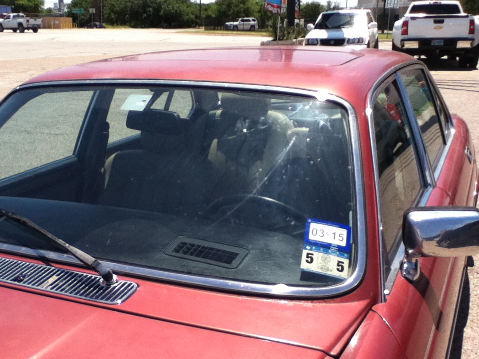

Hey ya'll,
getting ready for a hot summer here in central texas and trying to keep my jag cooler inside out and than last summer - radiator recently re-rodded, with fresh coolant and put in a new coolant temp switch myself and updated some of the other various cooling system electrics for my own piece of mind. I'm running at exactly 88-92 degrees C by dash and actual measurement but with no working AC and no UV film or tinting on the window, the cabin is an oven at 85F outside and I can't bare to do another summer of 100+F everyday for a month (like last year) - the sunroof can only do so much! I've developed burns on the tops of my hands from driving long haul summer trips before in this vehicle so it's time to make a change.
I'm definitely getting the windows tinted - but following road laws is pretty important to me and I drive through Texas, Oklahoma, and Kansas pretty regularly in this car - Texas is pretty lax 25% front, no rear side limit, no rear window limits, and A6 line or 5" down on the windshield but Kansas has much more strict limits 35% front and rear sides, and the A6 line on windshield.
Two questions:
1. What is everyone's experience with tinting on a series III XJ6? Horror stories? Success stories? Favorite shop, glass service chain, or product? Which windows do you tint, which don't you? Prices? I did a quick search and it doesn't seem we've ever dedicated a thread to the light passing through our glass.
2. In line with the first, if I am limited by my desire to comply with Kansas' stupid tint law, is this worth the investment? If I get a 35-37% tint on front, back, and rear panels and sunshield down to the A1 line, do you think the light protection will be substantive enough to warrant the time/money investment? From the images I've looked at online 35% is awfully permissive and light, especially for the back rear window which for our cars is basically a bio-dome for heat, especially without protection.
Photos of the car as it is now are in my garage but here's a good one of the glass - clean but it's like driving a magnifying glass in the sun!

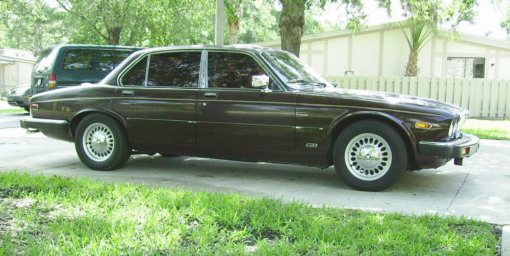

years ago I had window film applied to my '84 in a dark brown color, to match the body paint. It was done everywhere except the front windshield where a stripe was applied at the top.

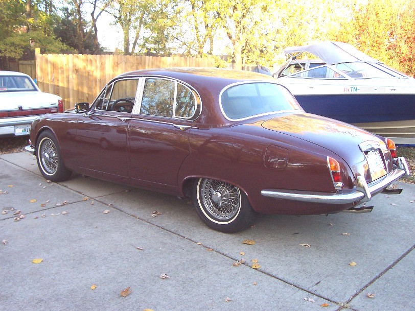

in my '65 S type, I had a light green film done because the glass was already factory-tinted in a light green, so it made it darker.

Jose, that XJ6 looks very very nice with that colored tint - good choice!

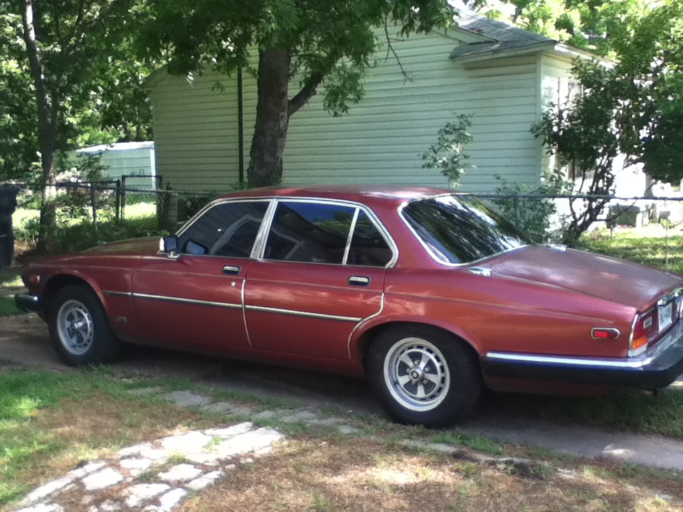

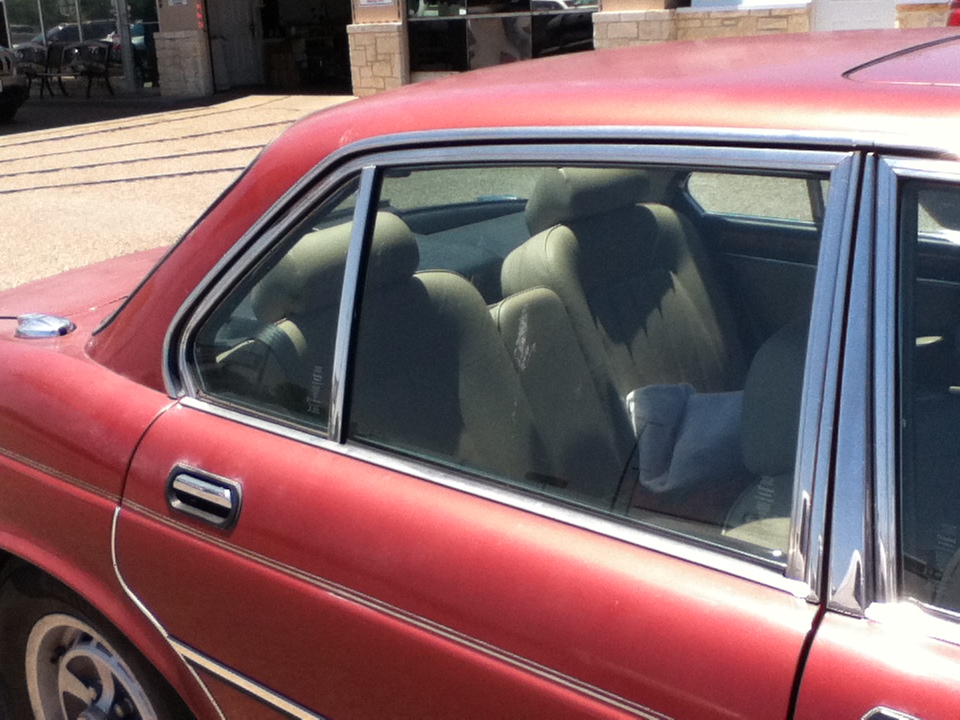

In preparation for a long Texas summer, I have undertaken a few "cooling" repairs:
1. the AC has been recharged, dryer replaced, etc. with r12 - blowing around 50-55F out the vents now.
2. old radiator was starting to run a little hot; pulling it out demonstrated why - rotten, disintegrating exterior coils in the corners were just started to impede performance - replaced with lighter, cooler all-aluminum model. coolant flush + thermostat replacement as well.
3. water pump developed a slight leak - didn't want to risk it on the road, nor the possible introduction of contaminants into cooling system - replaced.
4. Tint - 4" Brow, 33% on front, 25% in back and rear. The tint alone has made the car at least 5-10 degrees Fahrenheit cooler in addition to just looking better aesthetically in my mind. I am convinced that this will extend the life of my seats and dashboard and the other crackly interior bits. There is just so much less light and UV rays being directed on this old wood, plastic, and metal machine. before and after photos below.
