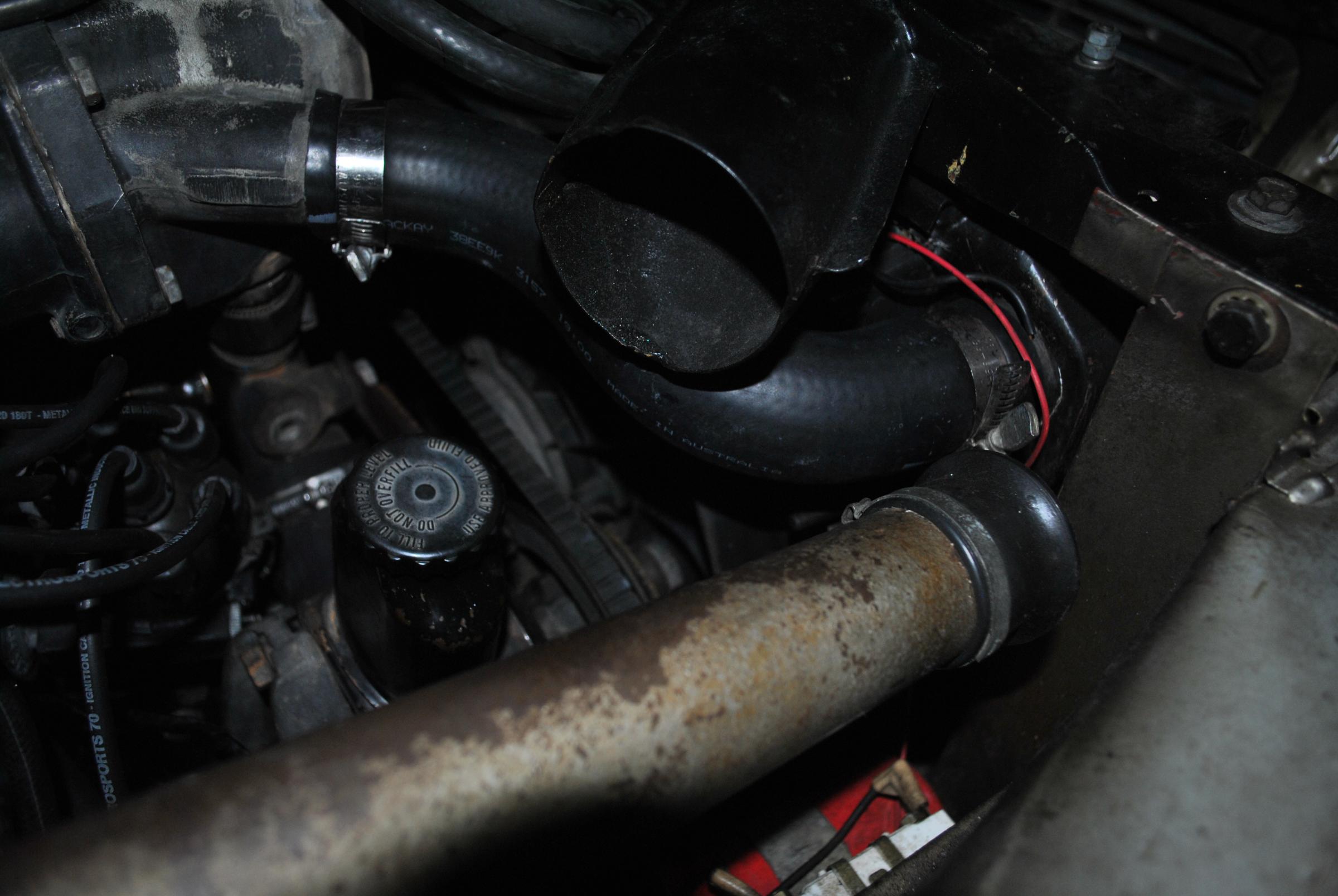

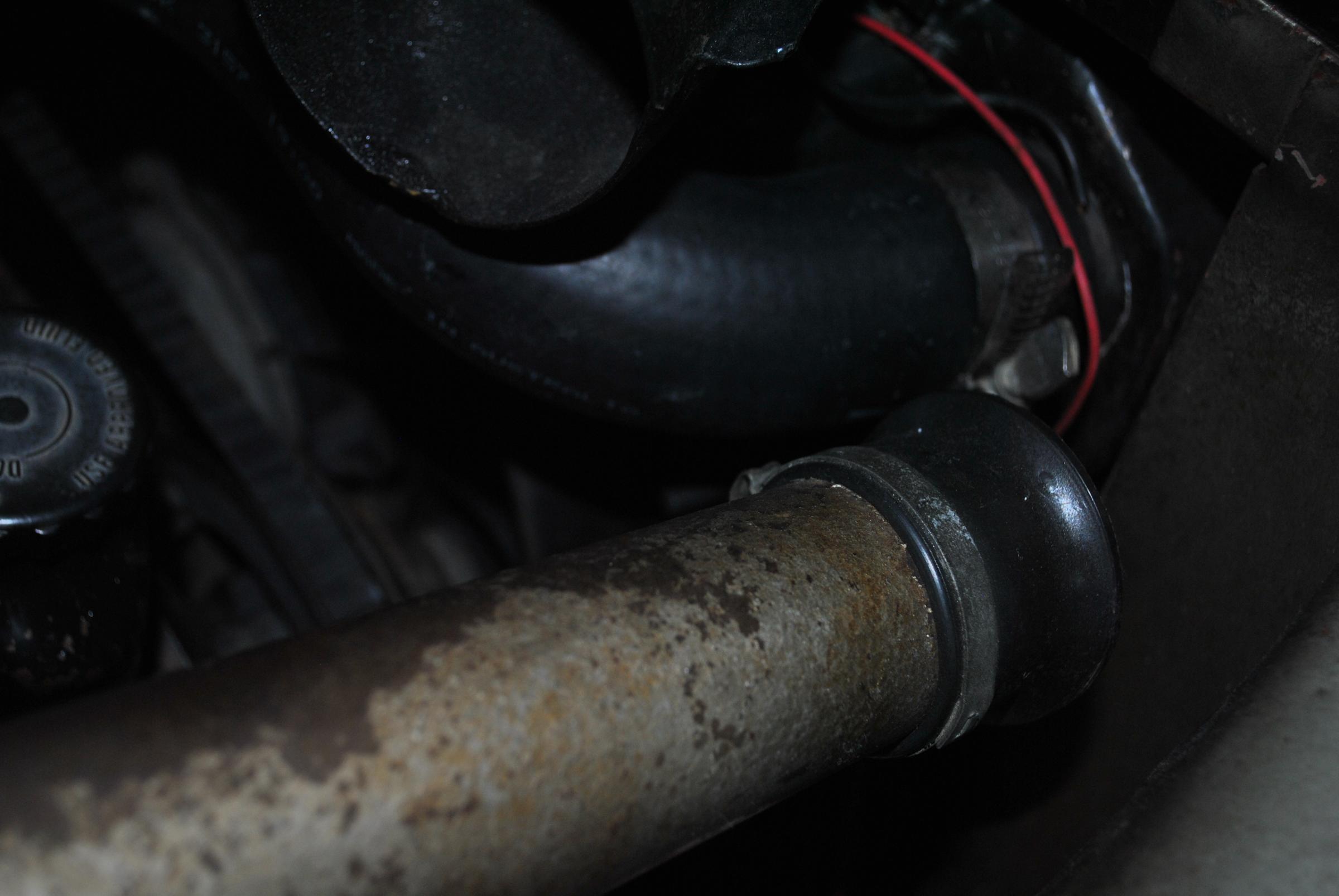

I had a radiator hose blow out on my way to work today(looks all of its 40 years). Gave it the cut and tuck hoping to make it home after work,got half way,which was 400m from a Supercheap Auto Shop.
No luck, we can order you one,about 3 bus days. So had a dig around in their huge bin of top hoses. Found about 10 that looked like they might fit,proceeded to the checkout and gave them my keys so I could take them out to the car to see what would fit. Girl at the counter said "silver Jag?". "It's leaking coolant all over the drive".
No brainer Sherlock. I'm the dude with an arm full of radiator hoses.....
Anyway, I found that the hose for.
(CH2196)
Top Hose
Subaru
Liberty
LX122
OEM Party no 45167AA020
Was a perfect fit,and $10 cheaper.
Probably better fit than the original I took off. Slipped on after 25mm(1") trim
