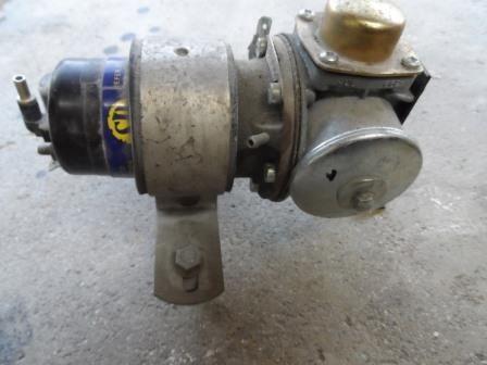

I have spent the last 2 months (on and off) trying to get the two fuel pumps on my series 1 working properly. The easy part was setting the points and getting the pumps to actually pump fuel and stop when the float chambers were full.
Now to reduce the risk of fire, I have part filled my fuel tanks (which I took out for inspection) with diesel fuel. The pumps work fine on this but I have been chasing a series of leaks - first of all the banjos, then the diaphragm on one pump, then then one of the fuel hoses. The leaks are now very much reduced except for a very slow leak from the surge chambers.
I have made now paper gaskets for these (the bell part on lower right of photo), but there is still a very slow weep from both pumps.
I am going to try a different type of gasket paper next, but the question I am now asking is "does diesel fuel leak more easily than petrol?" ie., if I run petrol through these pumps, is it less likely to pass the gasket?
I cannot seem to find new gaskets available for the surge chambers, and it does not help that the seal depends on one central screw.
(the photo is not one of my fuel pumps - am using it for illustration only)

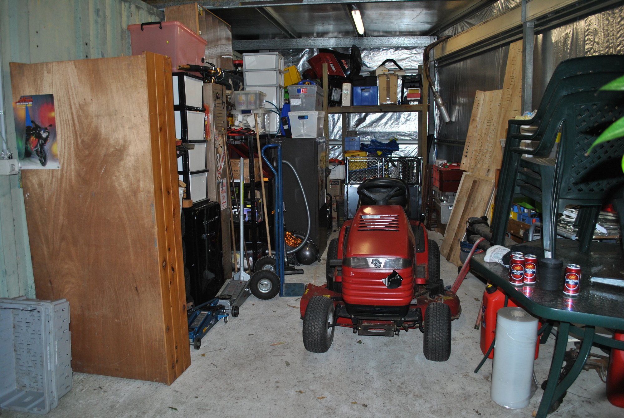

Any excuse to take a 120m stroll down to the temporary shed while I wait for "The Monstrosity" to be built (as her indoors has named it)
The hardening one is No.4, so looking for No.3 you won't go wrong. And a shameless plug for the forums.
The bottle in the pic is at least 8 years old, a bottle of this stuff lasts for ever. It has built 4 bikes and a seriies 1 XJ6.
