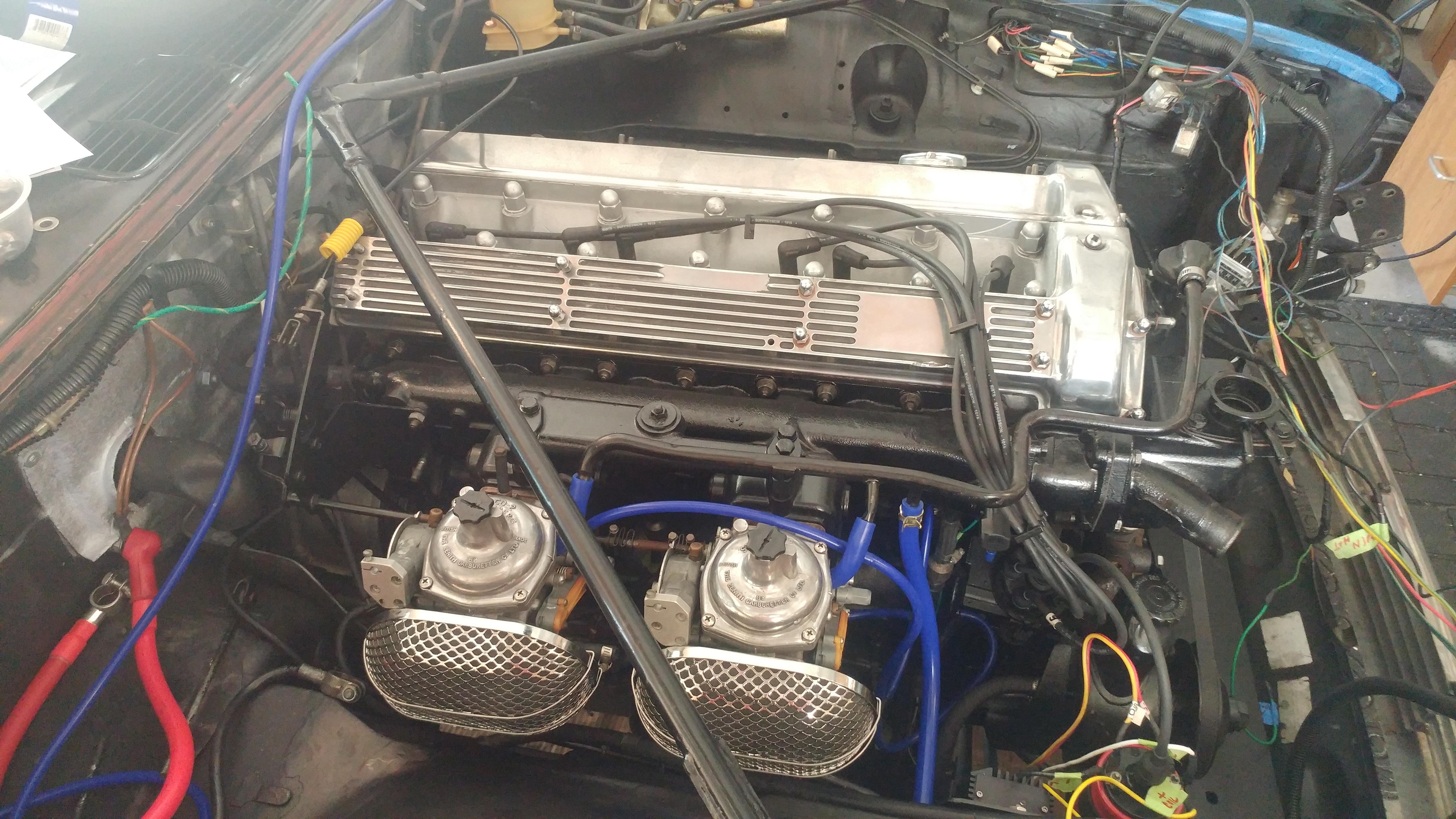

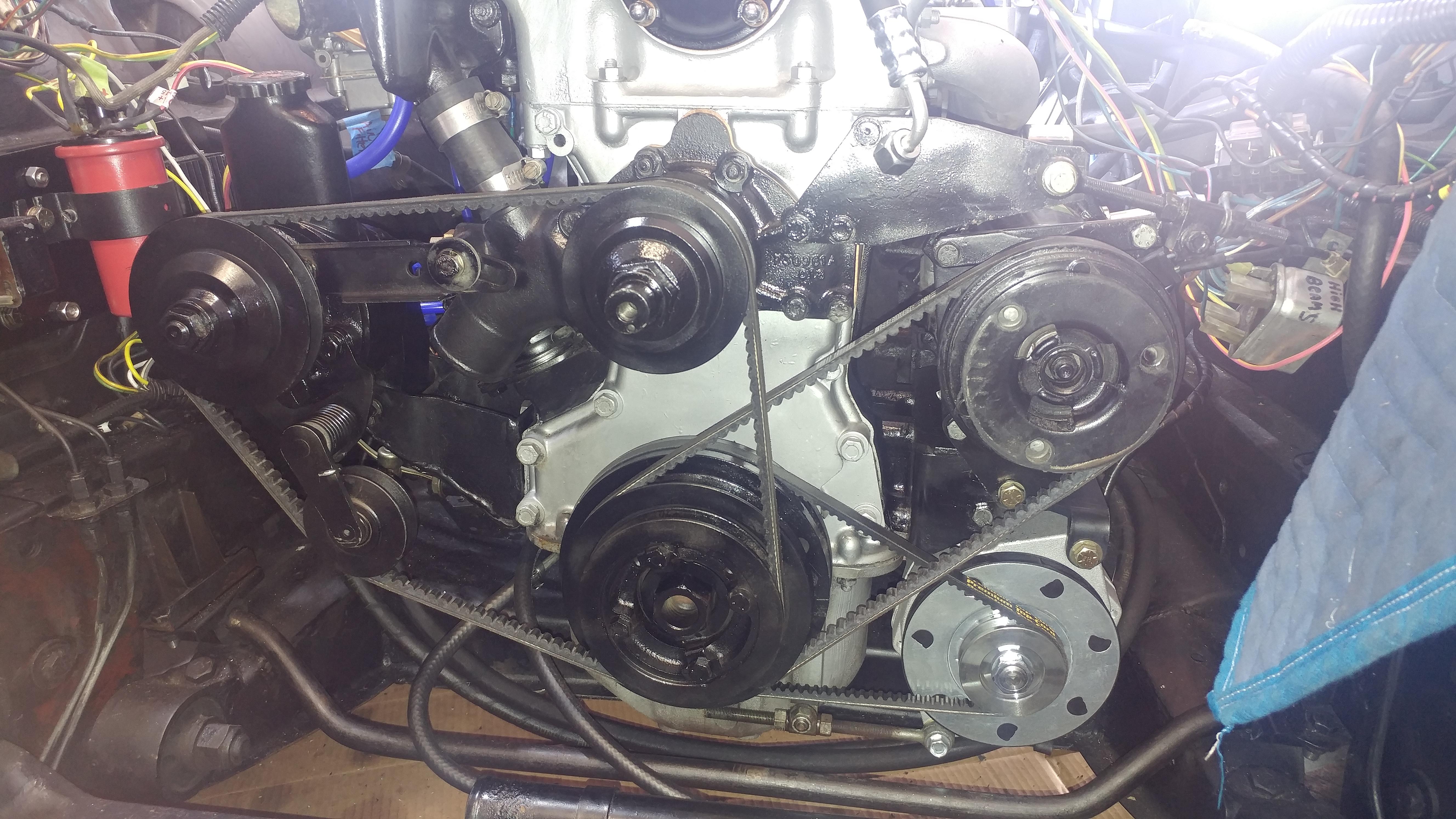

Update on my project - Have decided to go the route of two 14" puller fans and do away with the mechanical viscous fan. Pic on that will follow. In light of that went with 94amp JohnsCars bracket and GM alternator, rebuilt GM A6 A/C compressor, new water pump (sans fan) and rebuilt power steering unit and all new belts. Did away with stock air cleaner and went with nice chrome oval air filters, and... did away with the A/C fuel cooler plumbing and routed all low and high pressure hoses over to the drivers side. Much cleaner! Again pics will follow. I'm on the home stretch now.

Pics attached
Attached Thumbnails XJ6C Cleaning up engine bay-new-ancillary-equipment.jpg   XJ6C Cleaning up engine bay-0221180741a-2-.jpg
