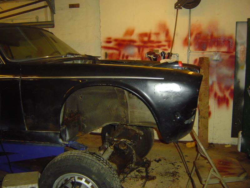

I'm starting my next XJC renovation. I was looking for some Coupe parts when I came across a complete car. The seller was parting it out becasue he thought the car was too far gone. I asked him for a price on the whole car he said 1000$ I cheakily offered 500$ and we quickly settled on 900$. This coupe starts out much better overall, more complete and less rust than my first XJC. The car is a 1975 and had a V12 with the Borg Warner 3 speed. The V12 ran but had water in the oil.
Shortly after the coupe arrived... I purchased a 1994 XJ12 sedan to use as an engine doner sight unseen for a very low price becasue it was apart and not running. It arrived with a beautiful preserved interior. I got it running and fixed a leaky oil cooler. That vehicle had the 6.0L v12 but I didnt find it all that powerfull or that smooth to warrant the swap effort. The transmission gearing wasnt right and I considered the 1994 XJ12's powertrain setup wrong for the sporting coupe. Considering the car was so nice too I couldnt bring myself to break it so I sold it for slightly more that I paid. The new owner loved it and was so happy with it.
So I've removed the milky v12 and this week I'm preping the engine bay for paint. I considered many engine combo's including a 1994 V12, 1995 AJ16, old XK6 and I settled on a LT1 + 4L60E. This project is being driven by the notion of Grace, Pace and Space. The mild LT1 with 4l60e power train should offer Grace and Pace. LT1's are far more refined than other early SBC's. This coupe is also getting ABS and traction control too. Other upgrades in the works include using a XJS late style ZF rack and modern sound control measures. The interior is going to be tan...so it's classic black and tan.

The front suspension is being sorted out and put back on the car today. Then the mild LT1 will be going in later this week. I've spent the last few weeks cleaning the suspension parts, rebuilding the LT1 and aquiring the necessary parts to complete the conversion. After the engine is in I'll send the drive shaft out to be cut to length and focus on replumbing the front brake system while I wait. This car is getting a complete 4 fluid channel ABS system with tracktion contol from a doner Corvette.
