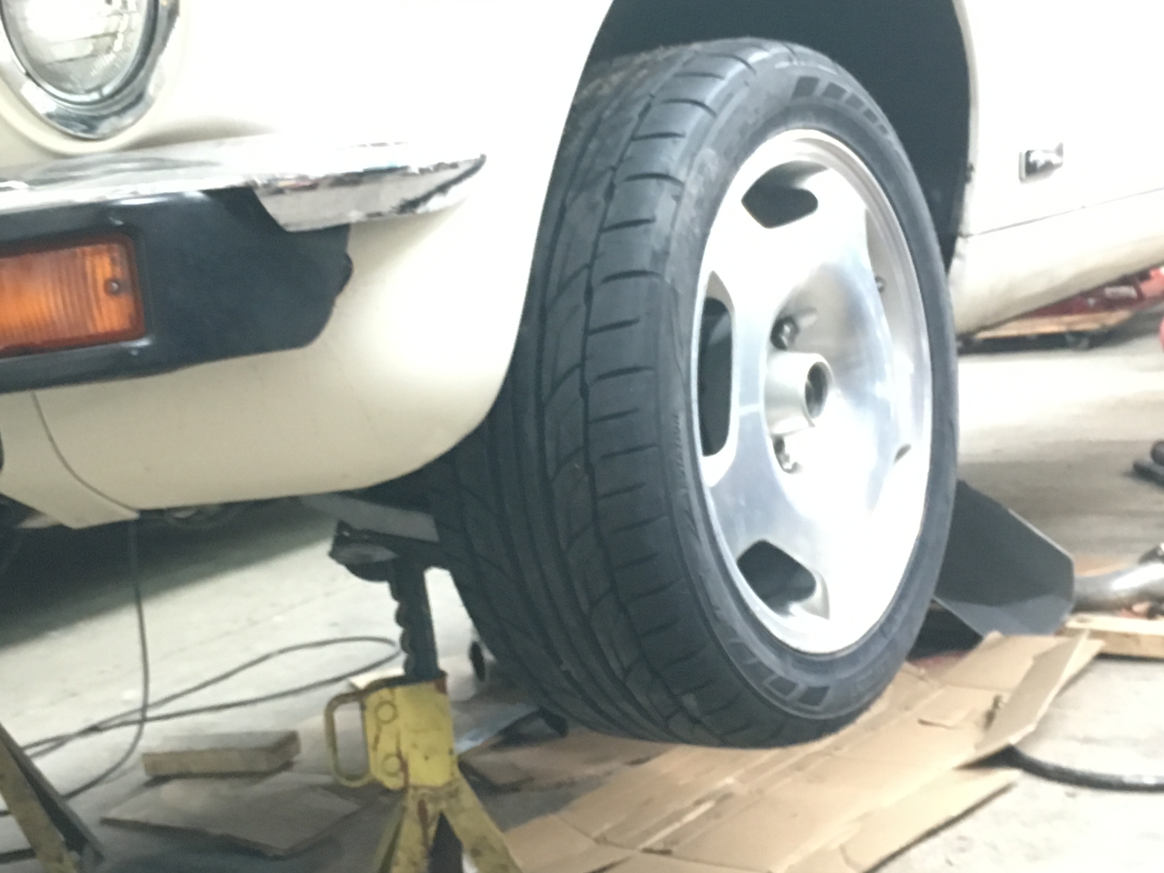

Fog,
They just fit. They clear the snubber, rolled the rear fender lip, might have gotten away without the rolling.
Shod with the latest Nitto 555G2's - 245x45x17
Attached Thumbnails XK8 Wheels fit?-img_3220.jpg   XK8 Wheels fit?-img_3224.jpg
