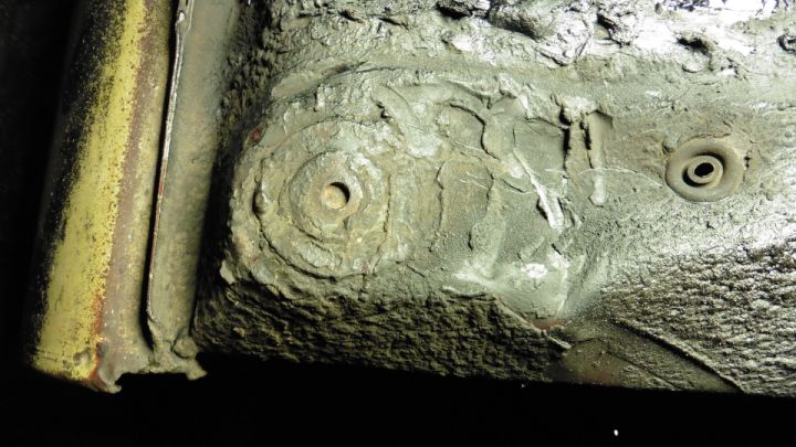

The first time I crawled under Nix I noticed right away that a previous owner had run over a Blinkin' Big Rock at some time in the past and rolled the car over it, Massively denting up the floor pan the entire length of the left side of the car just inboard of the sills.
There is a dent in the front portion between the drain and the remains of the jacking point like a grapefruit hit it (but I'm sure the rock was bigger than that), a deep gouge in the steel, and the drain is tilted all wonky. In the process that person knocked off the jacking stud at the left front. (You can also see by the picture below that the car was originally Yellow [gag]).
Before the floor adventure is finished that all has to be addressed because up till this time there was no good way to raise up the car on that corner. There are marks in the undercoat where shops have put their lift pads in that spot quite correctly, but they can't be blamed when there was no proper stud.
It was raining pitchforks and hammer handles yesterday and husband was feeling energetic so he got a tiny wire wheel on my Bosch (cordless drill) and took all the undercoat off that area. Now I can see Exactly what I'm dealing with.

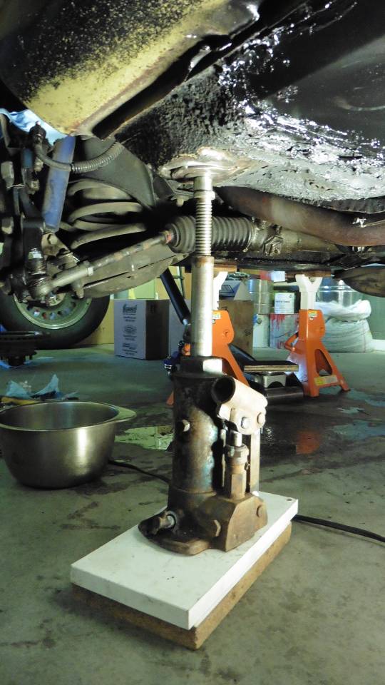

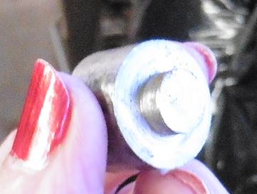

This was the plan: that hole is 3/8 inch ID; he had some 3/4 inch OD round stock, from which he previously turned a piece 3/4 inch long with a tang that Just fits into that hole, but has a head like the stock jacking studs.

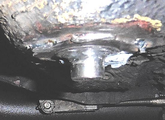

I decided the new stud he turned can be welded to the remains of the old point rather than trying to weld an entire now part to the car. That part of the body seems to be quite strong and I don't think we'll improve anything by adding layers and there's always the danger of burning through and making things worse.
The new stud was held in place by putting a jack under it to press it firmly to the body. I wrapped the jack (except for about an inch of threads for the grounding clamp) so that splatter wouldn't ruin the ram.
That all seemed to be the simplest, easiest way to fix this. However, someone thought it would be a good idea to put some more tacks on the outer margins of the original fitting. I had hoped to avoid true overhead welding but I was overruled. I had also thought the new stud could simply be tacked to the existing structure in a couple or 3 places but that got overruled too.
As you can see by the pictures below, this thing is Not going to fall off any time soon -- although it might break again if someone runs over another Blinkin' Big Rock.

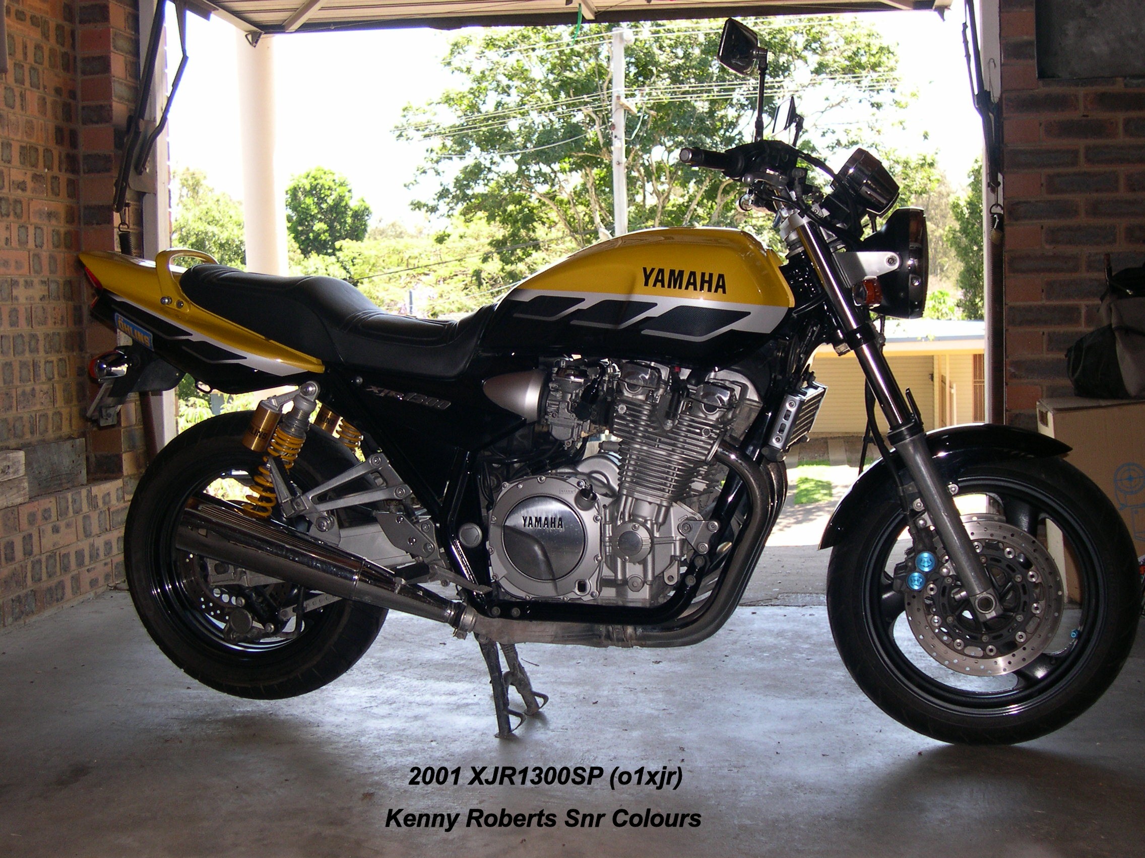

Yellow grows on you, here is a couple of Primrose Jags that were for sale here recently.
I have had a couple of Yellow bikes, got used to them after a bit.

I cleaned up the jacking stud yesterday. It was quite a mess after welding; so much so that the jack stand adapters wouldn't fit properly.
However, with judicious application of a cut-off wheel and a chain saw file it looks Much Better. Not only that, the adapters now fit! Bonus!
Attached Thumbnails Yet Another Floor Pan Adventure FAQ-repairedstudbeforecleanup.jpg   Yet Another Floor Pan Adventure FAQ-repairedstudcleanedup.jpg
