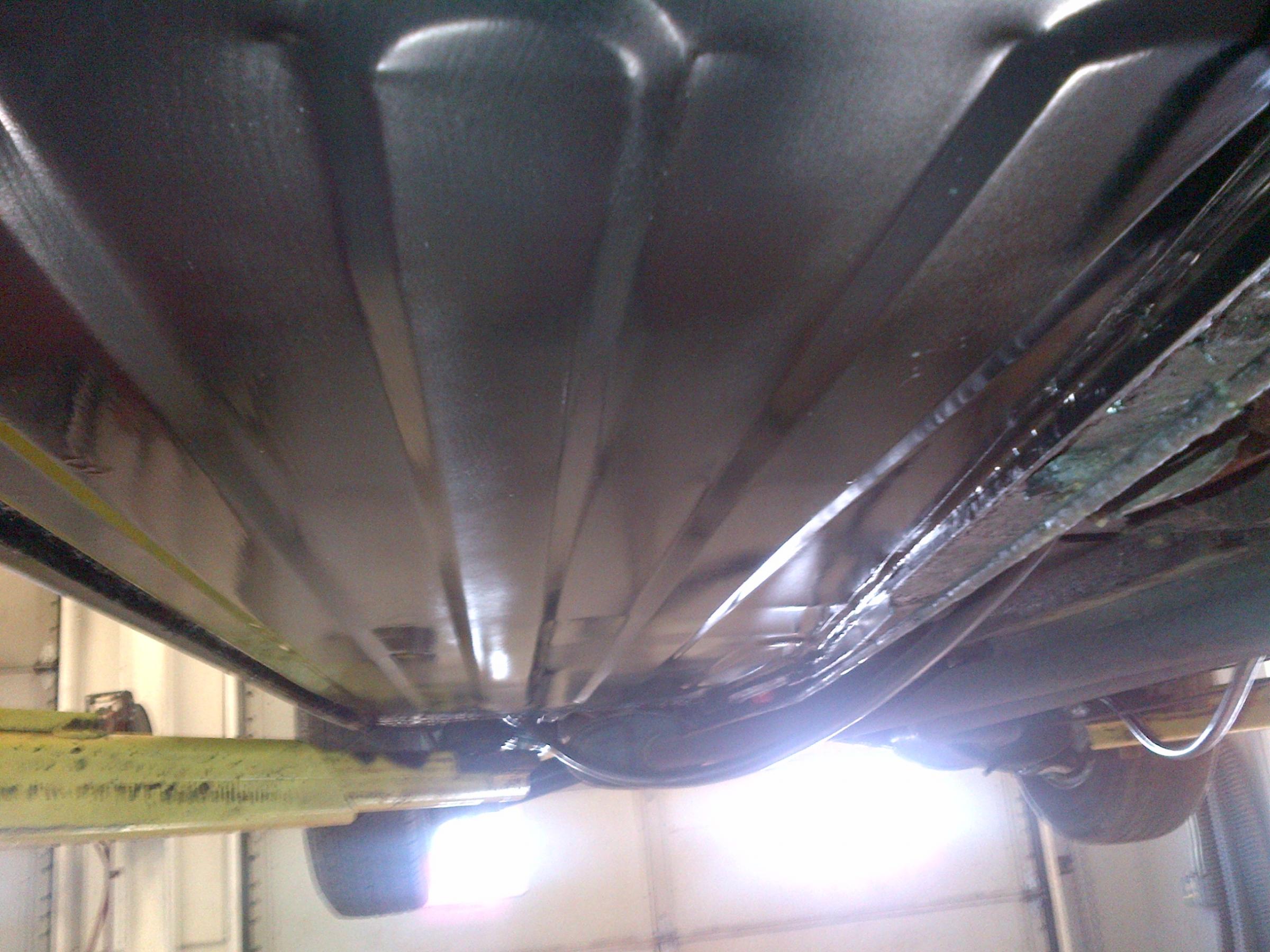

Floor pans are all done. Seam sealed and a final coat of paint on them. Now I have to move on to the front fender area!

Very nice, Myke!
Yes, Very nice indeed!

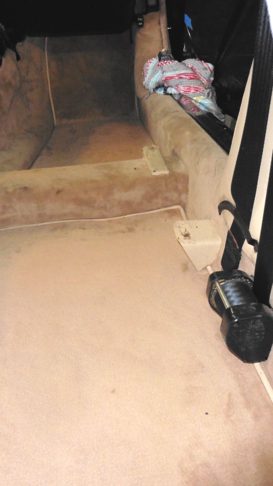

I'm Finished with the floor and all the related rust and corrosion remediation.
I got all the carpets in, *Correctly* which they weren't, probably since restoration/conversion in 1986. They All fit! There are no lumps or rolls, wrinkles or bunch-ups where someone was not careful enough to get it right the first time. The stainless steel sill plates are back in their proper places too.

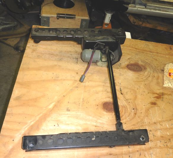

The driver seat had an electric seat adjustment contraption that was never connected to power and weighed a Ton! It raised that seat 1-1/4 inches but was such that there was no reasonable way to get that seat in or out. I got the idea to jettison the whole assembly and put in 1 inch spacers under the seat rails to give me the height, but lose that 25 pound adjuster.
In so doing I lost those poorly thought out hex-head bolts which were nearly Impossible to remove (vise grip required as shown below)! I have 5/16 coarse custom fabricated slotted head bolts in them now, which allow the seats to go in and out in a snap, only needing a screwdriver and box
wrench! (yes, they've had more than one trial fit.) But both seats are cleaned and installed in their proper places.
I'm glad I did this, because otherwise I would have had Serious rust/corrosion trouble before very much longer, possibly compromising the structural integrity of the whole car. However, I Never thought it would take this long! It might have gone quicker if I'd had any idea what I was really doing.
The most stressful part was welding because after that there was no going back; it Had to be right the first time. Fortunately it was, but I hope that with all the anti-rust treatments, not only on the floors but everywhere else I could reach, I Never have to do something like this again! Certainly it won't be needed on this car because before that time I plan to completely use it up!
This ends my Floor Pan project. Thank you all for looking in during this Adventure.

I'm feeling inadequate now. The bottom of your car is shinier than the top of mine. Never mind , other priorities at the moment, of to the garage to determine why it will not start :-)
Well done on your work, it looks better than new.
