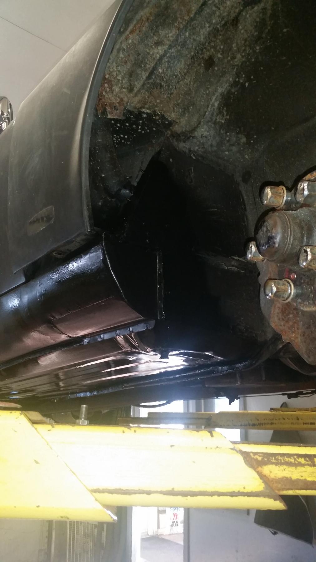

Floor pan is all welded in, epoxy primed, and then given a coat of rust paint. Once that dries, we will apply the seam sealer the top and bottom seams. Then, a little trick from my GTO tickle trunk...we will spray a pick up truck box liner into the inside floor pans to protect it from any moisture, and we will spray a mixture of diluted tar on the underside to give it the factory look.
Note what we have affectionately named "the box" which is the area between the footwell and the inner fender, along the front rocker panels. We had some rust issues in there, very common as a result of the water drain tubes. We cut out any rust and welded that up as well. Its been epoxy primed and painted inside the rocker to prevent recurrence of damage. Once that is dry, we will saturate the inside of the rocker with Rust check, using the access holes in the inner rocker sills.

LNR: There should be no need to drill holes in your inner fenders to get rust protection into your rear quarter panels. Simply pull the back seat out, and it will expose factory access holes that you can use to spray corrosion protection into the rear panel recesses.

Myke, thank you for the Heads Up about those access points to the rear inner fenders!! I'm adding that to my list this very day!

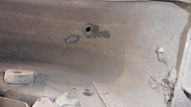

Anyway, back to the access holes, there is a 'vent' for lack of a better word, in the very top of each rear wheel well. I could easily stick the snoozle in and soak the inner fenders with corrosion block. I was pretty sure I had enough in when it started running out the seam at the rear of the door and dripping off the lower inner fender flare just ahead of the gas tank.
Picture below:

Hi LNR:
I have attached a picture of the holes on a series III. Not sure if a series II has them. I thought they would be similar. There is an access port on the bottom of the wheel well where it meets the seat floor for wiring, and a large one above it that is taped off. I just removed the masking tape, and I can see the entire inner fender.

Oh, There! On the side wall!
It may very well have that but I can't get to it anyway. There's Leather glued all over that part and they did a Really good job, not like some things they glued down which I can simply pull off!
It's OK though because I'm pretty sure I got everything treated that really needed it.

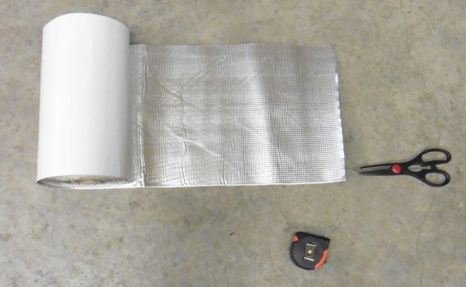

Default B-Quiet!
This stuff is FUN!
I ordered it on Roger Mabry's recommendation; turns out it's a Canadian product, comes from Lethbridge, Alberta! That's just a short way North of where I grew up!!
It also came 2nd day International FedEx! What a deal!
Anyway, it's quite heavy, as in, it weights 16 pounds/50 ft. roll, which is 12 inches wide. The top is a heavy weight waffle pattern aluminum foil bonded to a sticks-to-Everything rubber backing which in turn is covered with a heavy paper.
It cuts easily with scissors while the backing paper is in place and with a razor knife from the foil side when the backing paper is stripped. It works Very easily and it sticks to Everything (as mentioned), even less than squeaky clean surfaces.
Best of all, if you get it wrong, just Jerk it up quickly and it lets go if you haven't let it set long enough to actually bond to the surface. It Really likes to stick to itself!
If you encounter a raised obstacle of some sort, it's easily cut with a razor knife.
Roger posted pictures of it in his car earlier in this thread, post #6, so you can look there as his is a much better job.
I took the back seat out earlier in search of rear fender access so I'll put this B-Quiet on all surfaces there, and take up the rear carpet and put it on the rear floor.
