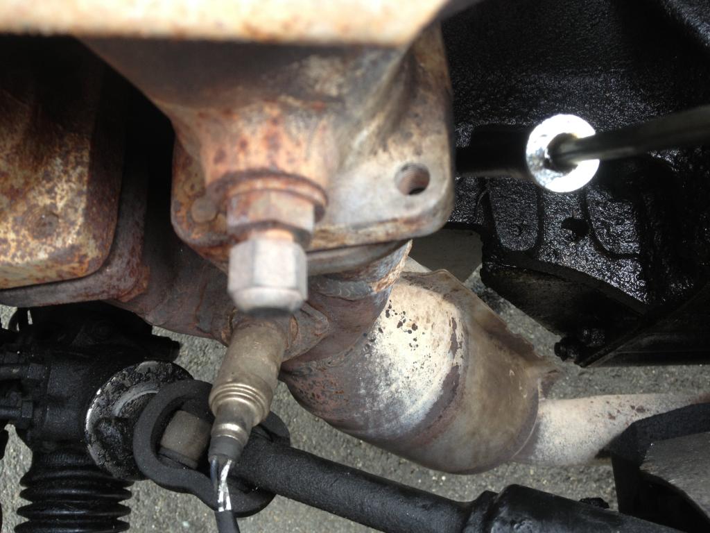

Well I did the "hammer test" on the cat and all seemed to be well nothing moved around in there and there seems to be pretty good pressure coming out of the rear pipes. I did notice that the cat installed on the car does not look OEM because of the welds and the way it bolts up to the manifold. Is it possible that a "crappy" universal was installed and could be doing anything?

The cat on the engine below the manifold "Looks" stock to me. (NOT an expert.) Did you bang on the cat farther down the line. My series three has another converter just behind the transmission that splits off to both forward mufflers.

Just saw the video - and yes, my first thought would be clogged exhaust... but I know how hard that is to verify. Honestly - I would go with Doug and seperate the cat where it connects to the manifold. It is really NOT that hard. 4 bolts, (Both sides of the Cat for both sides of the manifolds - 8 total.) the inside/aft (Behind the cat, and close to the engine) are a little tricky, but as long as they are not rusted too badly, they should come free. USE WD-40 or something similar. It will be loud as hell, but you will know in an hour if you have an exhaust issue or a fuel/timing problem. If the bolts wont come, strip them and/or break them - they are easily replaced, as well as the exhaust gaskets (Donuts) between the cat and the manifold.
