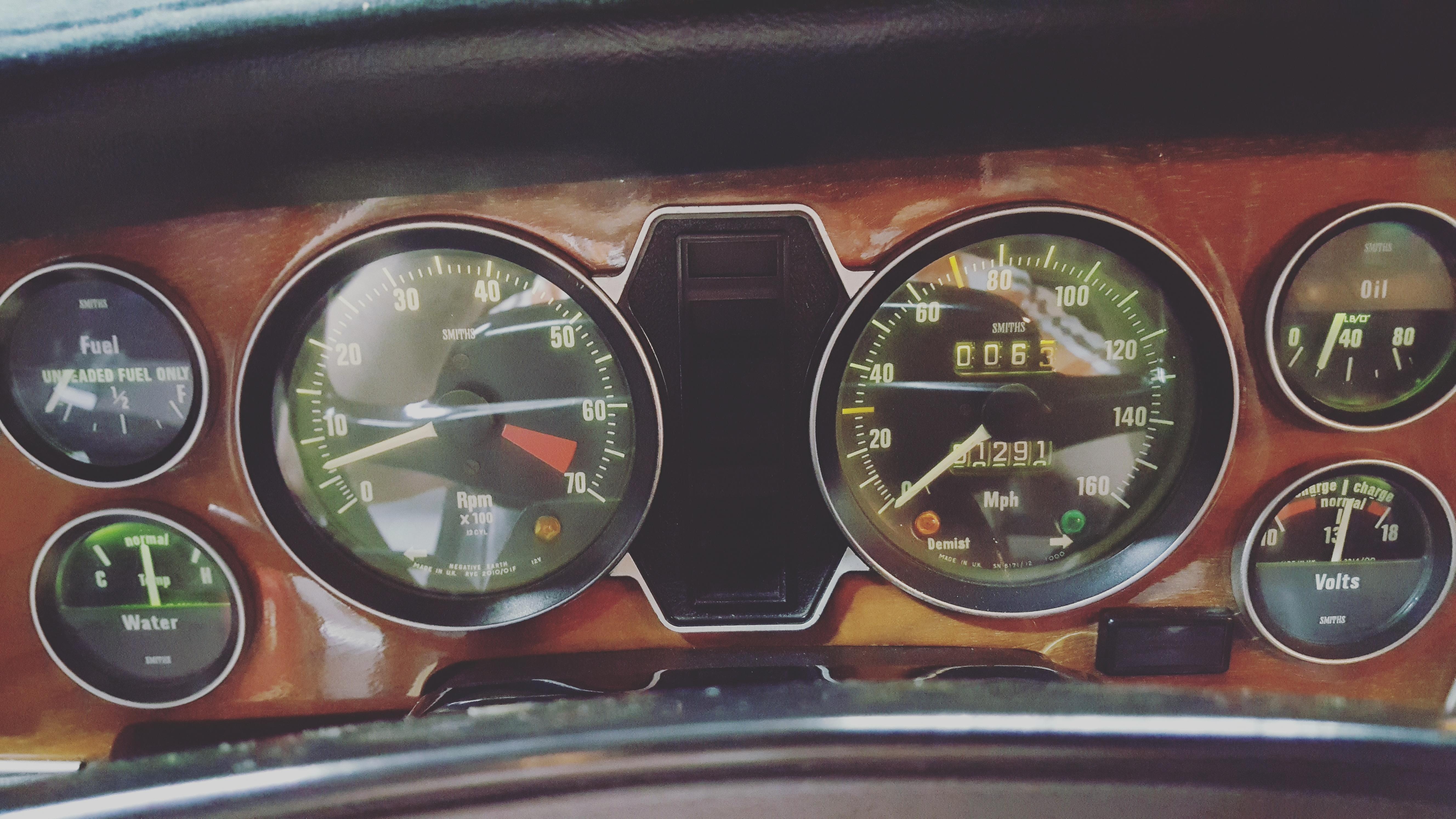

After fitting another new fuel pump (after installing a fuel filter before the pump) I finally got stable fuel pressure.
The car covered a staggering 6 miles and was running continuously for 30 minutes. Temps were good, oil pressure and voltage were good.
Tomorrow I will set the fuel pressure correctly and I am hopeful that will give us stable enough performance to go try for SMOG.
It's been a good day....

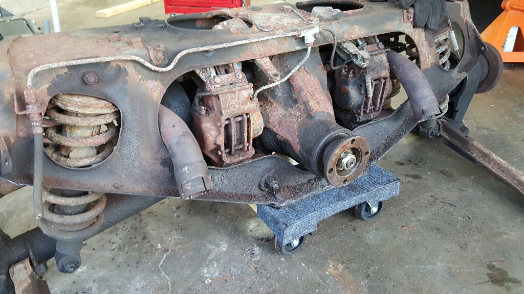

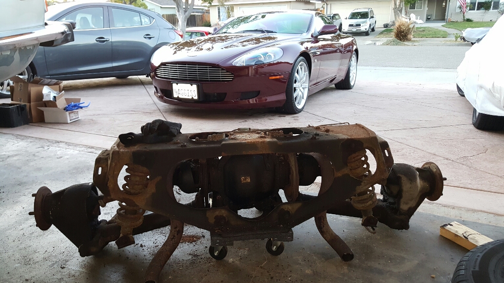

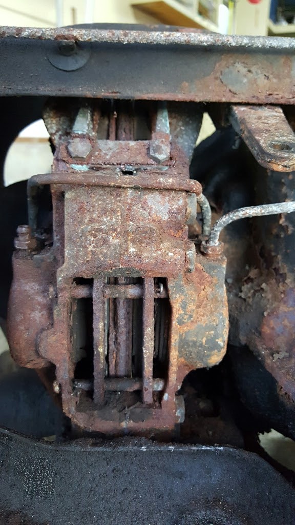

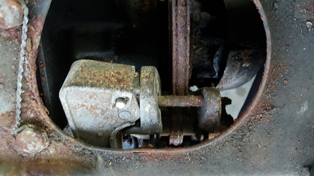

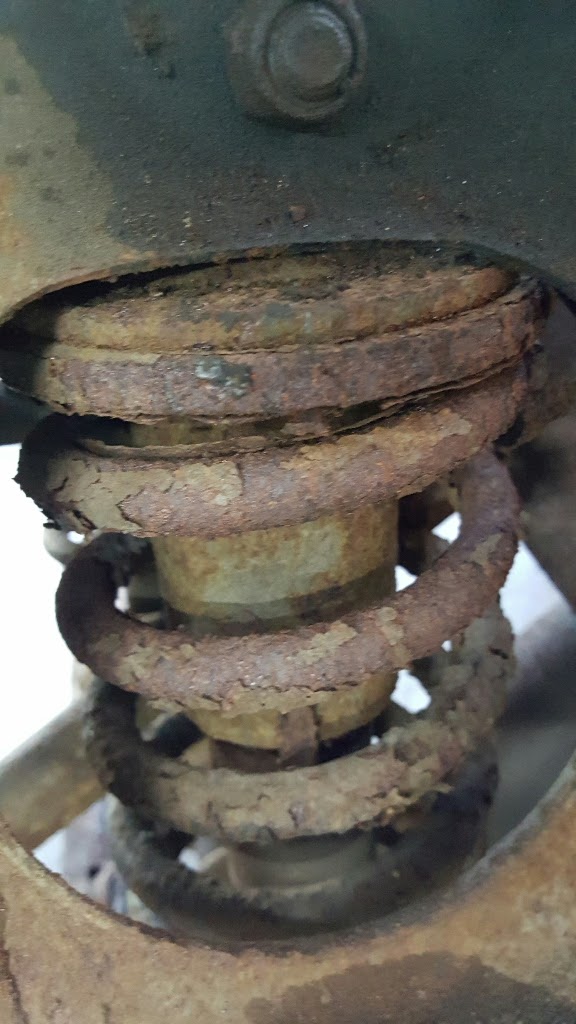

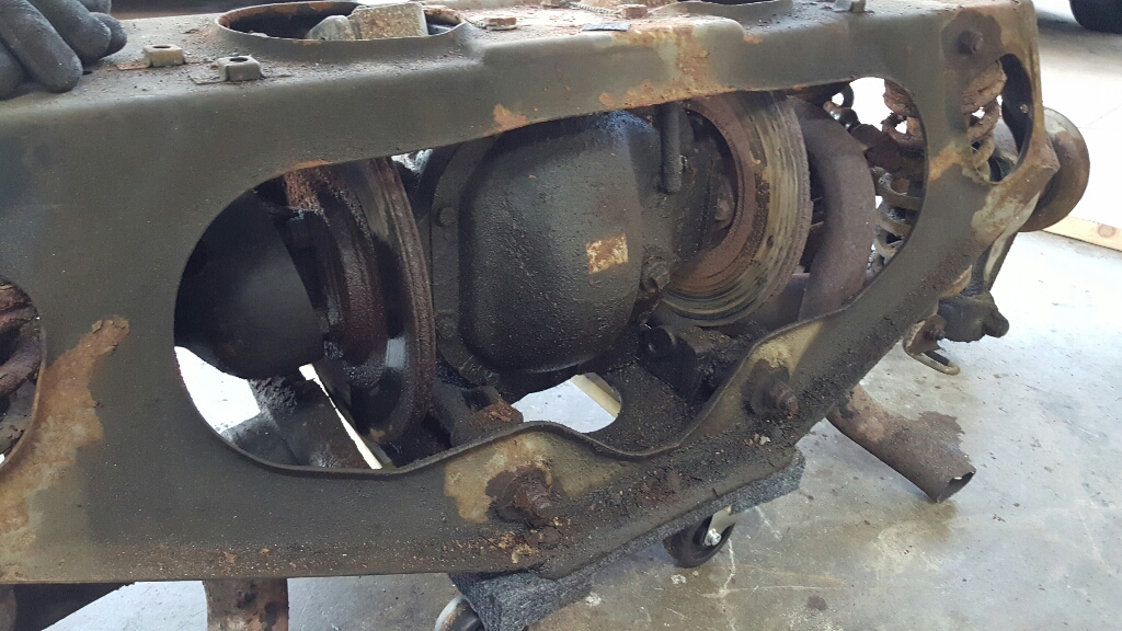

So.... We couldnt go for SMOG because we didnt have rear brakes, and the cage needed to come out anyway, so..... today was rear cage removal fun and games.
The only thing that didnt go perfect was the rear mufflers would not seperate from the up and over pipes, such was the corrosion at the joint. Eventually we had to cut them to get the cage out. They were blowing a bit anyway so would probably have had to be replaced at some point.

Admittedly my experience with these things is limited, but that's a Mess!!
I wonder why you didn't have rear brakes? Sheesh!!
Rhonda, my wrecking yard IRS, looks Considerably better.

Agree it's not pretty. The reality is the corrosion is only surface rust on the cage itself so it will clean up nicely. We will replace all brake parts, including the lines. We will also do the shocks and springs. Diff will get flushed and refilled only. It appears to be the correct one as it is tagged "PL" which we believe signifies "PowerLock" or LSD.

A bit crusty, but, a power wash session can do a lot.

Agree. It's probably the worst part of the car. The car was driven once in snow, and although it was "thoroughly washed down", it appears it wasnt cleaned above the rear cage, and the result after 20 years is what you see. I have already degreased the cage and it looks 1000% better than it did. Now for some POR15......
