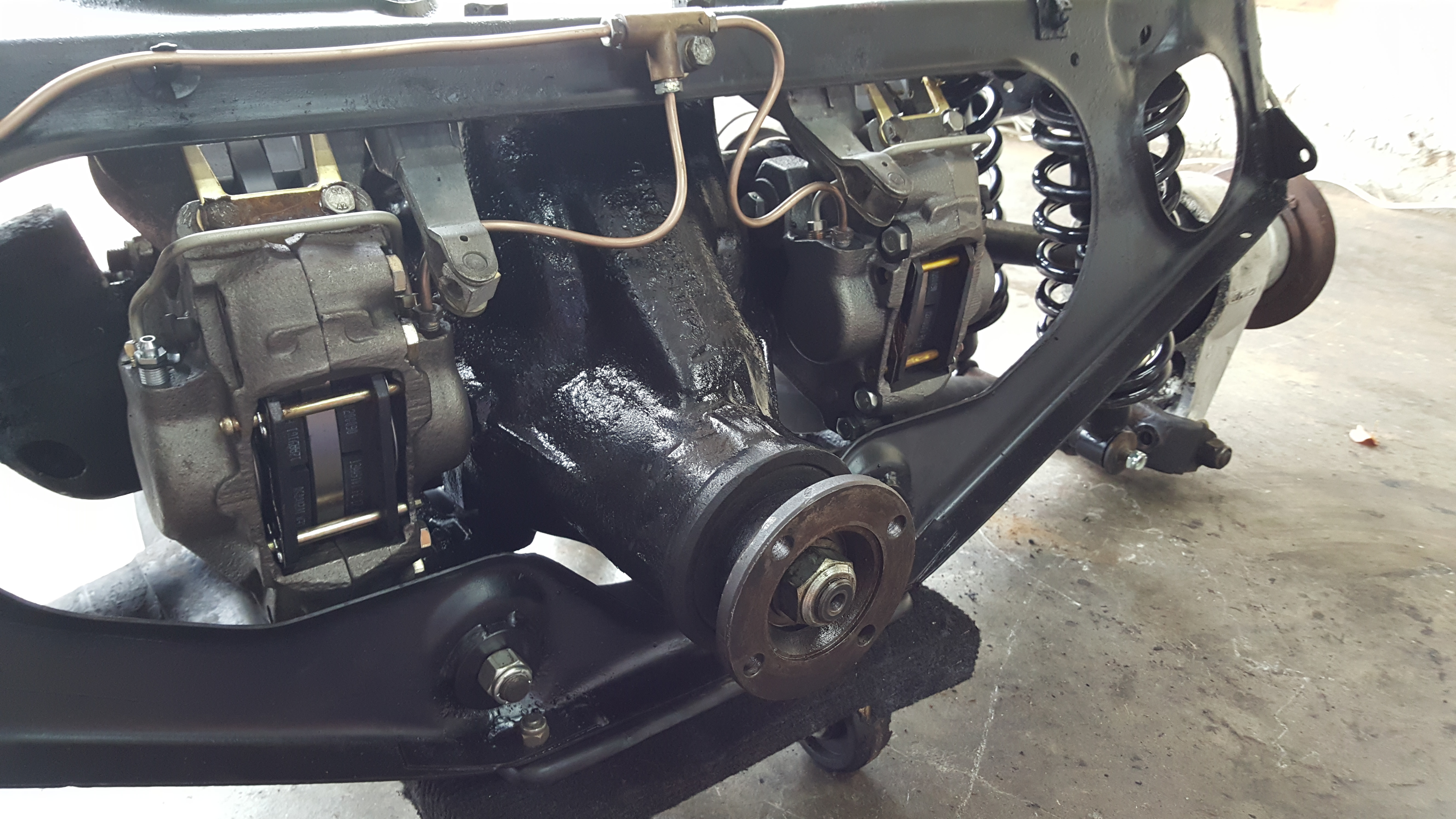

I persuaded sarc to remove the differential and the control arms so we could clean everything.
it's now ready to be reassembled. today was a successful Progressive day.
Yes, SARC wanted to do a "botchit and scarper" repair, but, taking things apart further allowed us to really get everything clean. We used purple power degreaser and one of these :-)

The rust on the cage was very minimal, so after cleaning we painted it with rustoleum semi flat black. The diff got the same but in shiny black just for kicks.

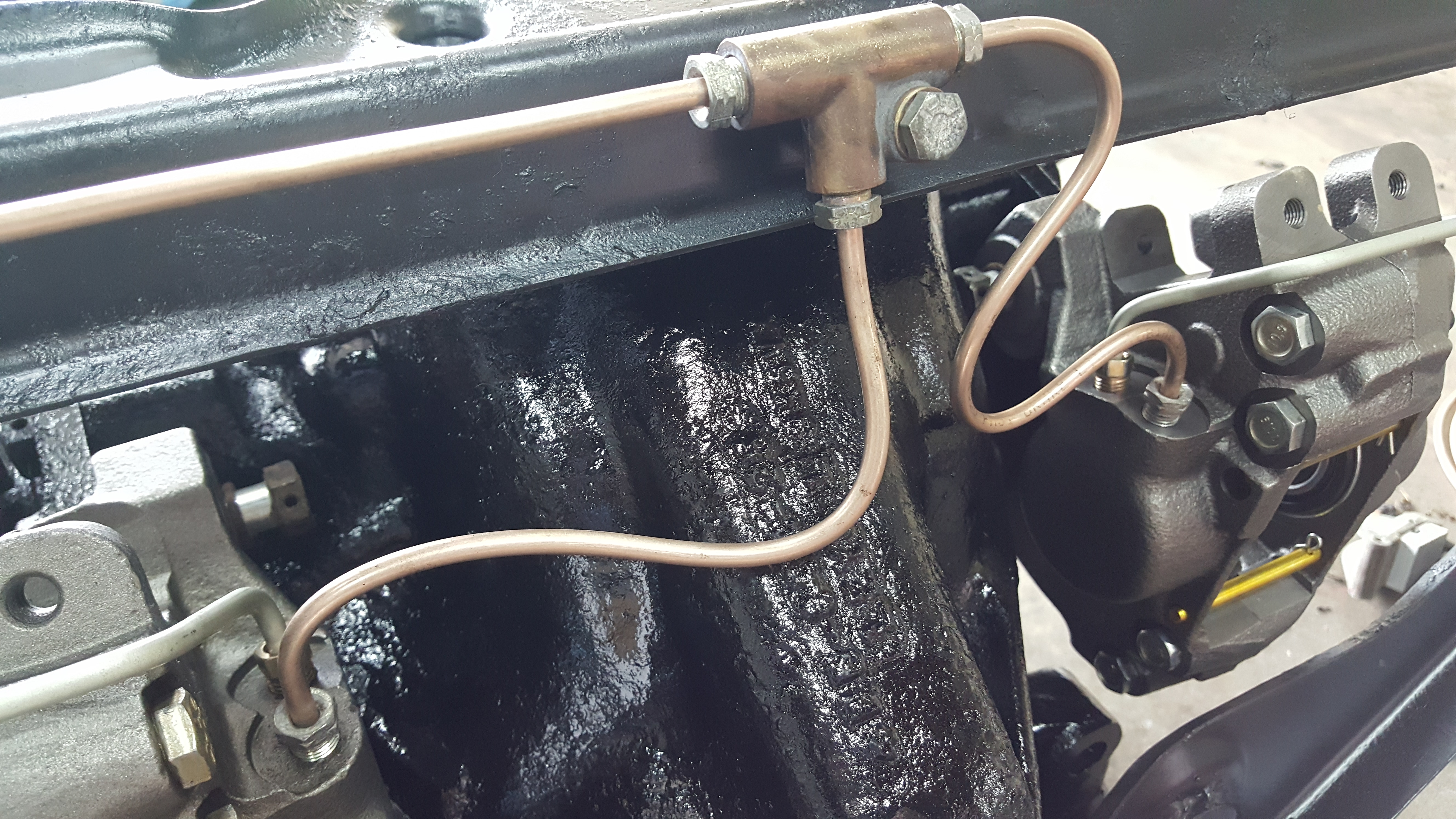

We are all set for reassembly. I ran new brake pipes today...... a very rewarding job.

I find with copper brake line it's soft enough that it will deform slightly to fit any imperfections with the fittings. I havent had a problem so far. We will be able to hook up the flexi with the cage still on the ground so we can pressurize the brakes to check everything is not leaking before we bolt it all back in
I don't mean to argue, but merely to understand.
I put copper cooling lines from a transmission to radiator once for the same reason, but they work-hardened and broke off at the trans fittings leaving me by the side of the road at the end of a trail of transmission blood.
Wouldn't copper brake lines do the same (with possible disastrous results), even though those you show are short, but under much greater pressure? Not right away maybe, but quite unexpectedly and giving you a nasty surprise?
This stuff is made for brake lines........that's it's one and only purpose. I've been using it for 27 years with no issues. . The only thing it can't do is flex in any way on the application, otherwise it will fatigue fracture. I would not, for example use a single piece of line from a transmission to a radiator, because for sure that line will move in use (and fracture as a result)
AHA! Thank you for this explanation and the link. This is exactly what I needed to understand.
I didn't know copper was available for brake line applications. I'll keep this in mind for the next time.
Originally my trans cooling lines were steel, but they were such a bear to reinstall without crossing threads that I used copper because it conformed to the fittings better. After that disaster I put the steel back and just fought with it.
Thank you for taking the time to explain this to me.
Me, too. but, I got to thinking about it. Coppers differ. Not the soft
l[plumber's copper, a tougher kind. Nickel included.
Way back when copper was used in short stretches as fuel lines.
Then others came in and "nixed" it. Note, no cap!!
Disturbing molecular structure "work hardens". Take a chunk of coat
hanger wire, bend it back and forth in the same place, it will harden and become brittle, keep at it and it will part.
Annealing is the name of the process used to undo the hardening.
And, fittings. yeah, on installing the "lump" the new lines at the rack weeped. Tubing wrench and son's strong fingers stopped it.
Same when I swapped in a new Ps hose on my Jeep. Better access, and I tugged hard til it stopped weeping.
When I was rassling the old tech water heater, it took hard tugs
on the gas lines to stop a seep. No room for error there....
It seems endemic to flare fittings..... wherever found.

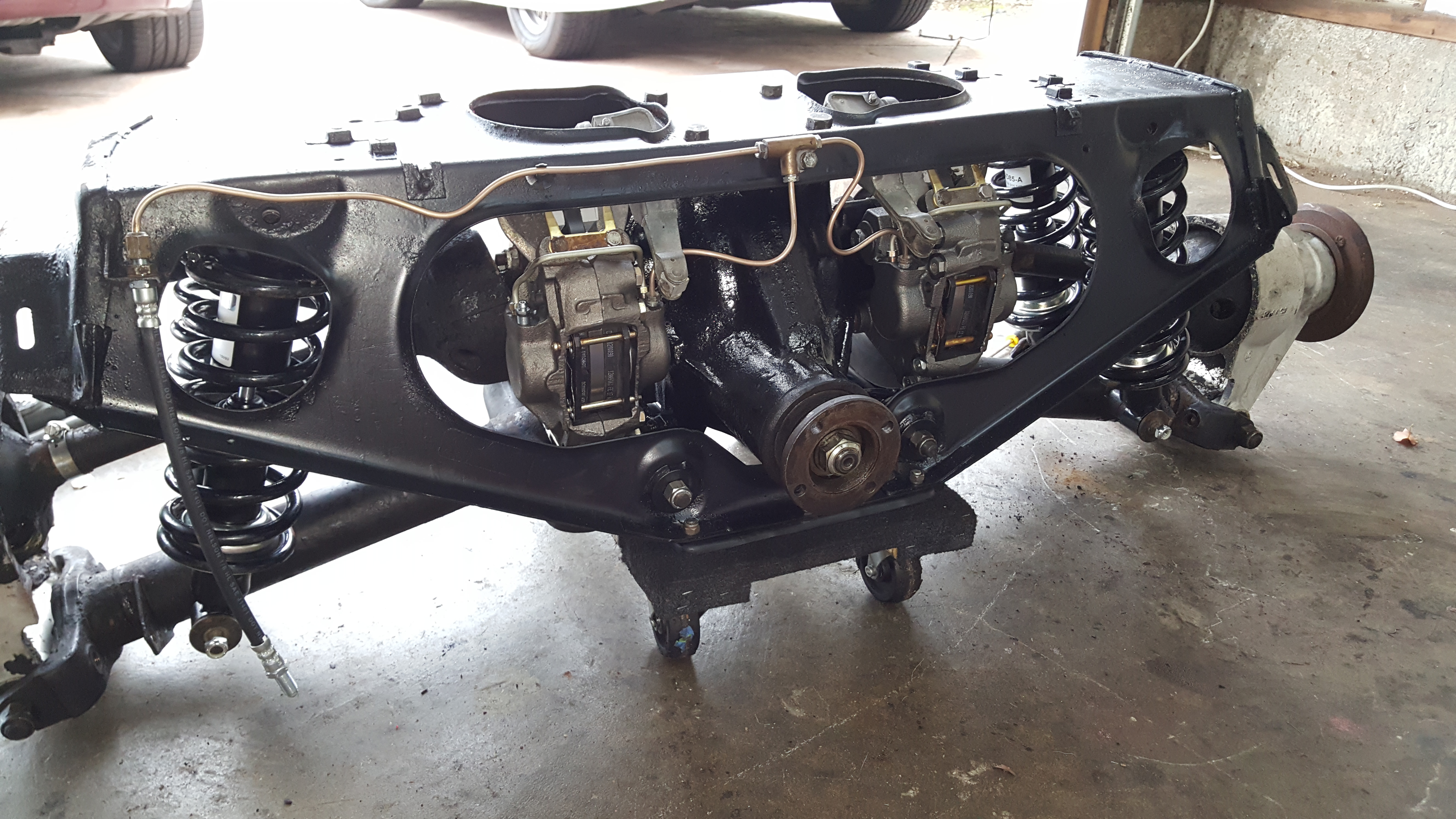

Rear Cage back in :
Not concourse by any means, but not bad for a pair of amateurs !
Brakes --> Check
E Brake --> Check
Ride Height --> Check
Damping --> (with Boge shocks) Seems a little bit harder than the weak stuff we took off. Will run it for a while to let it bed in and reassess
